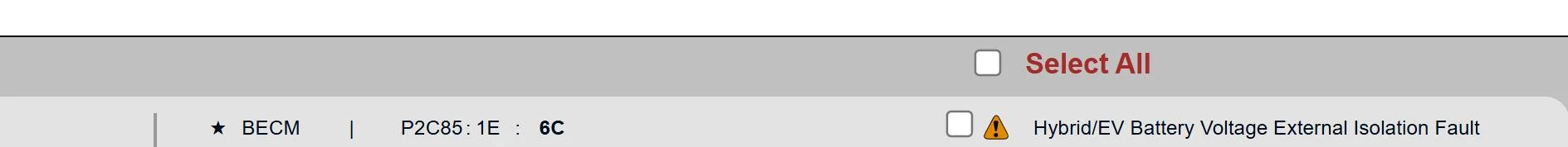

Dealer has diagnosed it as a bad BECM. Good news is it is fully covered by warranty.
sotek2345
sotek2345
Jun 7, 2021
3,805
4,566
Upstate NY
Engineering Manager
Alas - They replaced the BECM module, but that didn't fix the issue. Now they say it is a "fuse" in the high voltage battery - negative terminal - I read that as the HVBJB (maybe I am wrong), but I don't have an updated timeline yet.
