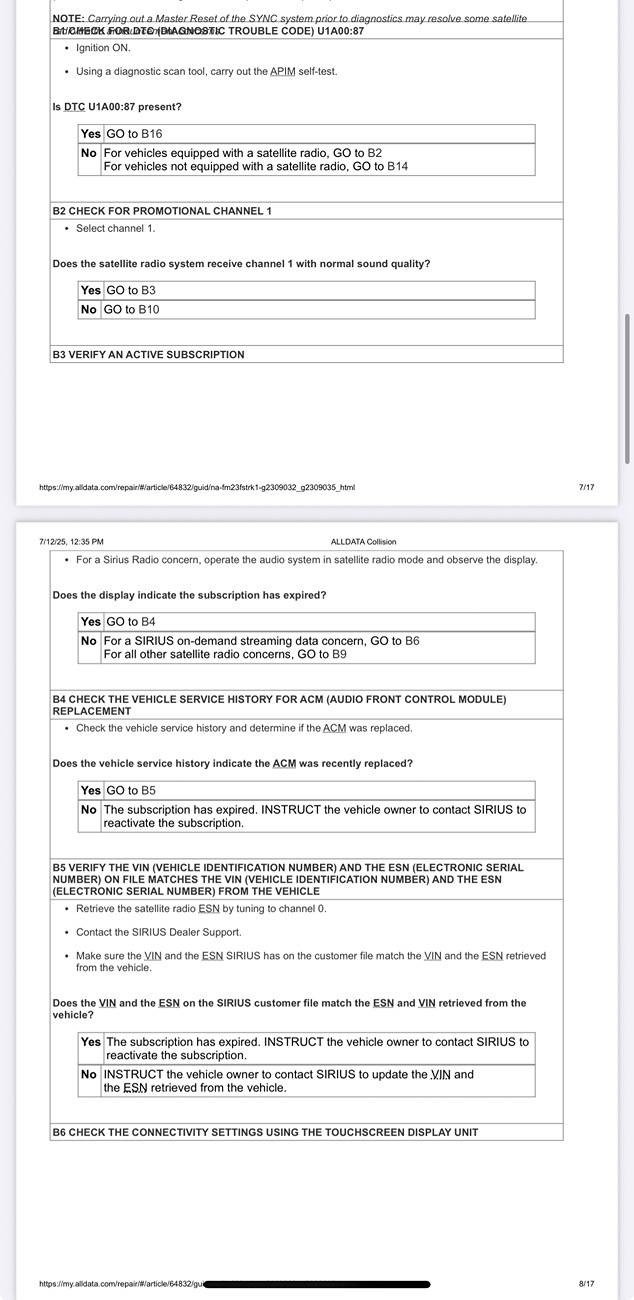

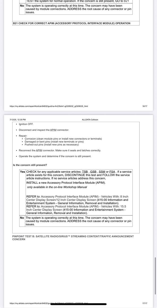

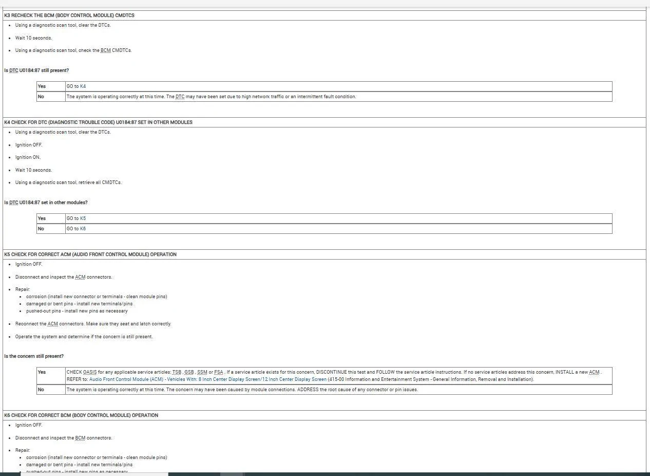

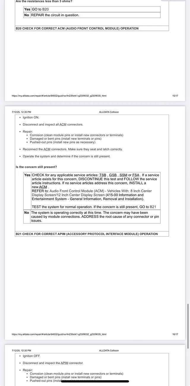

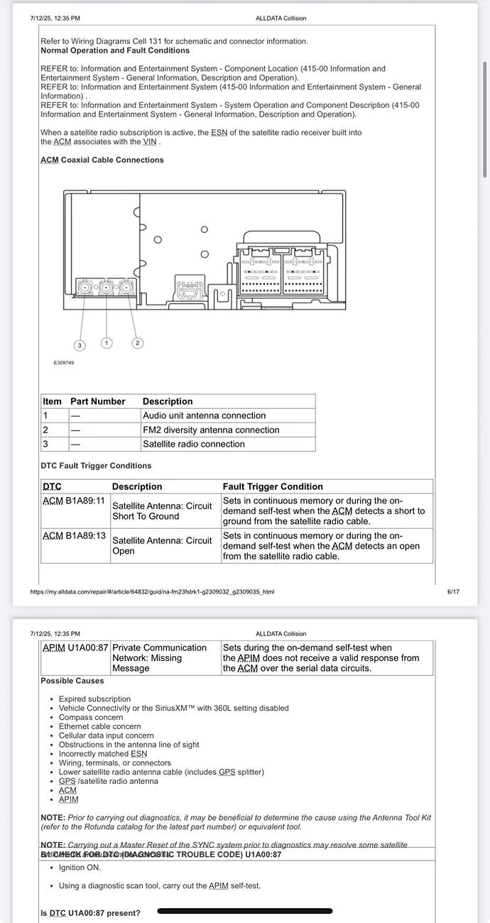

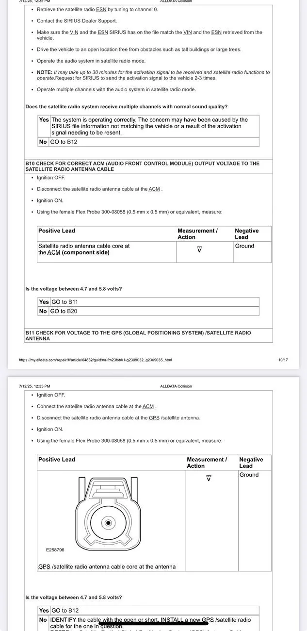

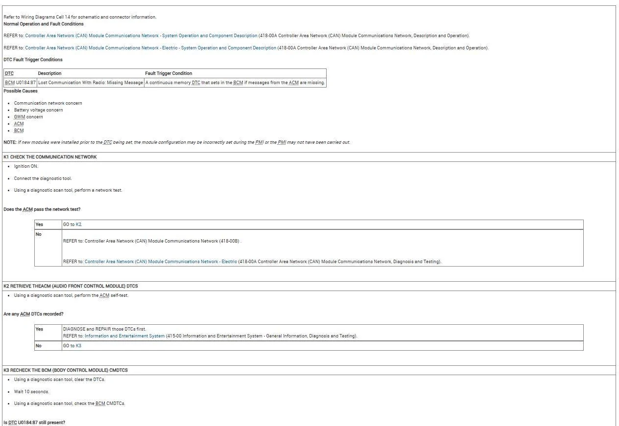

Got your message, but I'll post the response here for the sake of the info being out there. It does not seem like your issue will be fixed by a simple reset; not sure.....maybe @Jesse-Infotainment can chime in. The truck is reporting these codes relevant to your issue:
Hard to say if the DSP itself took a crap or if the APIM is the issue, but seems like the APIM itself has an issue.
I can check the DTCs when I get home on AllData. Is this from FDRS?

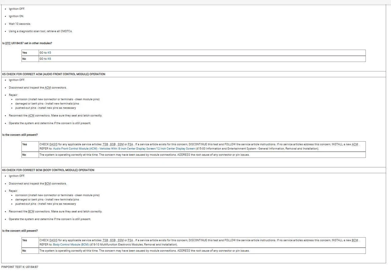

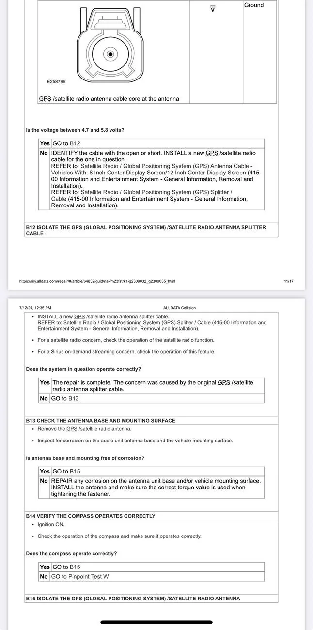

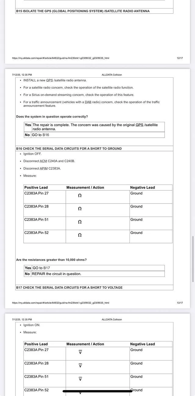

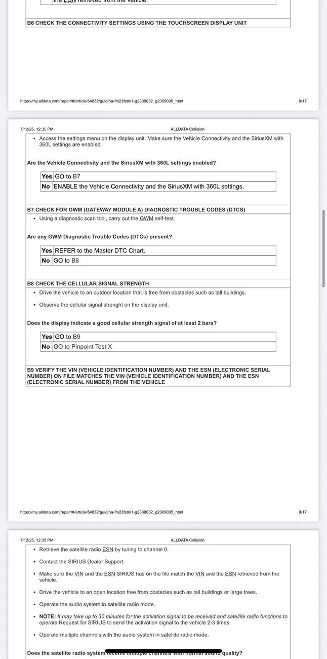

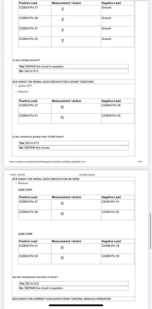

Hopefully this helps. Will also upload as a PDF.
Edit: NVM, for some reason it’s not letting me upload the 2 PDFs.
