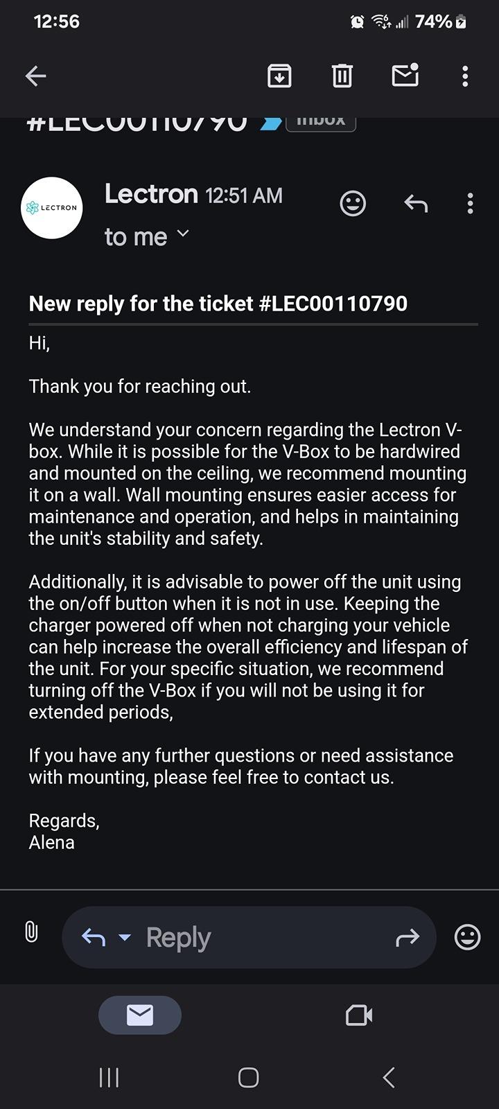

So it seems it should be OK. For ceiling mount. And if not using for extended periods to shut it of. Did I miss something?
I missed that you're using the Lectron EVSE with convenient on/off switching, there's that illustrious tunnel vision and unfamiliarity with other products biting my ass again.
While many of us don't have a switch, but I do have an emergency cut-off switch right next to my FCSP, I just flipped it off this morning and will turn it back on next Saturday evening for the weekly charge.
Just turned it off this morning. Stood on the running board and I can reach it. I didn't understand Lectron saying " wall mount for ease of service " not much to service. Temp gage on the V box was showing 126° F during charging last night. It is hot outside 98° ,truck was run pretty hard too. From what I understand that Internal temp is normal up to 165°
I hardwired it off of my 100amp service panel in the garage to a 60amp breaker using 4awg wire. Nothing out of the ordinary as far as over Temps go. Short run of 22 feet. Seems good to me .
Keeping it off during lightning storms (of if one has an unstable power supply) might be another reason to be able to switch a unit off easily when not needed. @Ford Motor Company would be wise to advise customers of the various hazards of powering electric vehicles, using good, if not superior equipment. Bet they could make a buck recommending "Ford Certified" components (kickbacks from those companies).
Definitely good advise. ??
