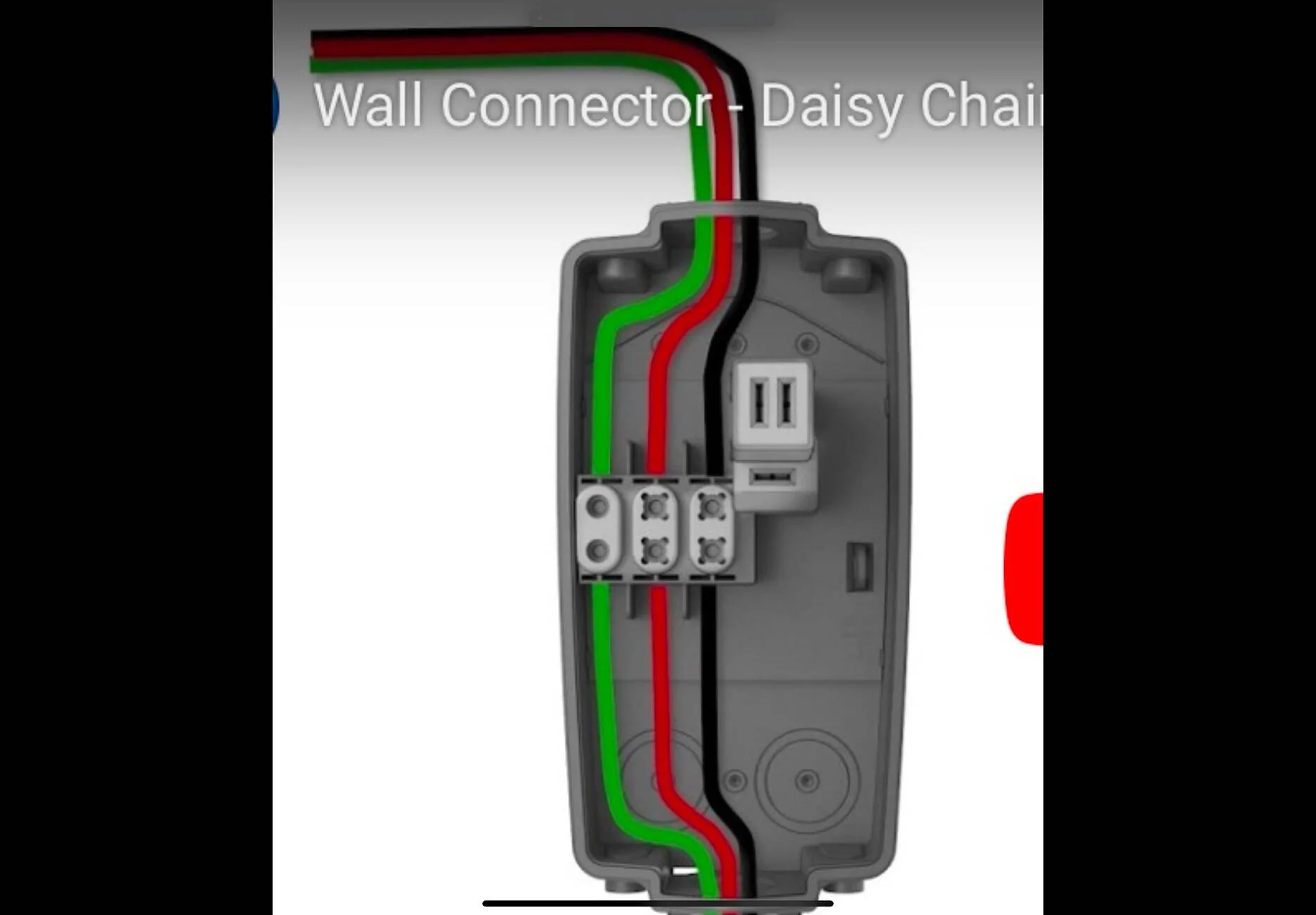

I had 2 wall connectors daisy chained and power shared in my garage. It worked great since there was no musical chairs plugging and unplugging 2 vehicles. I always left 2 EVs plugging in all the time. We had 2 Tesla's and a Lightning. I sold one of the Tesla's last week and we "only" have 1 Tesla and 1 Lightning now.
Two months ago we bought another house but we are still living at the original house until the renovation is complete on the newly purchased house.
At the beginning of the renovation of the new house I had a 125 amp sub panel installed in the garage to accommodate more circuits. I removed one Wall Connector from the existing house and installed it at the new house along with another Universal Wall Connector so I have 2 separate 60 amp Connectors on separate circuits, each set up to output 48 amps. Even though they are on separate 60 amp circuits I'm seriously considering power sharing them since the load calculation is high with the 5 ton AC, Electric Water Heater, Electric stove, 2 well pumps, 70 amp sub panel in the barn, 2-30a/120 RV outlets and everything else on a 200 amp service.
In the existing house where we are still staying, I now only have 1 Wall Connector. I can't believe how having only one EVSE is a pain to charge 2 EV's. First world problem.
House with daisy chained EVSE before removing one.
