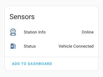

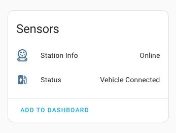

After seeing @ericpullen's excellent work on pulling data from the Ford Charge Station Pro, I've spent a few days trying to a) teach myself how to write a Home Assistant Integration and b) how to bring that into reality and publish it on GitHub as a HACS compatible thing.
I give you "Ford Charge Station Pro Local" which I'm shortening to local_fcsp in Home Assistant.
I'm sure it's buggy as ALL HECK, and please be kind to me ;)
You can see the GitHub here.
Ford F-150 Lightning Home Assistant local integration for Ford Charge Station Pro (Passive ONLY) Screenshot 2025-07-01 at 1.28.27 PM
Ford F-150 Lightning Home Assistant local integration for Ford Charge Station Pro (Passive ONLY) Screenshot 2025-07-01 at 1.28.34 PM
The integration pulls in data from Eric's library, then makes it more human readable. There's logic in the integration to determine if the vehicle is connected, charging, or powering the home. There's also logic to determine if the vehicle is preparing to power home.
Right now, it's only passive, but if we can figure out how to send current change limits to the station in the same way that Eric's figured out how to poll data, we're in business ;).

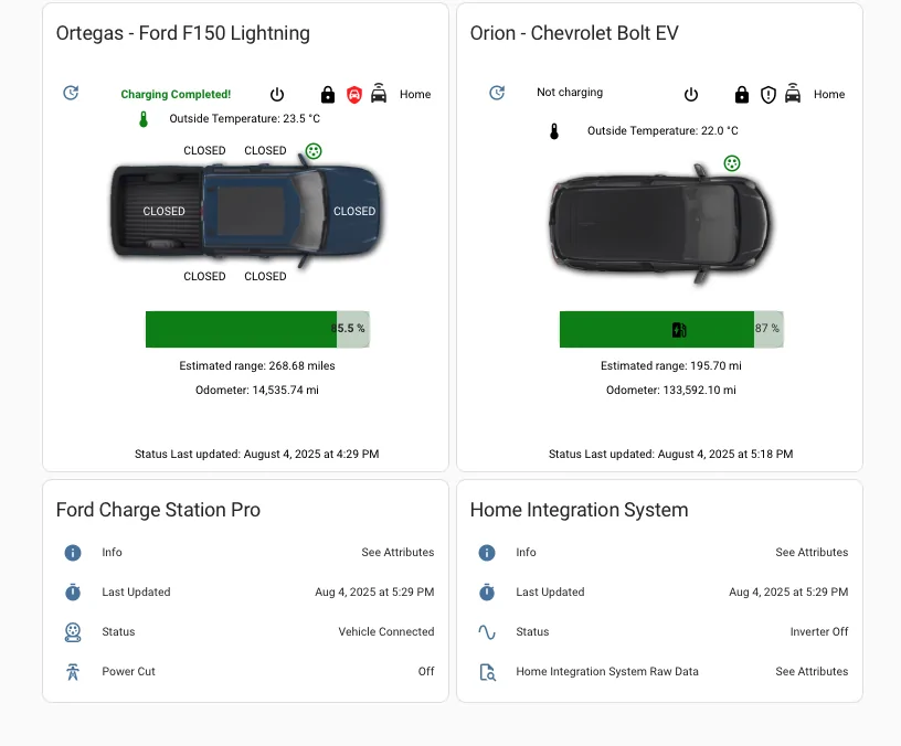

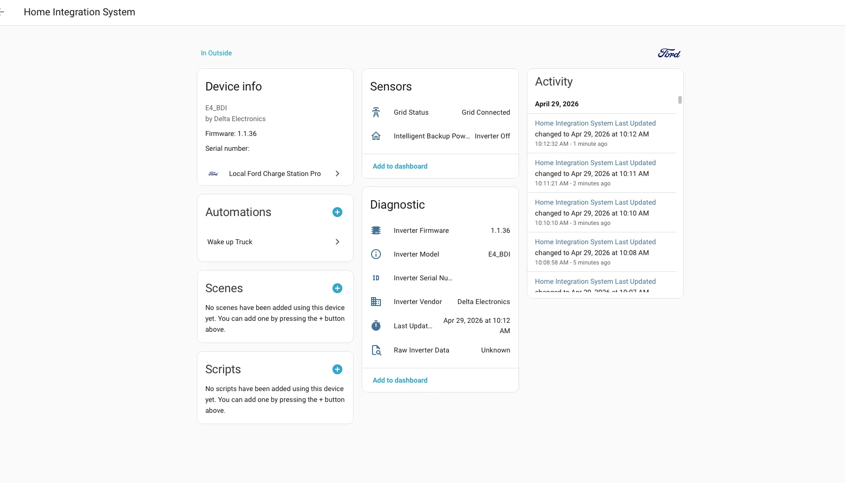

Just published v.0.3.0 of this - and I've made some changes to the Power Cut sensor.
I've got it arranged in my dashboard as two cards, but obviously within HA, the world's your oyster.
Ford F-150 Lightning Home Assistant local integration for Ford Charge Station Pro (Passive ONLY) Screenshot 2025-08-04 at 5.30.37 PM

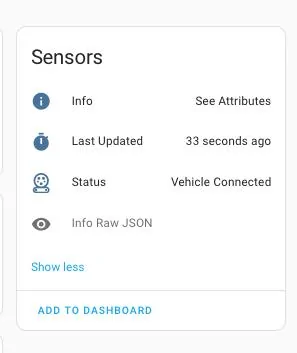

After our FCSP died and a new replacement unit was sent out, I realized that the earlier software for the fcsp has a different status state set, so the new version takes this into account. This is important because if you have the integration and have to get your fscp replaced, the replacement unit may be running OLD software until it gets its OTA update. (it's just taken two days for mine to get up to current system parity).

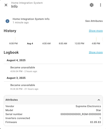

Also went one step further and cleaned up the version reporting for the Home Integration System, so that now we see a standard V x.x.xx system reported by the inverter. In mine right now, the system is reporting Inverter software 1.1.36
Ford F-150 Lightning Home Assistant local integration for Ford Charge Station Pro (Passive ONLY) Screenshot 2025-08-04 at 5.35.33 PM

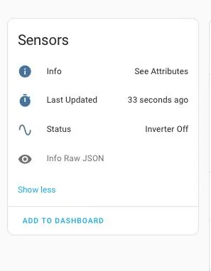

Now to the bad bits. There's what appears to be dummy information populating into a Fcsp which hasn't been connected to a home integration system that fools my integration into thinking there's an inverter attached.
Ford F-150 Lightning Home Assistant local integration for Ford Charge Station Pro (Passive ONLY) Screenshot 2025-08-04 at 5.36.51 PM
Ford F-150 Lightning Home Assistant local integration for Ford Charge Station Pro (Passive ONLY) Screenshot 2025-08-04 at 5.37.14 PM
I don't know if @ericpullen has seen this kind of behavior before, but I *think* the best way forward is to write a function that looks for the 'dummy' data (including the vendor and model) and then determining that the HIS isn't attached.
