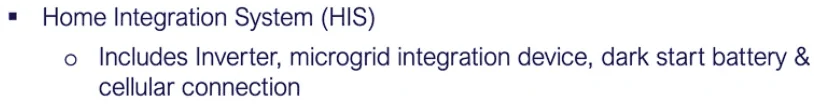

My current guesstimate is that the inverter being referenced is in regard to for this system is simply a small inverter that performs a grid-forming (voltage-forming) output for the truck to feed AC into. This would be a smallish-inverter dedicated to the "dark start battery" now being referenced to come with the HIS.

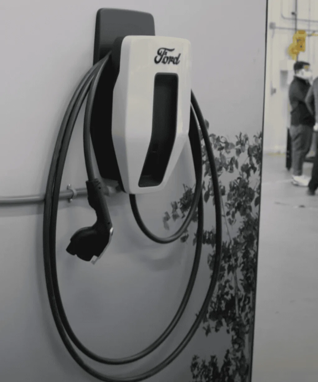

One other piece of potentially supporting evidence here is that a retention slot can be seen in the center of the image with a CCS connector that has been produced (I have never seen the video by Car and Driver this is said to be clipped from). Clearly the end was not placed back in that opening which in this environment surprises me and suggests the CCS end on this cable might not actually fit into the opening. Again, there has been no other indication the end will be CCS other than this photo apparently obtained during a Car and Driver journalist visit.

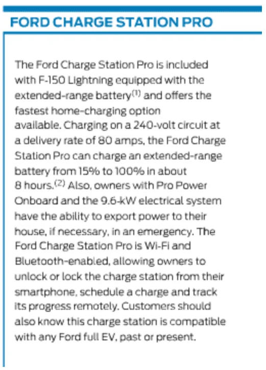

Suggests 9.6kW inverter of Pro Power Onboard system exports power to house with the Ford Charge Station Pro:

Another forum is reporting that SR Lightnings that want to use intelligent home back-up system WILL have to have upgrade of pro power onboard system to the optional 9.6kW max output. This goes against what I have previously said on this forum, I guess I will eat those words though I am always suspicious of what auto show staff do and don't know and the "translation" that comes with what they said. But if true, I can only think this suggests that the vehicle would be doing the DC to AC conversion. I am shocked nobody can get to the bottom of the electrical system of this vehicle in late January 2022, with ordering already having begun. I feel sorry for any SR purchasers who don't upgrade to the 9.6kW pro power onboard system and get screwed by this if they end up wanting intelligent home back-up (if report is accurate).

"...Another forum is reporting that SR Lightnings that want to use intelligent home back-up system WILL have to have upgrade of pro power onboard system to the optional 9.6kW max output..."
this is correct. Ford is using the full 9.6Kw power available from the battery pack. Without that, the maximum power output would be 2.4Kw, which is only 10amps at 240 volts - very little for any home to make use of.
Now, does that mean that ANY of these trucks, whether Pro Power Onboard or not, could not still power your home, even WITHOUT any tie-in to your home's power panel? Of course not - this is a large 'generator', whether it has the pro power or not - you can still use the outlets that are available in the case of the home's power loss. For those who 'want' to spend money trying to create the 'ultimate' power system to tie-in automatically with their home can certainly do that, but it doesn't mean that the rest of us are not able to, we just have to in a different way.
