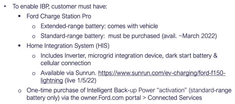

So far the premise of this thread is pretty spot on. Based on info revealed today 1/3/2022:
- Ford has indeed off-loaded the automatic back-up system hardware to Sunrun. Wow.
- Sunrun will take 80A EVSE orders for SR battery customers "~March 2022". So indeed no ordering at time of vehicle order for many.
- First wave orders open 1/6/2022. I still don't know if the 80A EVSE will have a connector physically compatible with my Nissan Leaf (non combo charge system). Sunrun is to have a website that goes live 1/5 - who knows if any real detail will be included.
On top of that is the additional bad news:
- The integration package requires a cellular connection, which means Sunrun can make sure you maintain a grid connection. Want to power that remote cabin with the truck and some solar? Tough luck. Want to charge the truck solar-only? Not a chance. Don't want system to become a brick as soon as selected cellular technology is dropped by cell provider? Cellular upgrades not available! This is a BS power grab Ford just handed to Sunrun.
- An additional "activation" has to be purchased if you actually want an SR battery to work with automatic backup system.
- The truck will indeed require an external inverter even though 9.6kW of inverter hardware is already built in to the truck. Oh, and a black start battery has to be purchased and maintained instead of using the truck's battery as well.
I'll hold off on full judgment but this feature is looking less and less elegant the more I learn.

@adoublee Where did you see they offloaded to Sunrun and that Sunrun is to have a website live at 1/5? Also, where is the info about an additional activation for the SR battery? This feature is essentially the only reason I reserved a Lightning and I'm trying to find more info on this. This is all a bit annoying for not having everything thought out, but honestly, I'm not surprised. It's not like a car company will care much about energy solutions. Large companies just are not ready logistically to cross industries.
I also have other EVs in the household and the connector uncertainty is a headache. Although I never expected to use the 80A EVSE solely, I was planning to keep my Chargepoint and add the Ford 80A.
Thanks for your update.
It is in the Dealer Play online thing: https://www.f150gen14.com/forum/att...order-bank-opening-playbook-1-3-22-pdf.35157/
There is a section about procedure for getting the 80A EVSE from Sunrun, and another for getting home back-up from Sunrun.

It does seem to mention that it is a one-time-activation. So it doesn’t sound like a constant cell connection is required.
Though, if it is, that would *SUCK*. It is one of the things I hate about the Tesla Powerwall, and why I can’t get them. If the internet goes down, so does the battery backup. Our internet usually goes out in tandem with the power failures. So it makes the Powerwall useless.
I don't believe this activation cost is related to the cellular - it is just to make the SR battery functional with the also separately purchased Ford Charge Station Pro and Home Integration System.
Ford F-150 Lightning Home Back-Up and 80A EVSE Missing at Launch 1641326628874
I don't know exactly how the cellular connection will be used - in "theory" it could just be for monitoring your system. However, it is part of the "customer must have" section. It is very possible it does not immediately take down back-up if cellular signal is lost (that is just idiotic if you ask me), but it could still be used to lock down use of the system in one way or another. For example, Enphase recently came out with their IQ8 solar microinverter that can provide back-up power without battery support, be they will also not allow it to be used off-grid and use a required cellular connection to make sure there is a grid source installed through their own MID.
