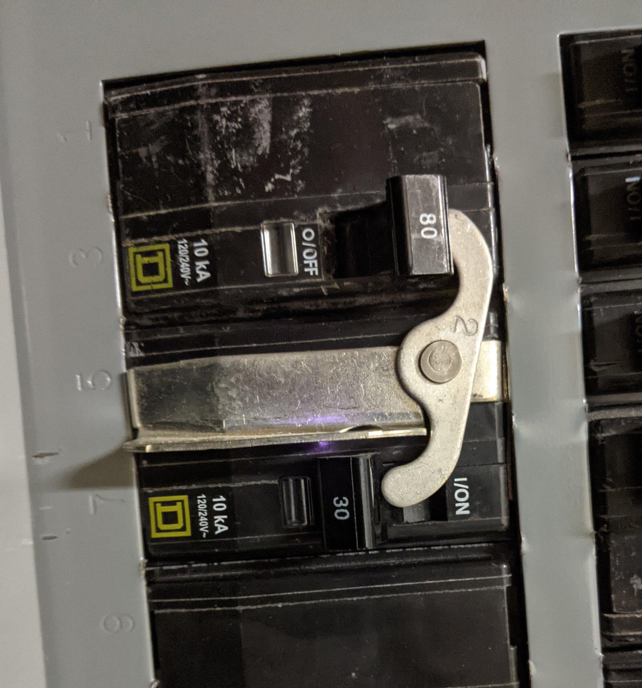

It’s not illegal if you have a breaker interlock. You basically have two, 100A breakers feeding your panel. They are interlocked such that only one can be on at a time.
He can't feed his charger if the interlock is in place...

Breaker interlocks like the one pictured are NEC-compliant. As long as the setup is UL listed by the manufacturer,it’s fine.
What you can’t do is cobble up something home grown, or intermingle components from different manufacturers.
Correct - that’s also true if you used a transfer switch. What we‘re missing is exactly how the Ford equipment functions. It will likely require a separate AC circuit for EVSE power and backup power. The circuit for backup power won’t need to be nearly as large as EVSE power. All we can do at this point is speculate until more technical data is made available.
