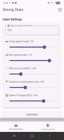

1. Driving Stats Tab
This tab takes several inputs:
  • Battery size
  • Likely speed
  • An alternate (faster) speed
  • An estimate of your mi/kWh (sorry, Canadians — wrong units!)
  • Distance to destination
  • Current SOC

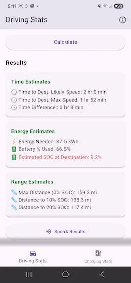

The outputs are grouped into three categories:
  • Time Estimates
    Helps answer how long the trip will take and whether driving faster actually saves you much time.
  • Energy Estimates
    Shows kWh used, battery percentage consumed, and estimated SOC at your destination.
  • Range Estimates
    Displays distance to empty, distance to a 10% buffer, and distance to a 20% buffer — for all you range-anxiety-prone drivers.
There’s even a button that reads the results out loud so you don’t need to stare at the screen.

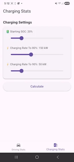

2. Charging Stats Tab
This one takes just three inputs:
  • Starting SOC
  • Charging rate up to 80%
  • Charging rate from 80% to 90% (when it usually drops off a cliff)
I don’t usually charge beyond 90%, so I didn’t build in functionality for that.
Yes, I know the charge rate up to 80% is on a curve and changes constantly depending on the charger and many other factors — I just adjust the slider as the rate changes and recalculate.

  • Time Estimates
    How long it takes to get to 80% SOC, and then to 90%.
  • Energy Stats
    Total kWh added during the charge.
  • Charging Speeds
    kWh per minute added, and how many minutes it takes to add 1% SOC.
