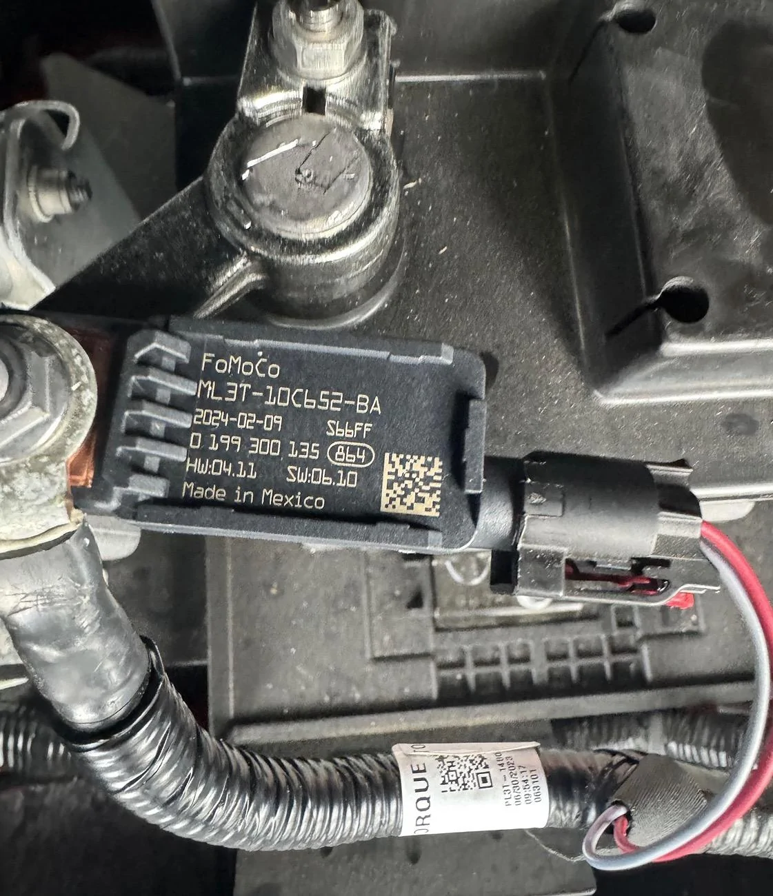

Tell them to read the CSP again. It's a 5 min job that takes less than 1 min to determine. They open the frunk, pop open the battery compartment, and read the part number on the sensor. If it matches the CSP, they unbolt it and bolt on the new one. That's it. 5 days....good grief what a terrible service center. Do you have alternative locations to take it?

Someone on Reddit posted a photo of the sensor they just had replaced.
Looks like the newest version, dated 2/09/2024.
