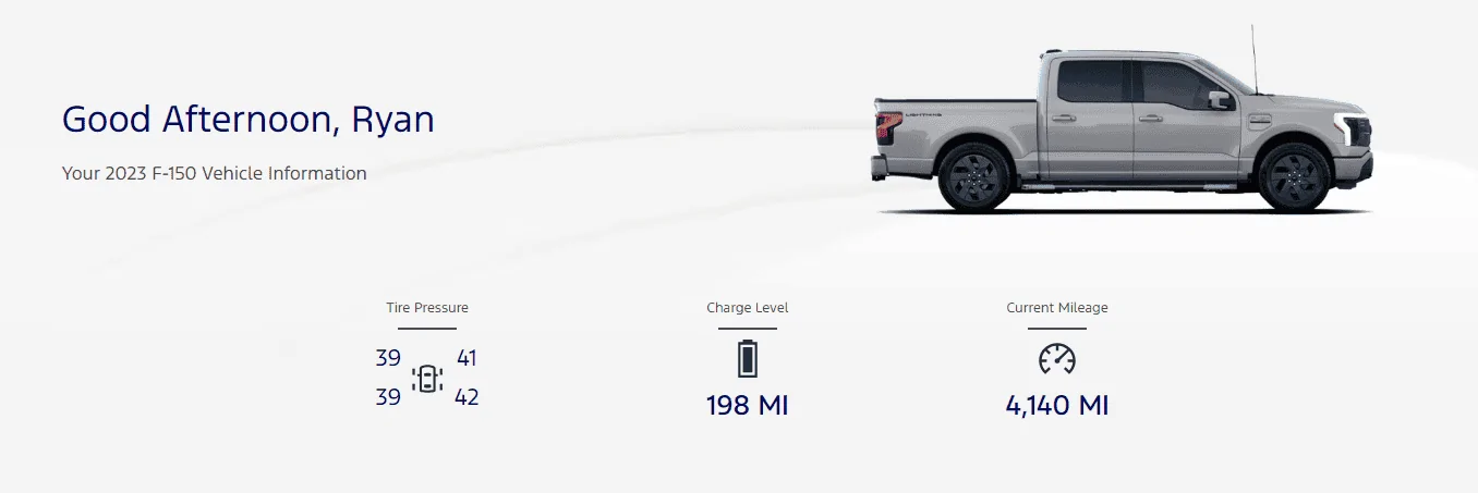

The mislabeled square reads "charge level" in the center. That isn't your HVB, but your LVB
My "Charge Level" is indicated in milage. This is my first time seeing this online dashboard so maybe I need to change something? Zero update since purchase in Nov. 2023, so it hasn't been that long and I did receive the letter for the 12v charge indicator replacement.

While logged in, goto your account status via this link to see the "Charge Level" aka 12v SOC
https://www.ford.com/myaccount/?gnav=header-account

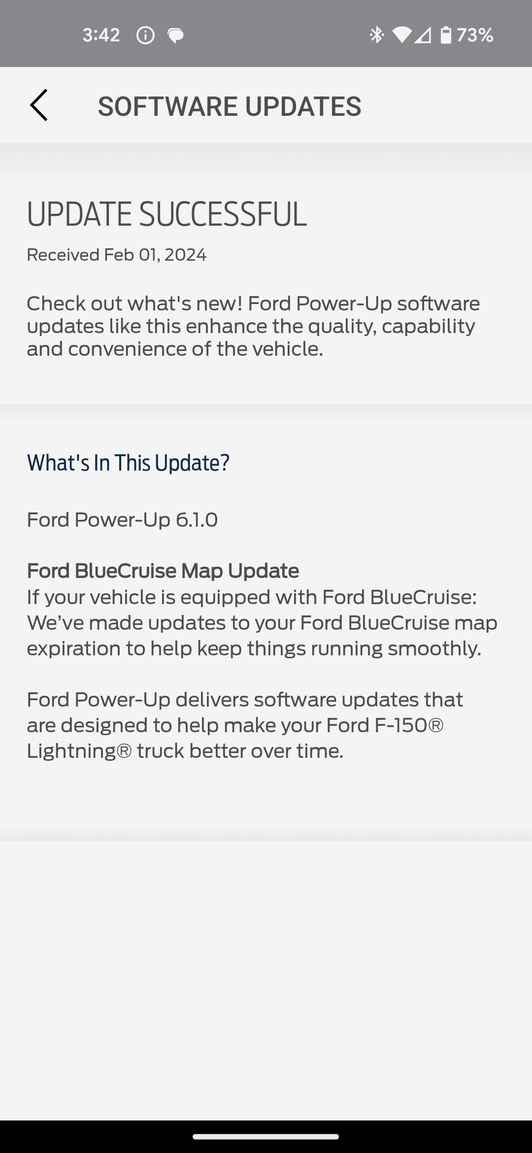

Your truck has not recorded any updates. It is on Sync 22326 which is the same software it left the factory with when it was built in June 2023.

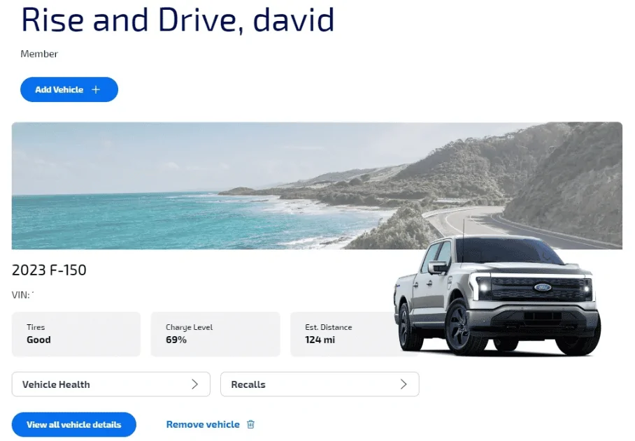

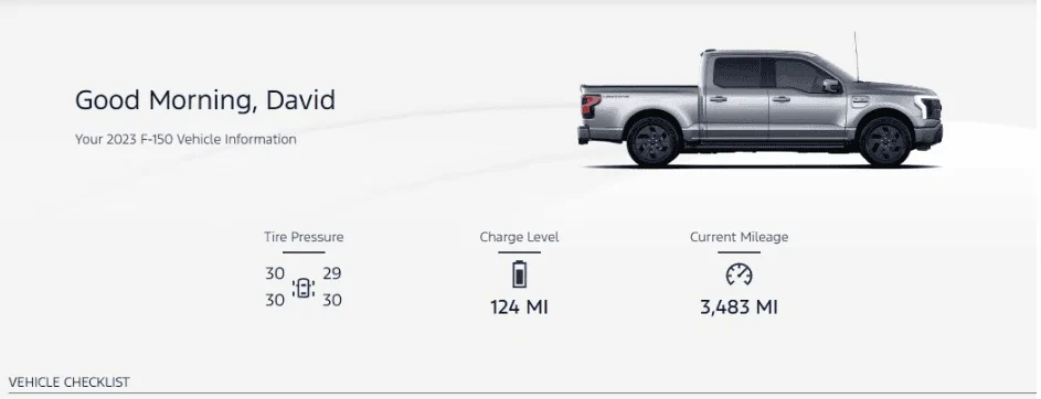

a mislabeled square. Huh. so after reviewing this thread I see why I'm confused and suspect many others are too. I loginto my ford.com dashboard a couple times a week at most. I go to ford.com and then from the pulldown menu select vehicle dashboard. and I see this:
Ford F-150 Lightning I just got an update... 1706828619228
as you can see the center icon says charge level but the GOM miles appear. makes since to me. but someone in this thread had a link to the dashboard . for some reason I clicked on it and I get an entirely different look.
Ford F-150 Lightning I just got an update... 1706828662302
as you can see both screens are using the same information, or so it seems until you look at the data presented under "charge level" on the screen I have been using for 4 months it gives the GOM mileage. but on the other it shows a percentage. another software glitch from Ford IT. but thanks to this thread I have learned something.

We could call it a "Glitch" or poor designed tab label, by inference, of seeing the mileage one assumes the same pixel location with different label is the HVB SOC for those miles, unfortunately it's not, it is the LVB SOC.
BTW,
Log onto Ford.com, then pick first item on the list [[Your first name ['s]] Account], this is how to get to the erroneous/poorly labeled data page.
