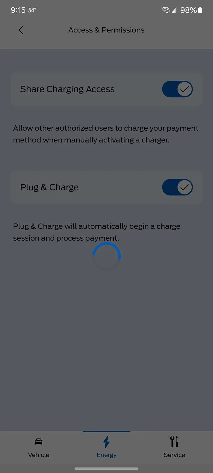

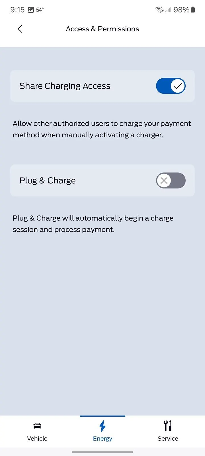

Edit: The solution was to cancel Blue Oval Charging Network and reactive it.
I turned off Plug and Charge by mistake a couple weeks ago while exploring the new FirdPass app layout. Since then I haven't been able to turn it back on. The slider moves from off to on, the screen dims with a loading wheel for a second then the slider moves back to off.
I verified Blue Oval Charge Network was active on Ford.com and there is a valid credit card on file. My phone is a Samsung Galaxy S21, and the FordPass app version is 5.0.2.
I haven't used DC charging since my home charger was installed but we are camping at the end of the month and I may need to. I'd like Plug and Charge to work if possible.

1) Reboot phone and try again.
If that doesn't work,
2) Delete app, reboot phone, reinstall app, and try again.
3) Delete cache, delete app, reboot phone, reinstall app, and try again. You may need to redo PaaK.
I tried to shut plug and charge off and just get the rotating blue semicircle. I switched screens and plug and charge still on when I switched back Sorry, no help here.
Might be a transient bug in Ford Pass.

Nothing worked.
