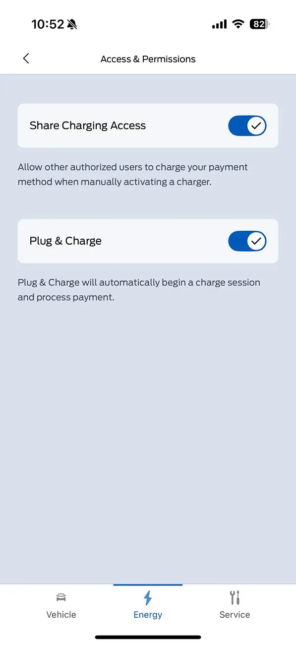

Point being, if he could disable Plug and Charge there would be no way for Tesla TO bill him. But they did, so this has to be a Plug and Charge failure.
I got you all the way to the last part of the last sentence. It isn't a Plug & Charge failure, it's a failure to turn off Plug & Charge when the app says it is off. I suspect it's really ON. That's why I asked Ford to turn it off.

Force Stop and clearing data cache does nothing, I did not clear credentials as I don't want to eff around with reconfiguring PAAK.
There appears to be issues with FP 5.10.0
They appear to have activated our P&C to active in the database, but that condition doesn't show on my and several members Fordpass' where it was previously switched off, it's stuck off.
