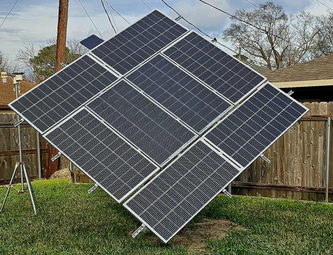

Yeah agreed on the manufacturers including it, it would be awesome if every surface was capable of harvesting energy, I bet with the footprint of the truck the energy produced would be double or triple my setup.
I doubt it. This array is 1600W @ 150v and my best pull was 11kWh, yes that's a tracker that follows the sun and a standard 6' privacy fence for size comparison.
