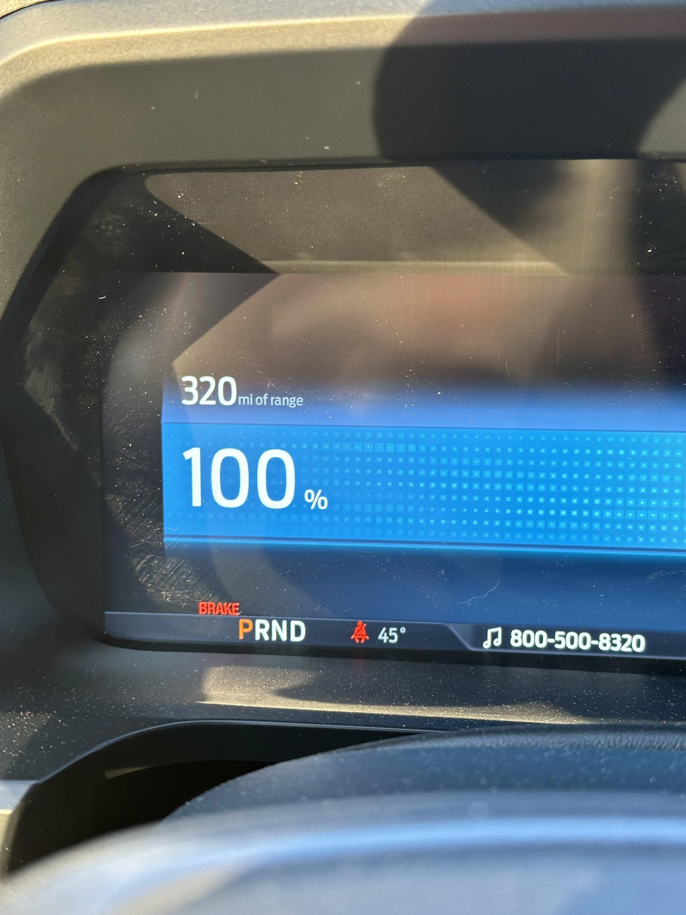

Added to spreadsheet (see my signature) for Power Malfunction / Reduced Power problems. Did that notification also show on FordPass or on your screens?
ZeroEmapthy
May 2, 2023
2022 Lightning Lariat
I can't find any notifications on FordPass, the only thing that happens when the power gets reduced is, my charge bar turns yellow (like it does when you are low on battery) and the top half of my powerbar gets hashed out. When it happens again I will try to get a picture of it.

Update from Ford, need a new battery and a high voltage harness. They will be installing it on the 25th of this month. They didn't explain exactly what the issue is, but a couple days after this post I got a call from them, and they told me "A concerning issue is arising on my truck and I need to have it serviced immediately."
After some back and forth with them, the lady on the phone told me that according to the data they are seeing on the truck, it will need a new battery, and a replacement of the high voltage harness. All of it will be covered by Ford, which is nice, but having to drop my truck off on my birthday (for at least a week) is not so nice.
The new thing the truck does now is, limit my total motor power to 50% at random, (started the day I posted). Ford assures me that the truck will operate, but might be "slightly power limited," until my drop off day.
People can say what they want about vehicles with wifi connections, and quality issues and what have you, but this is one of the nicest experiences with a vehicle issue I have ever had the disposition of having to deal with. From the time I noticed something was different, to the time Ford called me about the issues was about a month. I am sure as time goes on, and Fords systems improve, they might actually be contacting people before they even realize something is wrong, and thats pretty cool in my book.
Thanks for the help and suggestions guys, but I know vehicles, when something is off, I am usually pretty quick to spot it. To those talking about temps and driving style, my truck had better range when temps were almost 30 degrees colder outside, and I was using more systems (mainly the heater), so driving habits and environment should have favored me in the past 4 weeks, not hindered me. The one thing I wish we had on the dash was an actual readout for how my Kwh of battery we have, instead of a % based bar.

I am VERY interested in your comment about the 50% power limit in your motor. I had this same exact thing happen to me once a couple weeks ago. Outside temp was about 51 degrees, and I've driven in much colder temps with no power limiting so I was concerned there was some kind of issue. Power limit never changed during the whole drive but on the next drive it was back to 100% and the issue hasn't happened again since then. I was going to just chalk it up to a one-time fluke but now I'm not so sure. Should I lodge a complaint with Ford about this even if I can't reproduce it?
