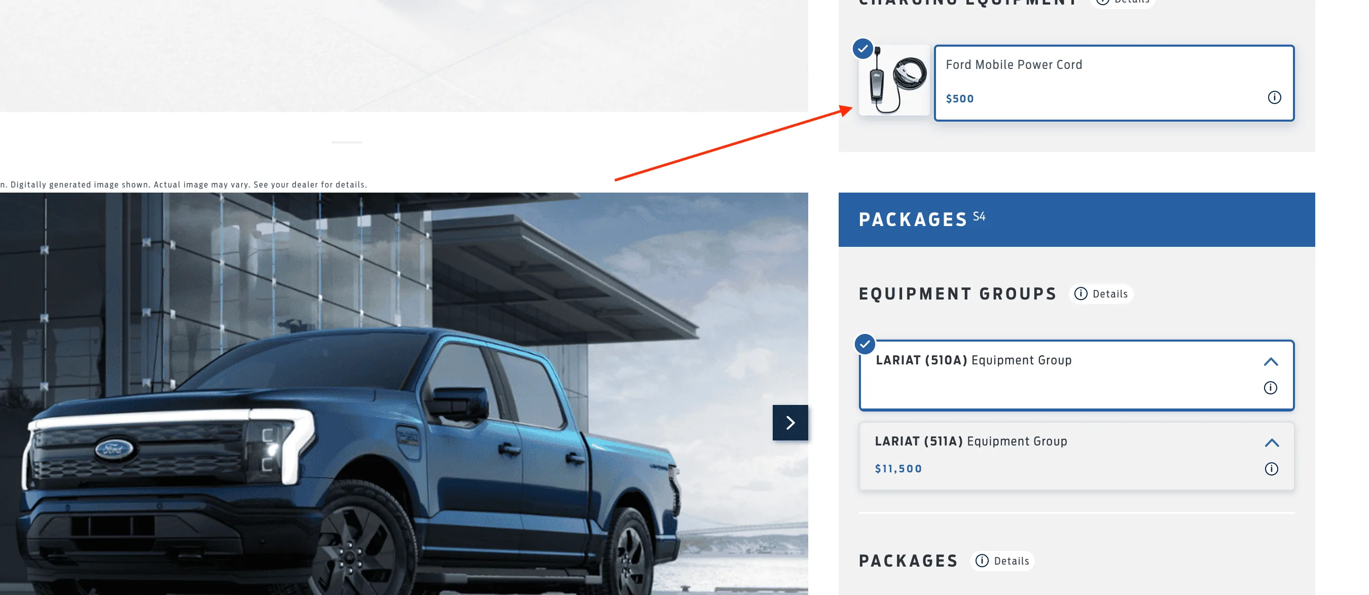

is the mobile power cord worth it for 500$ (selected by default)
Ford F-150 Lightning is the mobile power cord worth it for 500$ (selected by default) 1666380011009

There are cheaper options available, search Amazon for EVSE Level 2 to get some ideas. You can also check YouTube for reviews (highly recommend State of Charge/Tom Moloughney).

yeah I think its not needed or not worth(there are plenty of other options). Sent email to dealer to update my order removing this..
thanks guys just want to get a second opinion

I believe that they started offering an EVSE as an option, so no way to charge it unless you have something already. As mentioned, there are better options for less money. As near as I can tell, the $500 option is 32 amp. The Lightning can charge on Level II up to 80 amps. I would purchase something as powerful as your connection can handle to future proof your charging. I am still using a 32 amp from 10 years ago.

Definitely not worth it. If you need a mobile EVSE, which is probably a good idea to have one in the truck, just buy a better & cheaper one online.

Definitely not worth it. For true mobility the Tesla is hard to beat. For garage mounting many options as others have noted.
