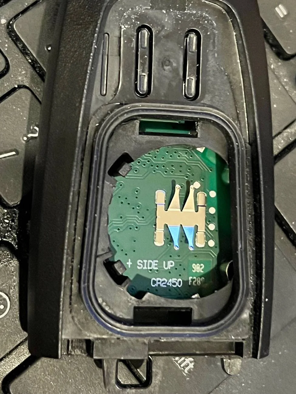

Ford F-150 Lightning Issue programming a new key IMG_8943
This is from my 23 5.0. There is a 902 printed on the board. I don’t have a picture of my 24 Flash circuit board.

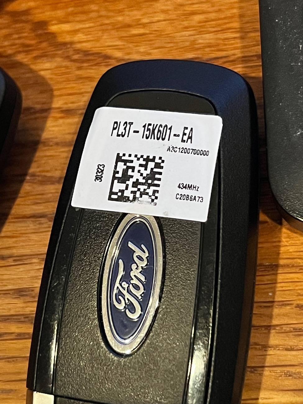

This is the sticker that was on my 24 Flash Key Fob. It says 434 MHz
Ford F-150 Lightning Issue programming a new key IMG_8941

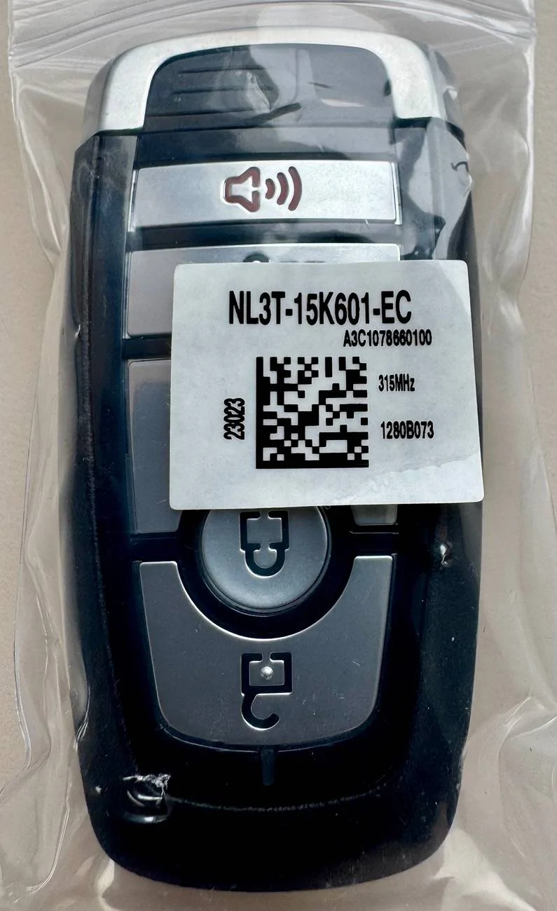

Here is label from the spare fob I got for my 23 Lariat... 315 MHz. Programmed just fine as 3rd fob.
Ford F-150 Lightning Issue programming a new key IMG_3229

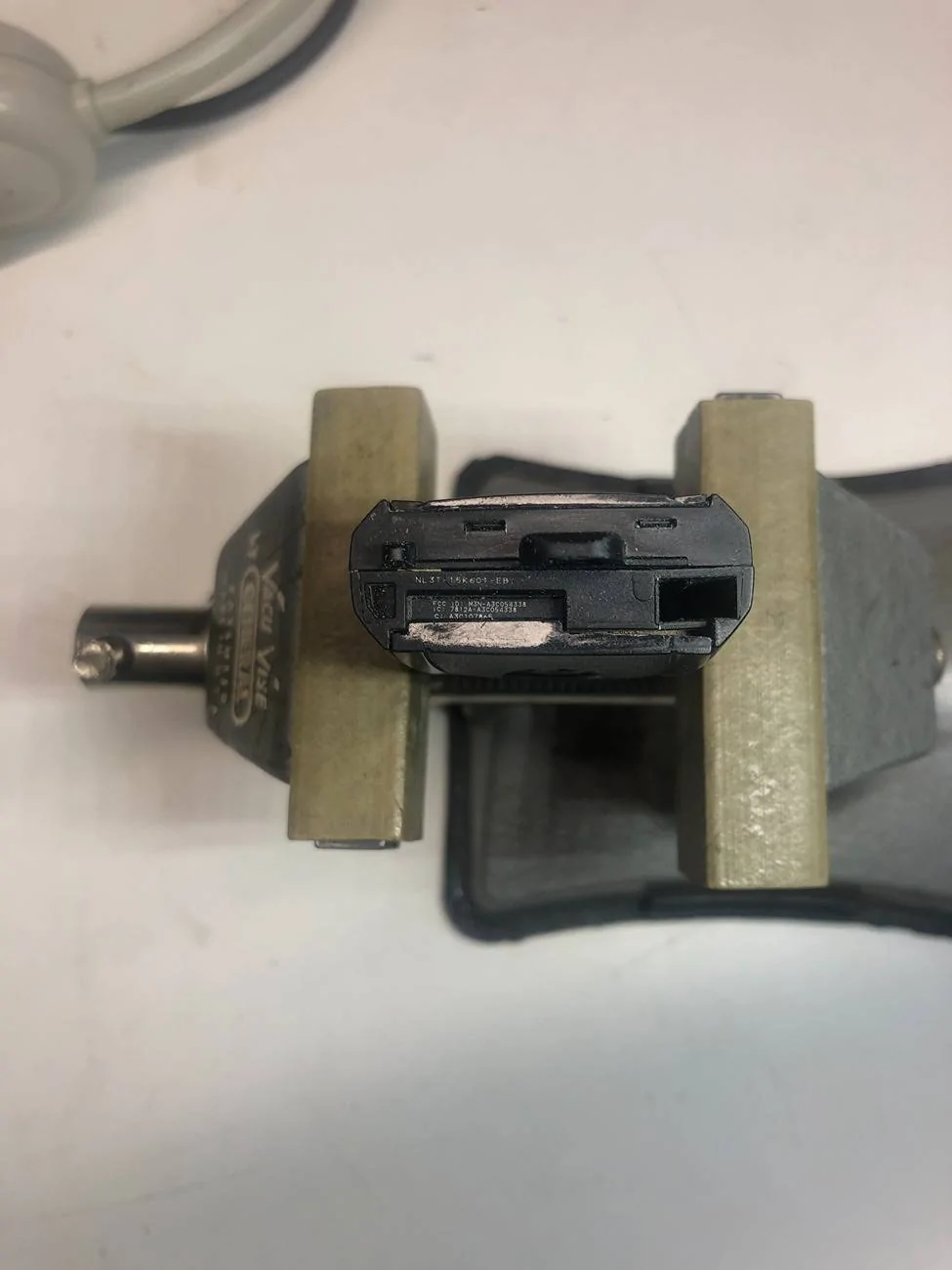

Attached is a photo of the top of a fob with the key removed. If you zoom the image out the part number and the FCC ID number are readable.
On one of my fobs the some of the numbers were obscured. I hope you do not have the same problem.
Steve
Ford F-150 Lightning Issue programming a new key 1739746886130
