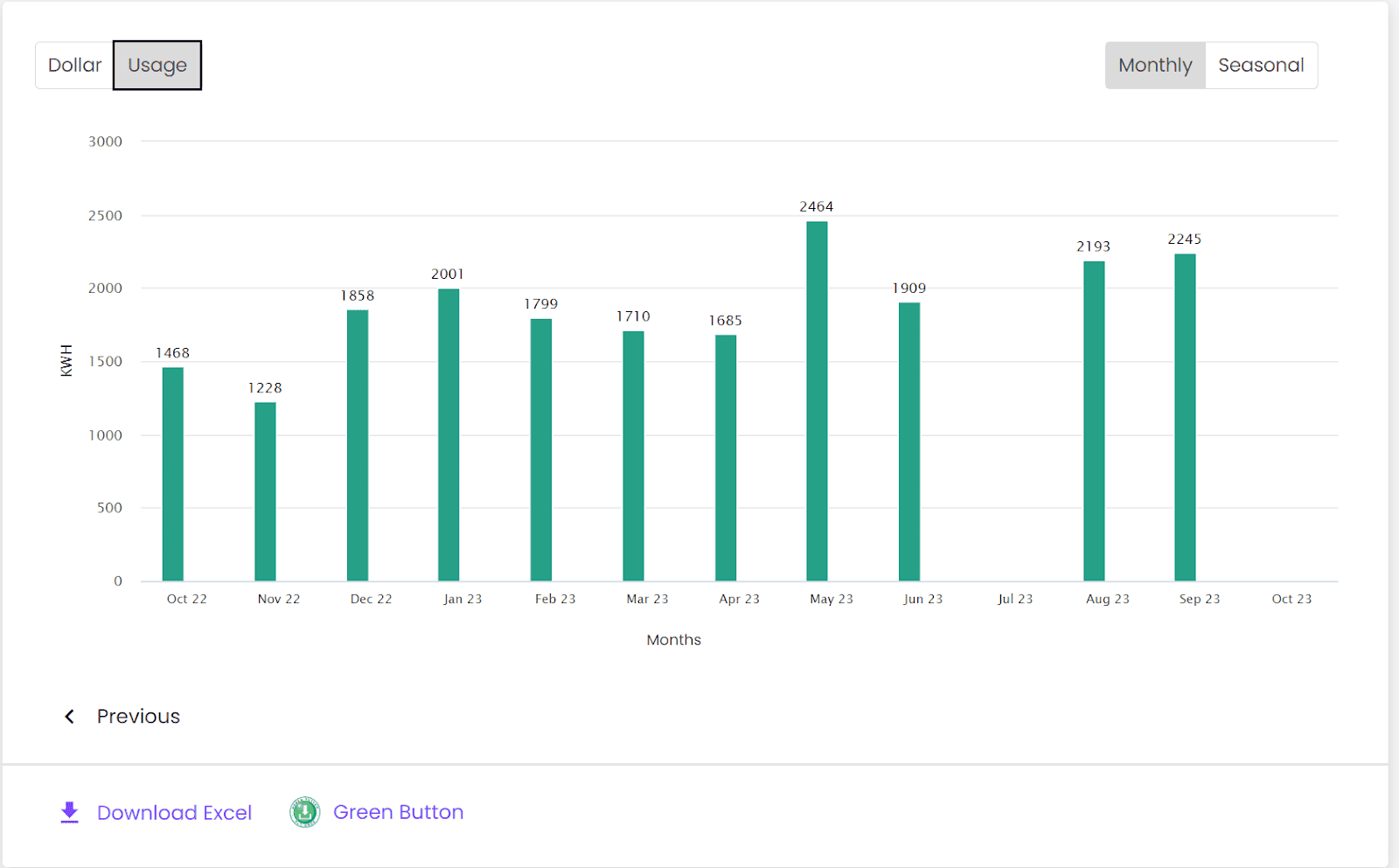

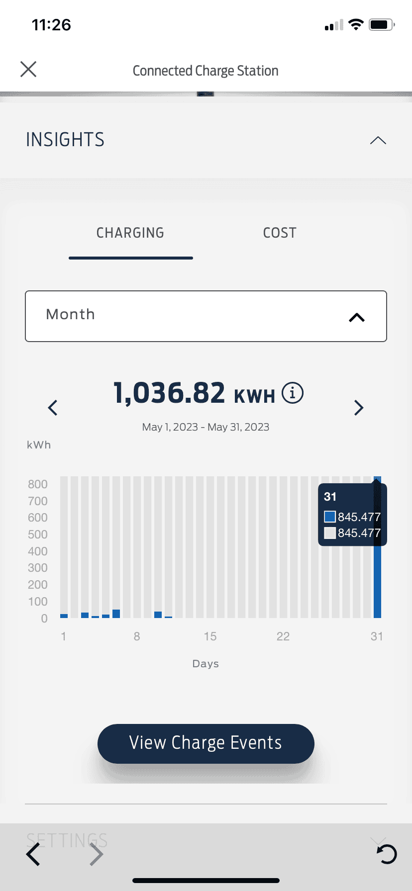

Okay so first, don’t judge on why it took me so long to notice this, but there was a massive 800kWh spike in my charge logs back in May 2023.
Ford F-150 Lightning Charger Usage “Spike” FC498F13-B46A-4607-A45C-0042E5096283

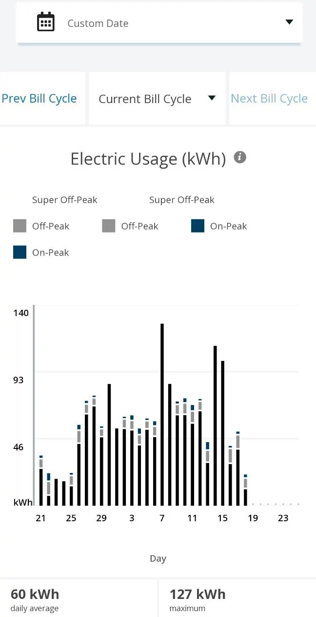

just a silly error in the app right? Well I went to go look at my electric provider and see if it correlated there and…
Ford F-150 Lightning Charger Usage “Spike” 099C0952-5F2C-4974-BBDB-13BBCA6FC539
between April and May it jumps almost exactly 800kWh!
This tells me the usage was real and for that amount of power to flow through the charger within a day scares me (think fire hazard).
has anyone else seen anything like this??
4,075
5,344
Bug in the (cr)app. It’s physically impossible for your EVSE circuit to supply that much energy to the truck in one day.
Yes, I’ve see the same. Supposedly, I added over 1 megawatt-hours to my Mach-E on day. ?

Maybe a logic error in how the Ford software is totaling the usage. I'm thinking that 800 kWh was actually spread over several days? - I see a big gap between the 11th to the 31st.
Based on Ford's other software "quirks", I'm doubting their math skilz.
this is kind of what I assume, and spread over a few days does relieve some concern over fire.
However I did see a near perfect correlation in my utility bill, which is completely independent measurement. So the electricity did get “used “ somehow. I looked at my calendar and I didn’t take any trips or anything that month, just my usual commute.

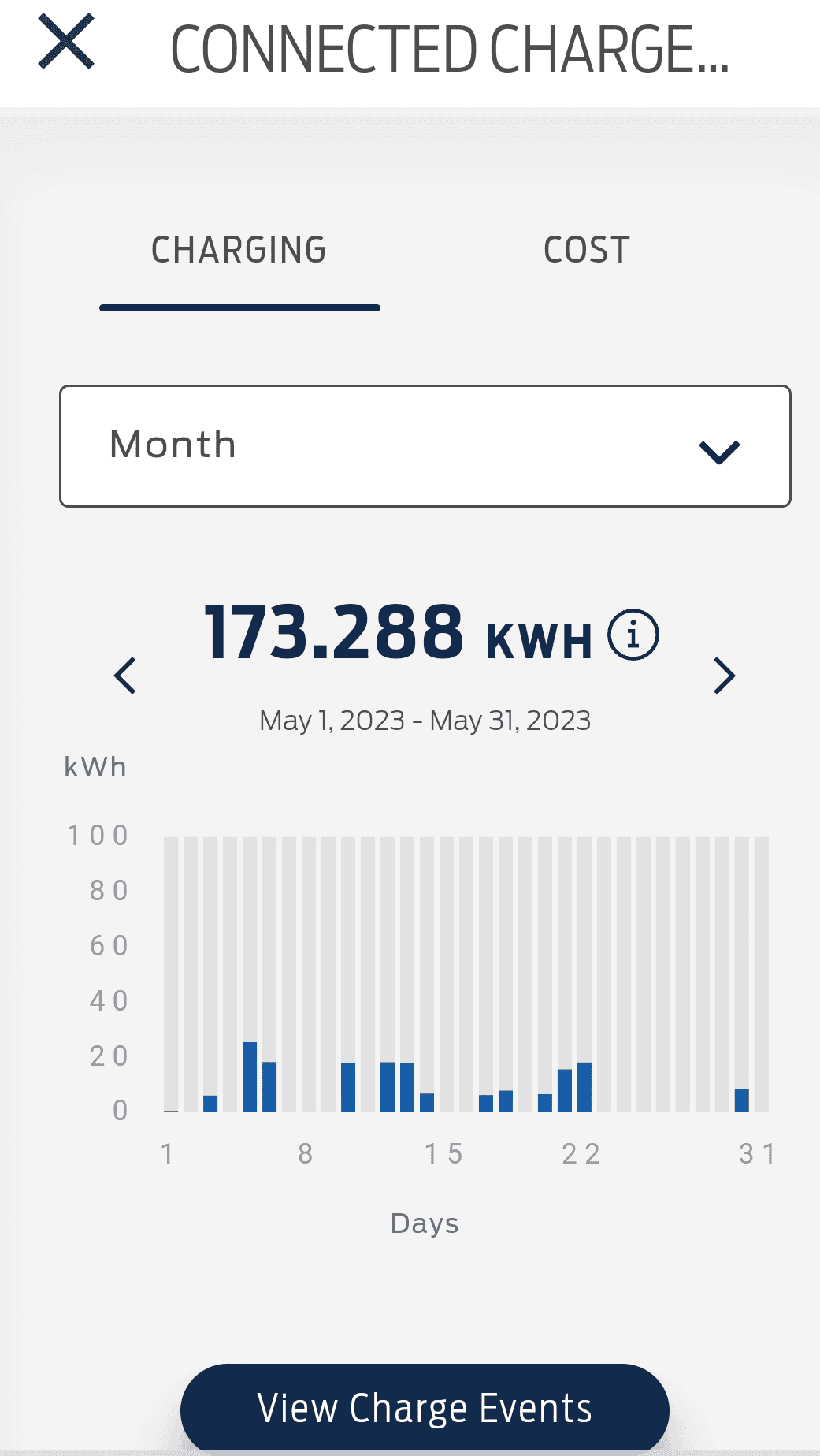

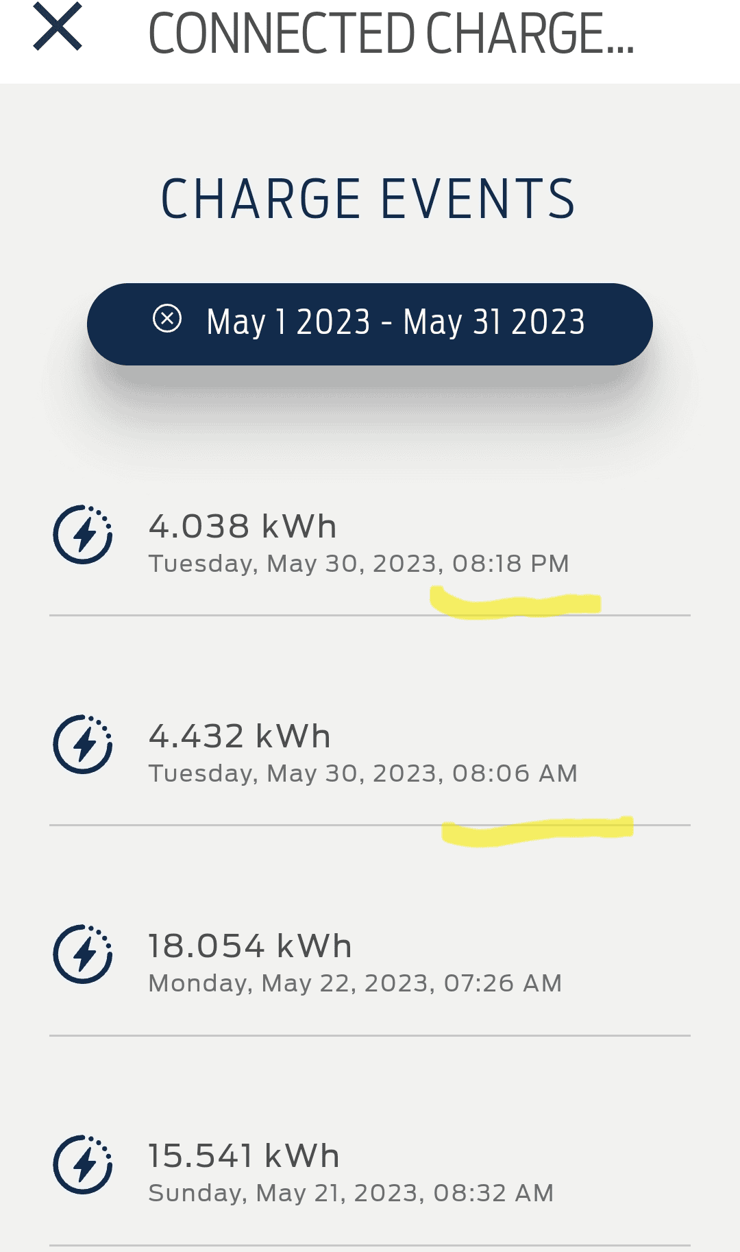

I looked at my logs for May, nothing unusual to the extreme you have, click view charge events for a table of the specific values, on 5/31 wonder if it is multiple records or one event
I looked, it shows as a single event at 6:30am.

I’m not sure I’d trust your utility data, either. Why is July zero?
