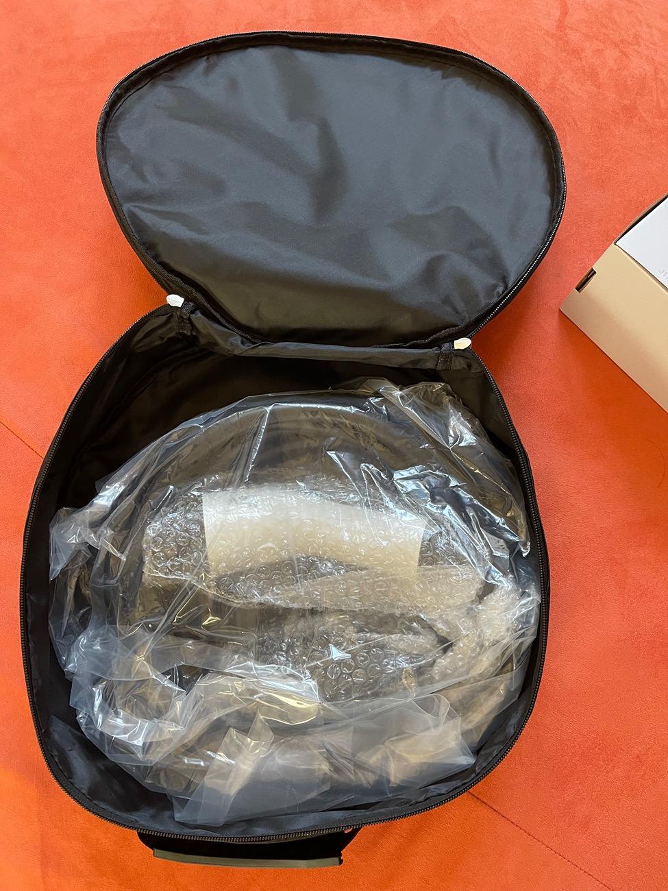

I personally purchased the J-1772 extension cord from A2Z and was very impressed with the quality and how thick it was.

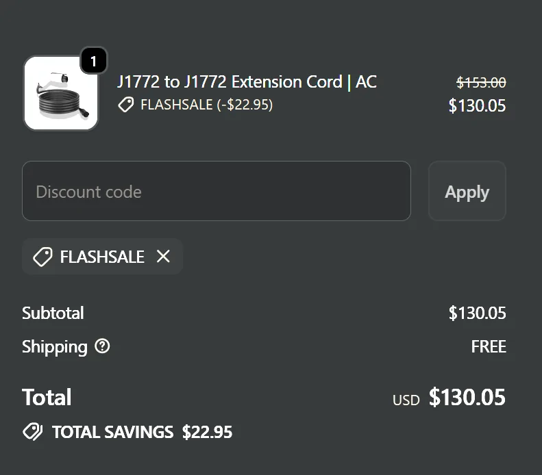

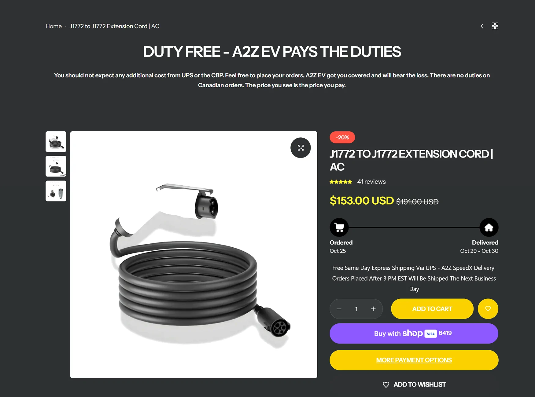

If you decide to go the A2Z EV route using their AC extension cord. You can save 15% off and get free shipping. They will cover the duties right now as mentioned on their page.
Right now they are taking 20% off and the 15% off stacks on top.
Click the link to chose your below products and stack the temporary code "FLASHSALE" to save 15%.
AC Extension for J-1772 home chargers
J-1772 AC Extension - Stack the temporary code "FLASHSALE" to save 15% and get free shipping.
