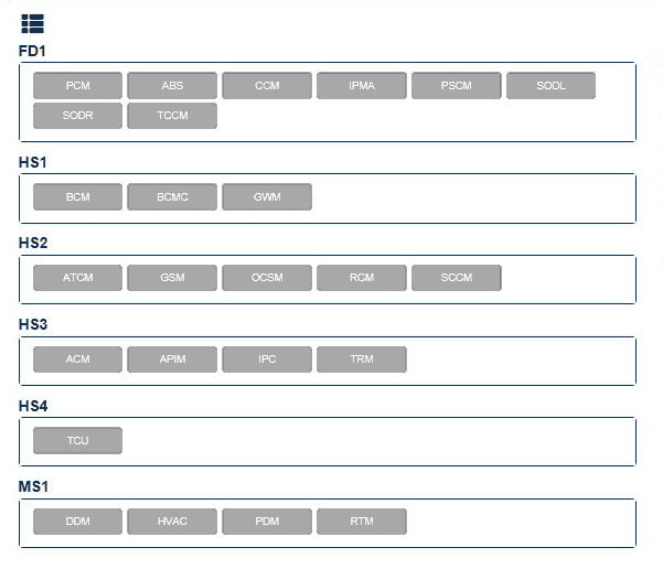

Jesse,
Since our trucks have been going through chip shortages, could we be missing running modules? My first blend date was 7/6 and then got pushed to 7/26 I believe, I was not ramped anywhere since it a few weeks difference in blends. Does my module count look correct on each bus based on what options I have? Shooting in the dark here...
---- EDIT---- I pulled another XLT VIN and the same modules appeared... so that is not it... back to the drawing board I guess.... :(

Jesse,
XLT 302 high 4x4 sport pkg SCREW
5.0L
8" cluster with 12" center stack
360 cams with Co pilot assist
Tow tech package
Looks Good. We could be right. the non BC cars arent getting the full package. You say you did not get a CCM update.? You got an IPMA update. Could be the 22034 Update is tied to another module update. Hard to say honestly. I would need @iceman77 to look at the developer side of things. Like the update prerequisites. I believe they have some notes that he can see or make sense of.

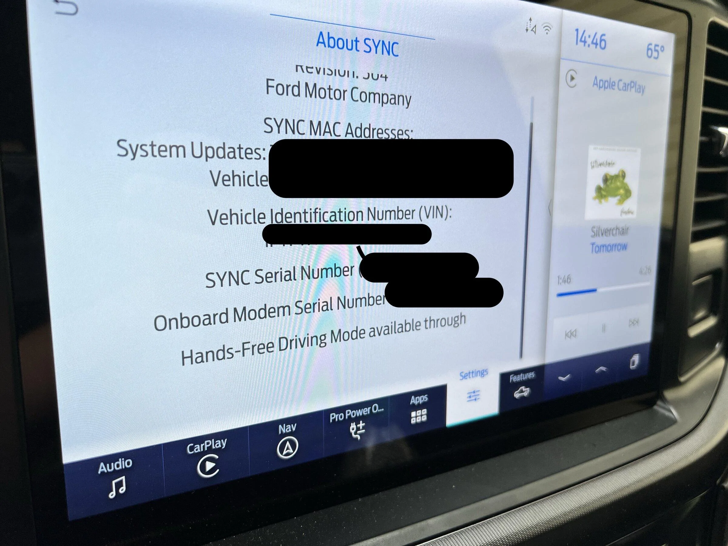

I'm currently in the same boat after getting up to Sync 244. Hoping a long nap and perhaps something in an overnight batch on Ford's servers will get me back in business tomorrow.
Long nap was successful and I'm up to SYNC 358. Letting the truck take a short nap (e.g. let the blue USB lights turn off) after loading the final GWM update as that seems to help make everything come back to life.
All my Orange modules are now green, save for PSCM which is gray. Not sure if that's something to worry about or can be safely ignored.

Edit/Update:
This is what my "about" menu shows and maybe explains why I got BC without any notifications. I'm going to go ahead an assume that the blank date means I get BC "until the end of time" after going through this song and dance!
Ford F-150 Lightning ECU module programming guide using FDRS IMG_0470
It turned green on my final scan and I'm now 100% up to date! Oddly enough, my Blue Cruise says "Activation Pending" on the Ford connected services page, and I've received no emails or anything and didn't see anything unusual in the menus so I took it out for a test drive and figured I'd see if the lane keeping assist had improved.
I hit the button and suddenly the dash lit up and I was officially Blue Cruising!
I need to try the ForScan updates for cameras at speed since that's not working, and as someone above mentioned, my PRB up/down works fine but the approach detection either isn't as sensitive or isn't working.
Before they were frankly too sensitive and whenever I'd lock the truck they'd stow and then immediately re-deploy since I was still near the truck.
Overall super happy this all worked, and really appreciate all the gurus sharing their wisdom!
