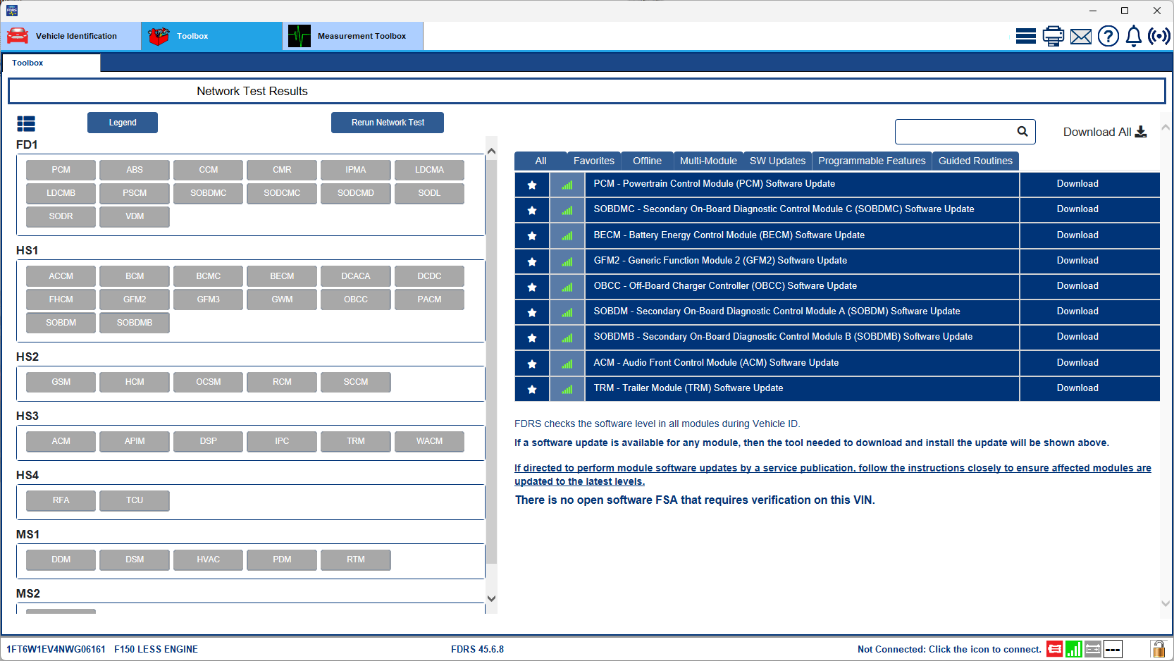

Yesterday when I checked, all I had was the ACM update that never clears....
Today I've got a complete set of powertrain updates and yet another trailer module update.
I had to double-check that I'd entered the right VIN. I was so surprised that anything showed up for my truck. It's been a 'minute' as they say...
Ford F-150 Lightning Lightning Software Updates using FDRS Lightning_Powertrain_TRM_18-Oct-25

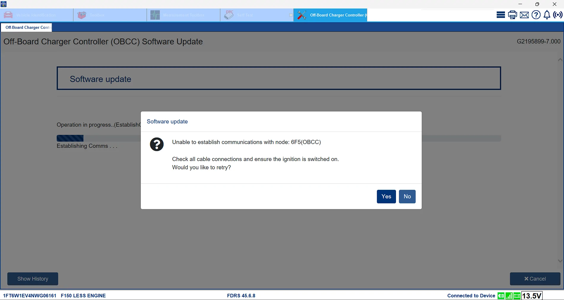

Sooo mixed results.....
TRM was done first...took maybe a minute.
Then I stepped though the powertrain items by starting with the PCM and then just turning on and off the truck when told to do so. No drama.

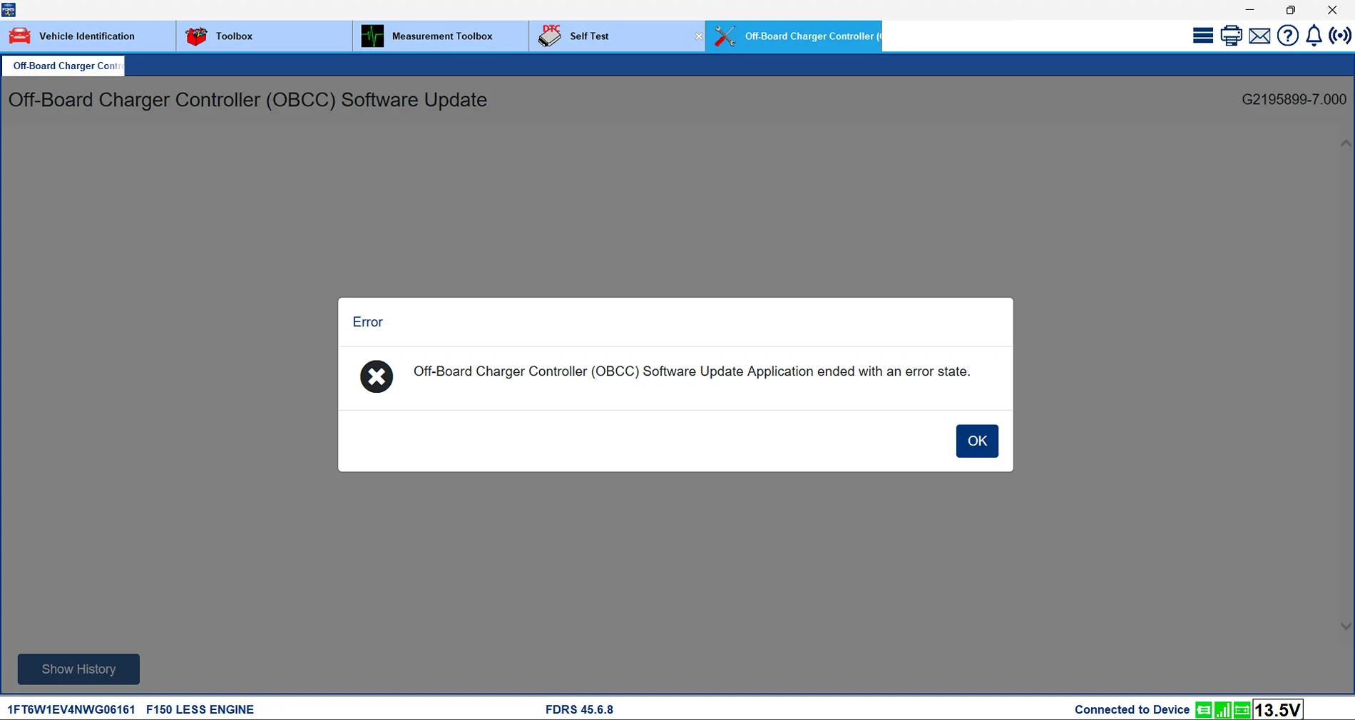

And when that was finished I came back to the menu to find an OBCC update that I had initially overlooked mentioning in my previous post above.....so okay I started on that and got nowhere due to a comms error. This is using a Bosch VCM3 and the PL6100, and having just done a complete set of powertrain updates.....I knew it wasn't my rig that was the problem.
I exited.....did a selftest and everything was still reporting green.....and had another go...same thing. Rinse and repeat. Still the same.
So I've got the ACM update that never goes away along with an OBCC update that won't proceed because there's a communications error of some sort.....even though the module is working fine and communicating on the network...and is in fact now charging my truck as I write this.
I'm thinkin' others are gonna have issues with that OBCC update...post back here if you do...or if it went through for you, either way.

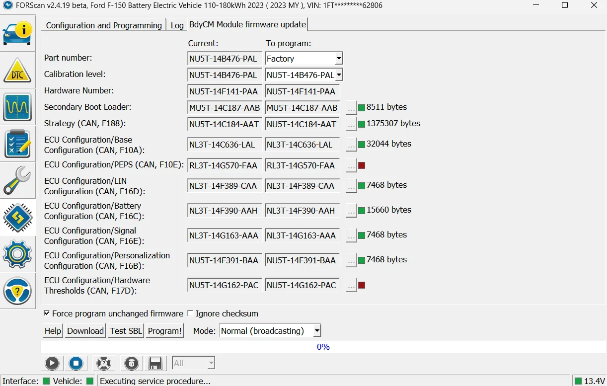

For anyone that has the beta forscan and wants to compare. Below is what mine shows with an updated BCM.
Ford F-150 Lightning Lightning Software Updates using FDRS 1760877736061-u1

I've never used FORSCAN to update a module before.
I have the files for the OBCC that doesn't program due to a comms issue......how would I update that OBCC using FORSCAN instead of FDRS?
I think you need the beta version to do updates, from what I've read before ...but that's all I know.
EDIT: After a brief search I've found the beta forum and downloaded the latest...and am now reading through the process described on that site.
I logged in today and that was the only update waiting. I got the same errors/issues.
I had the same issue last night with the OBCC update.
The tricky part is knowing where the files go. In the case of the OBCC, it may be much easier than the BCM since I doubt it has so many config files. Plug in with beta and post a screenshot of what the programming page looks like. If the OBCC is just one of each (one strat, one config and/or calibration file, then it will be easy.
I would recommend you PMI the OBCC as it is and keep those files handy in case you need to revert back after you flash the new files.
