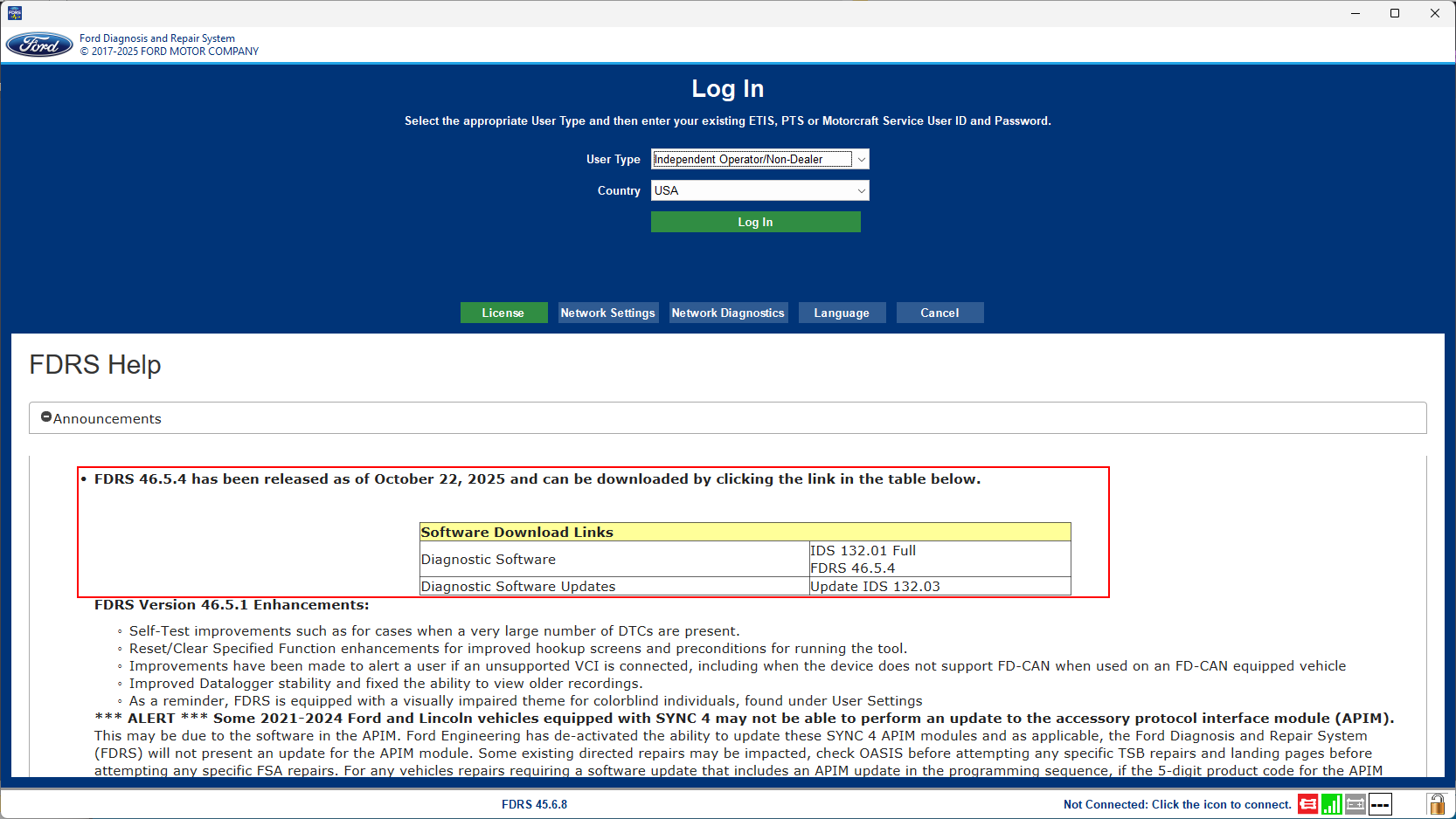

Word of caution for those using IDS/FDRS:
On the 20th of October my FDRS stopped working and I got an email saying my account had been suspended. I posted about that earlier.
But later after I complied with the instructions to completely remove FDRS, VCI manager, and delete the Ford Motor Company folder in the Program Files directory and then reinstall everything I still couldn't log in and kept getting a failure that looked like this:
Ford F-150 Lightning Lightning Software Updates using FDRS FDRS_Too_Many_Attempts_obscur
(no, that's not my actual login info)...
So if you see the "Too many attempts..." error, you've probably been blocked is the point of this message.
I submitted yet another response telling the help desk that I had complied with their instructions on the 21st and nothing...zero, zip, nada......crickets.
So yesterday morning early I created a ticket to the Bosch helpdesk instead, asking if someone there could help get my account re-enabled and shortly after that I got an email with a short message that said:
We show that you a performing remote diagnostics which is not allowed. You must always be present with the vehicle. Please respond stating you will no longer perform remote diagnostics, and we can re-enable your account.
So...looking up VINs to see what software updates are available is considered 'remote diagnostics'.
Just so you know.
That wasn't the only issue, actually. Since I was using the 'Legacy' type login based on the 20 character license code that was still effective till early next year....that was supposed to have been converted by somebody at the Rotunda helpdesk...and I was never emailed and told about that either. But that got done yesterday.
So I sent the email this morning saying I would no longer check VINs on vehicles I was not in the presence of physically...and my account has been turned back on.
I won't be able to check your VINs for you anymore. And that's the real sadness here.
