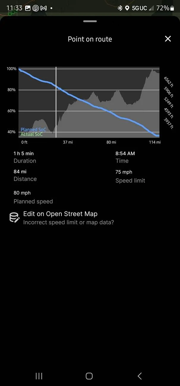

If you click the route itself in ABRP it will show the elevation over the distance.
Here is my ERs expected SOC across that route.
Ford F-150 Lightning Kingman, AZ to Williams, AZ (pulling RV 🪫) Screenshot_20250401_113317_ABRP

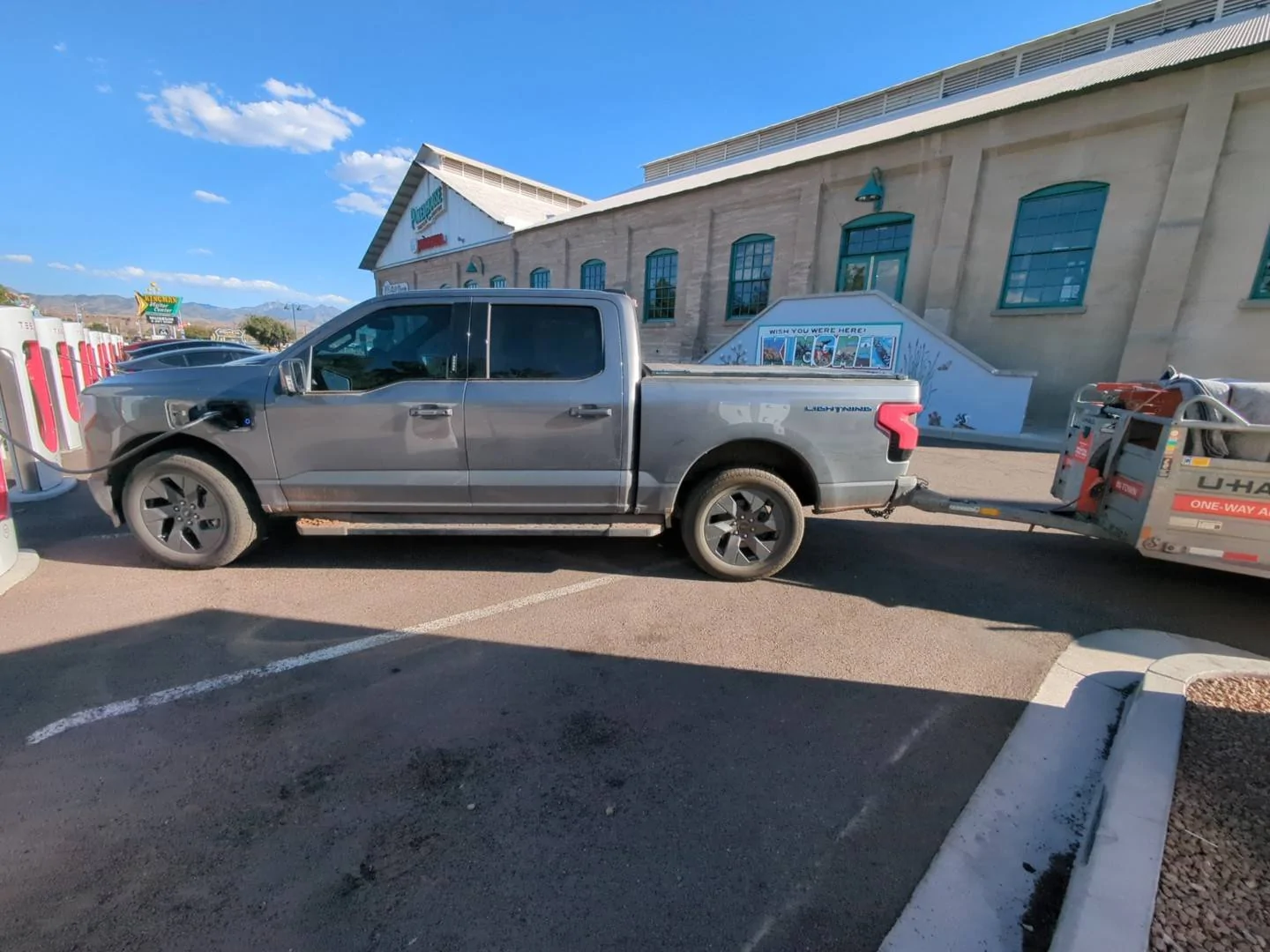

On your way out: Stop at Kingman's Rte 66 museum as noted by everyone else. You can squeeze in to the last charger by the transformers with a trailer if you're super careful. You'll take up two chargers, but that's true no matter what. Go in around the back of the museum. Get there before 5PM if you want to use their restrooms. The burger joint across the street has good food and a restroom.
In this photo I didn't get as clean a turn as I should have and ended up blocking three chargers. It wasn't a busy day, so I didn't actually stop anyone from charging.
Ford F-150 Lightning Kingman, AZ to Williams, AZ (pulling RV 🪫) PXL_20240928_230940731.RESTORED (1)

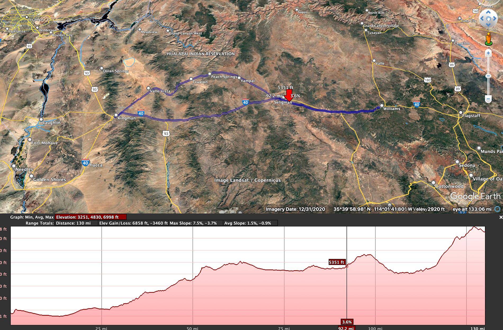

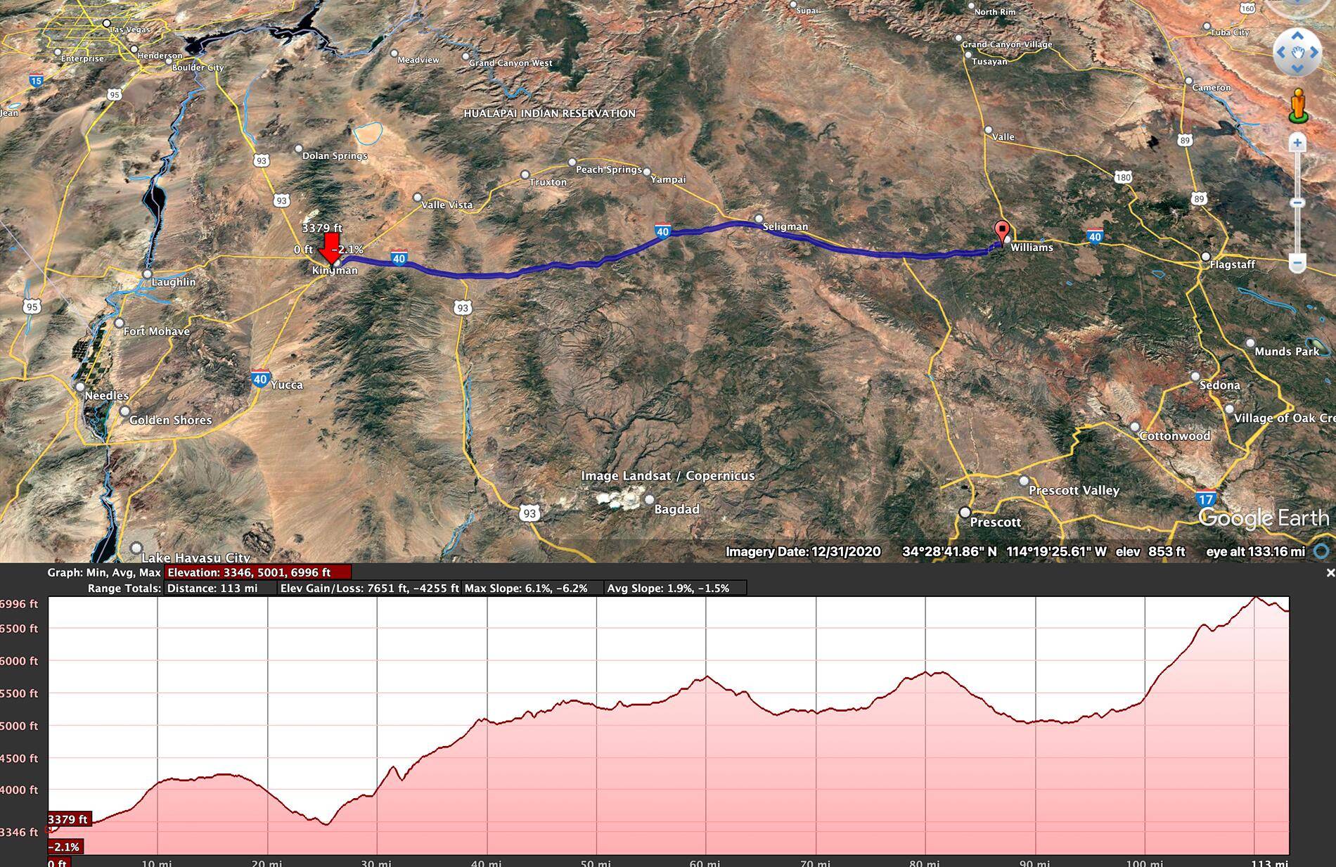

To get from Kingman to Williams, you'll have have a couple of climbs to make, as noted, and as shown below. Making some assumptions about your weight: the climb itself will cost you at least 15-20 kWh more than driving on level ground.
The typical wind is almost never an issue. That said, if you're doing it soon, there can be springtime winds that come up without warning (unless you're a weather forecaster) and then they'll be an issue. Check NOAA before hitting this leg, bad winds along I-40 can topple semi tractor trailers.
Ford F-150 Lightning Kingman, AZ to Williams, AZ (pulling RV 🪫) Screenshot 2025-04-01 at 08.32.03
I would plan for this leg to get no better than ~80% of your normal towing efficiency. You need to get at least ~1.0-1.1 miles/kWh on the leg to make it between the two chargers, assuming you charge to ~100% in Kingman. So, if you don't normally get 1.2-1.3 miles/kWh while towing, you'll have to think about either slowing down, finding another route, or stopping for an overnight somewhere along the way and Level 2 charging. Again, note that the climb itself, some 3000+ feet will cost you at least 15 kWh (mass * height * gravity = gravitational potential energy; assuming your trailer is 5500 pounds and the truck is 7800 pounds), and probably more like 20 kWh because dropping down doesn't gain back everything you spent climbing up.

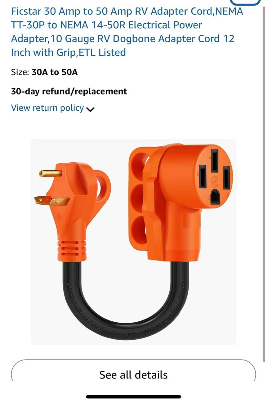

Have you looked on PlugShare? I see a General Store in Seligman you can use as an emergency charge if needed. They list having a NEMA 14-50 you can use for $10 2-4 hours.
I should be able to plug-in at the general store with this Nema 14-50 correct?
Realizing I needed an adapter. I think I should be good with this adapter.
Ford F-150 Lightning Kingman, AZ to Williams, AZ (pulling RV 🪫) IMG_8480

You are looking at a very long charging time.
30 A will only deliver 6KW power.
Assuming you wanna stay for an hour -
That’s worth about 6 miles of range at 1 mile per KWH.
IMO you should max out the charge at Kingman and take it slow and easy to go directly to Williams on 40. That will take far less time than trying to use a L2 Charger along the way.
It is 113 Miles. You’ve got a 131KWh battery. If you can increase your miles per KWH by slowing to 55 you will make it.
I tried a couple of these "EV-compatible" power cord adapters and my Ford Mobile EV Charger wouldn't work with it. As it turns out the Ford Mobile Charger requires a 240V supply for optimal Level 2 charging. TT-30 outlets provide only 120V, which would limit the charger to Level 1 charging speeds. Just wanted to share my experience and let down before you got too far down the road.
