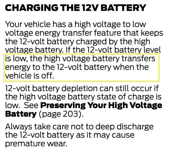

That is the experience many here share. Interestingly, this is what the manual states:
A properly functioning truck should never completely drain the 12V battery unless you have something extra drawing power from it.
I think we are at a bit of an impass. The quote from the owner's manual does not specify truck on or off nor charging or not, or plugged in and finished charging. Anecdotal evidence says 12v charging is only with the truck on or actively charging and, from the manual, when the 12v is low.
As many times as the 12v has gotten low I can't help but think it can run down on its own if not on or actively charging even on a properly functioning truck.
I got an OTA 19 May that noted protection for the LVB. My likely failure was a couple days ago.

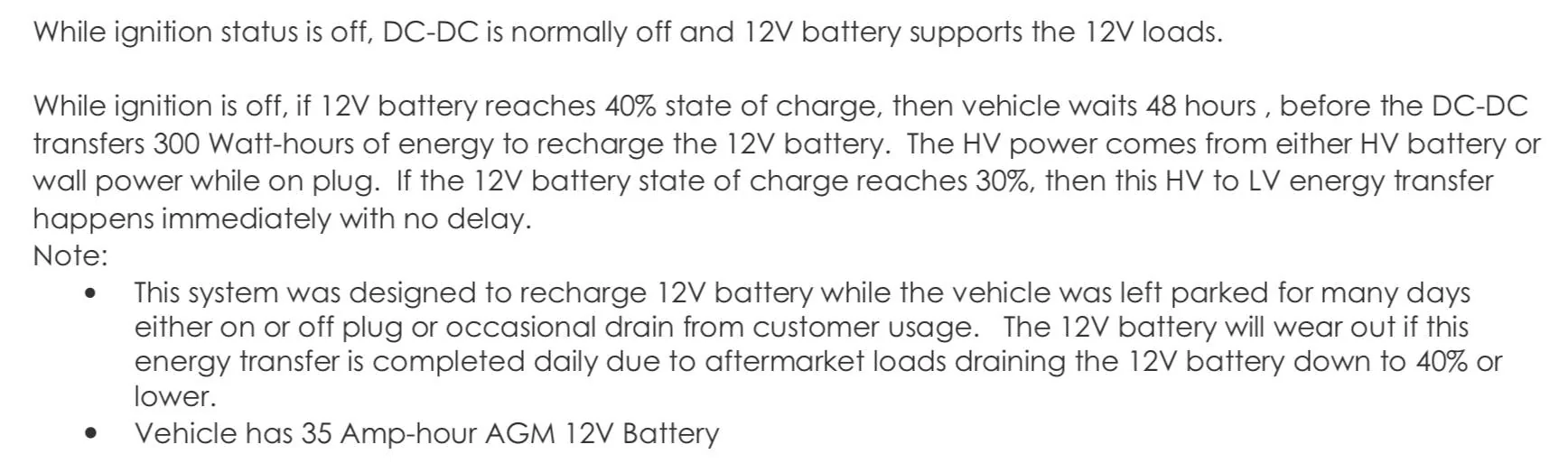

This is from the police modifiers bulletin. I don’t know if this applies to all Lightnings or just the SSV package but with all the reports of dead 12Vs it seems like it may not be working.
Ford F-150 Lightning Leave plugged in? IMG_0708
4,297
5,746
I think that applies to all Ford EVs, and I read somewhere (maybe on the Mach-E forum) that the 40% threshold has been increased.
