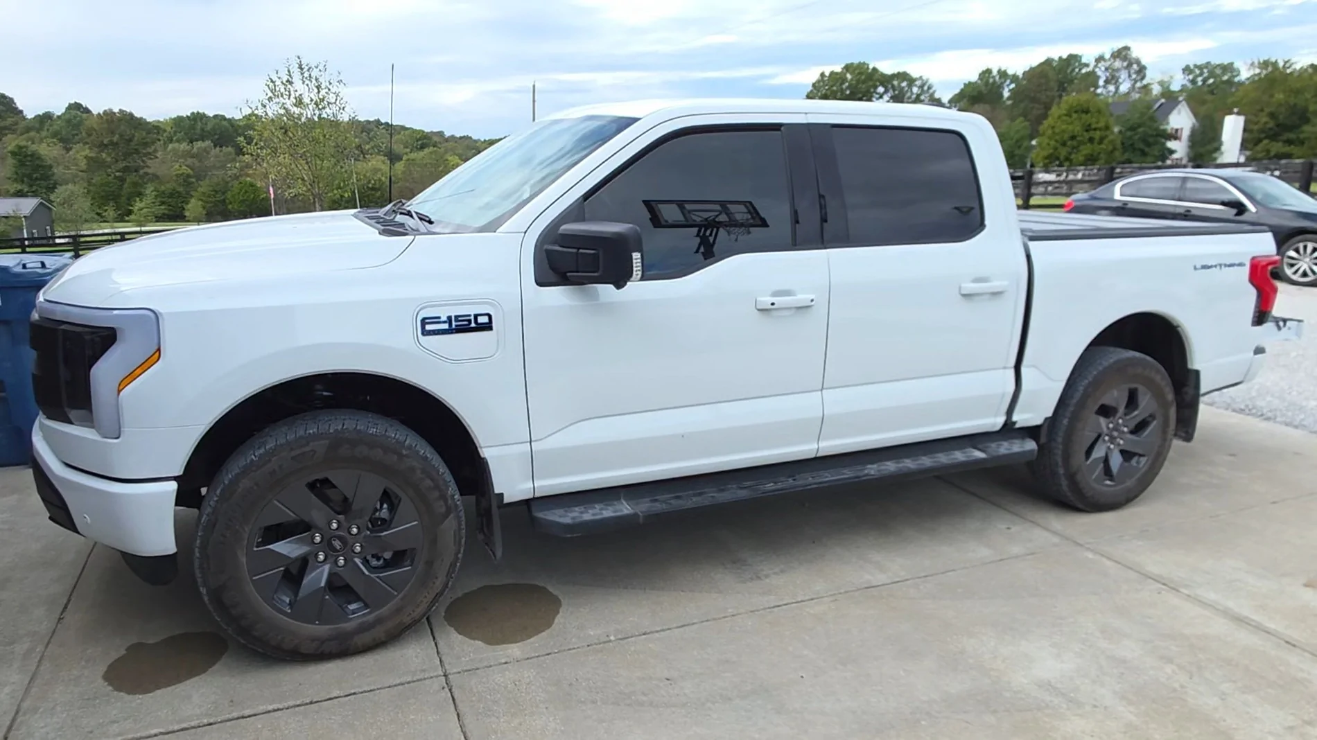

Installation went well. We unhooked the brake/ABS lines, disconnected the sway bar link at the top, disconnected the upper ball joint, and disconnected the steering linkage. Struts then were able to go in/out. Only tough part was putting the struts back in with the spacers now bolted on due to the extra height, but a crow bar took care of that problem. I did not want to fool around with any control arm bolts because I'm not going to get an alignment until I get tires.
Ended up with exactly 1.5" of level as advertised, which leaves 1.5" of rake for hauling and towing while still looking better than stock.
Thanks for sharing. Did it change the ride much?
Ever so slightly more firm. You have to be paying close attention to notice.
