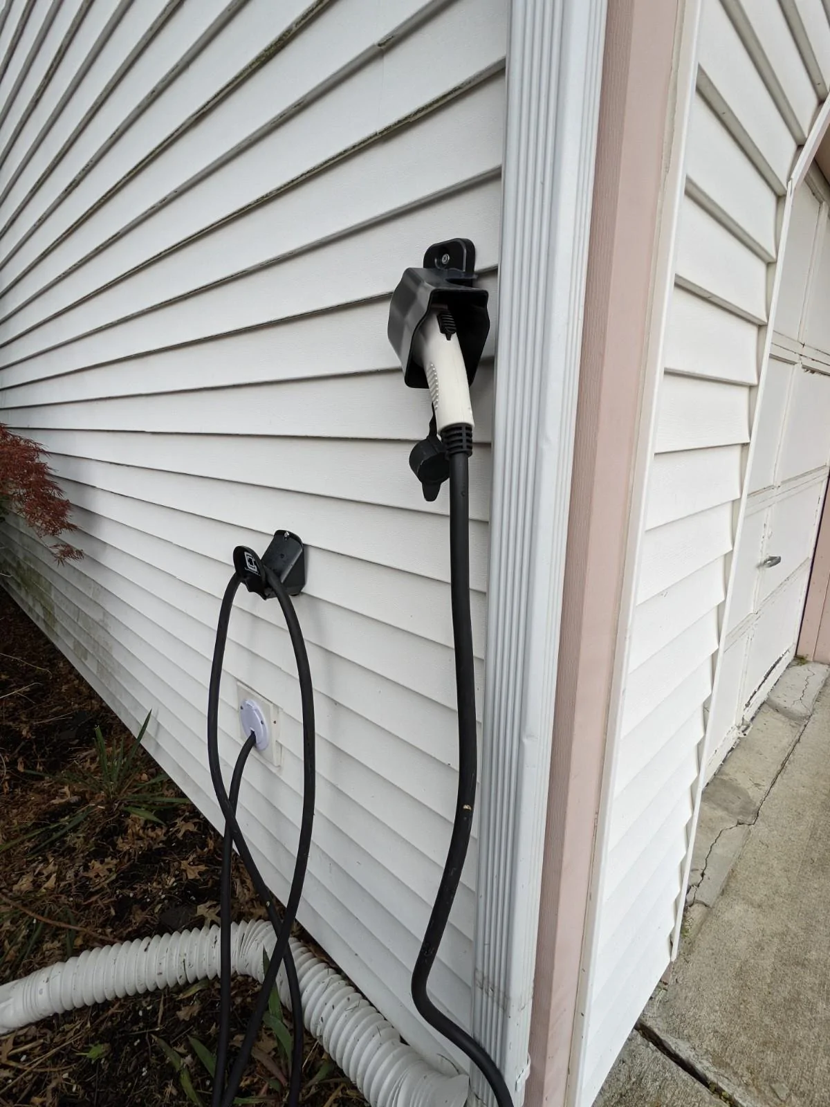

A Mach E owner used one of these RV ports:
https://www.macheforum.com/site/thr...yone-purchasing-for-home-use.5663/post-192147
Ford F-150 Lightning Lightning bigger than my garage! PXL_20210415_183030472
Ford F-150 Lightning Lightning bigger than my garage! PXL_20210415_182943739
