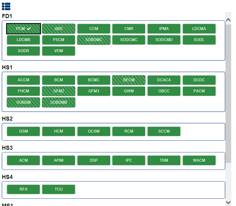

Just fired up FDRS again to see if there were new updates relating to the BC 1.3 business, and I see several modules have a "GVMS Warning". I clicked on one of them in the list at the bottom of that screen and it popped up a dialogue box saying it had opened an As-Built Assistance request for me. Hm, hope that doesn't waste too much of someone's time...
But what's the deal with this? What does a GVMS Warning really mean and why would I have them for several modules simultaneously right now?
Screenshot below - all the modules with the \\\\ across their names are in "GVMS Warning" state.

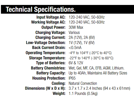

That's why I qualified my remark about his "power supply" recommendation with comments to the effect that his recommendation (a Noco Genius2 battery tender) wouldn't do "for a Lightning."
If I ask Google Gemini what size power supply vehicle electronics technicians typically use for ECU programming, the answer comes back that technicians typically use power supplies that can provide from 5 to 20 amps, but the requirements are really vehicle-specific, and more could be required depending on the equipment requirements of the vehicle or the complexity of the programming task.
Here's what Microsoft Copilot says about a battery tender (like the Noco Genius2 the YouTube guy uses) vs. a true programming power supply. The Genius2 only supplies up to 2 A, too. So, I'd say his recommendation is marginal, at best, even for an ICE vehicle with an 80 Ah battery.

UPDATE: Noco Genius2 tech specs:
Ford F-150 Lightning Lightning Software Updates using FDRS 1720913042831-5i
