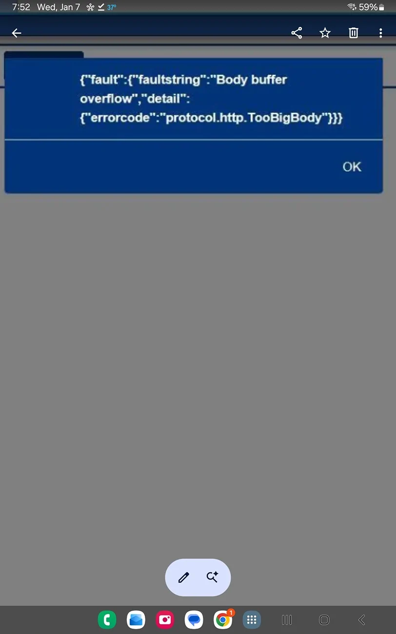

Depends on how many are needed.
Bought our 2022 in May 2023. Updates took 12 hours of elapsed time, including them improperly hooking up thempower supply and updates failing (this was noticed in a picture the salesman sent me). List of applied updates was so long that system had a data overflow on the completed update list.
Some modules can have multiple updates, i.e. update version 1 then a few other modules get updated, which then triggers version 2 for the first module....
