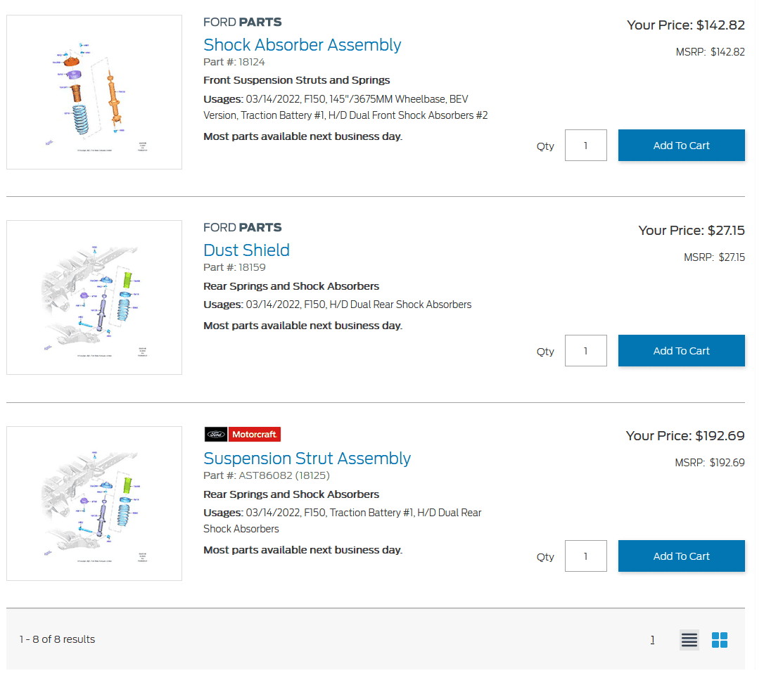

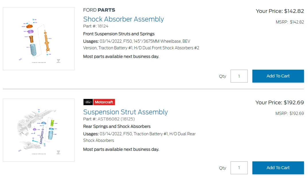

Hmm, front seems to be the same part number (18124) on an SR truck, though they do mention Traction Battery #1. Rear is a different number (AST86081 for ER and AST86082 for SR).
Ford F-150 Lightning Lightning suspension comparison to current F-150? 1658956286578
Also, I can't believe how cheap even the MSRP is on these parts - the whole assembly! And you can get them next day!
