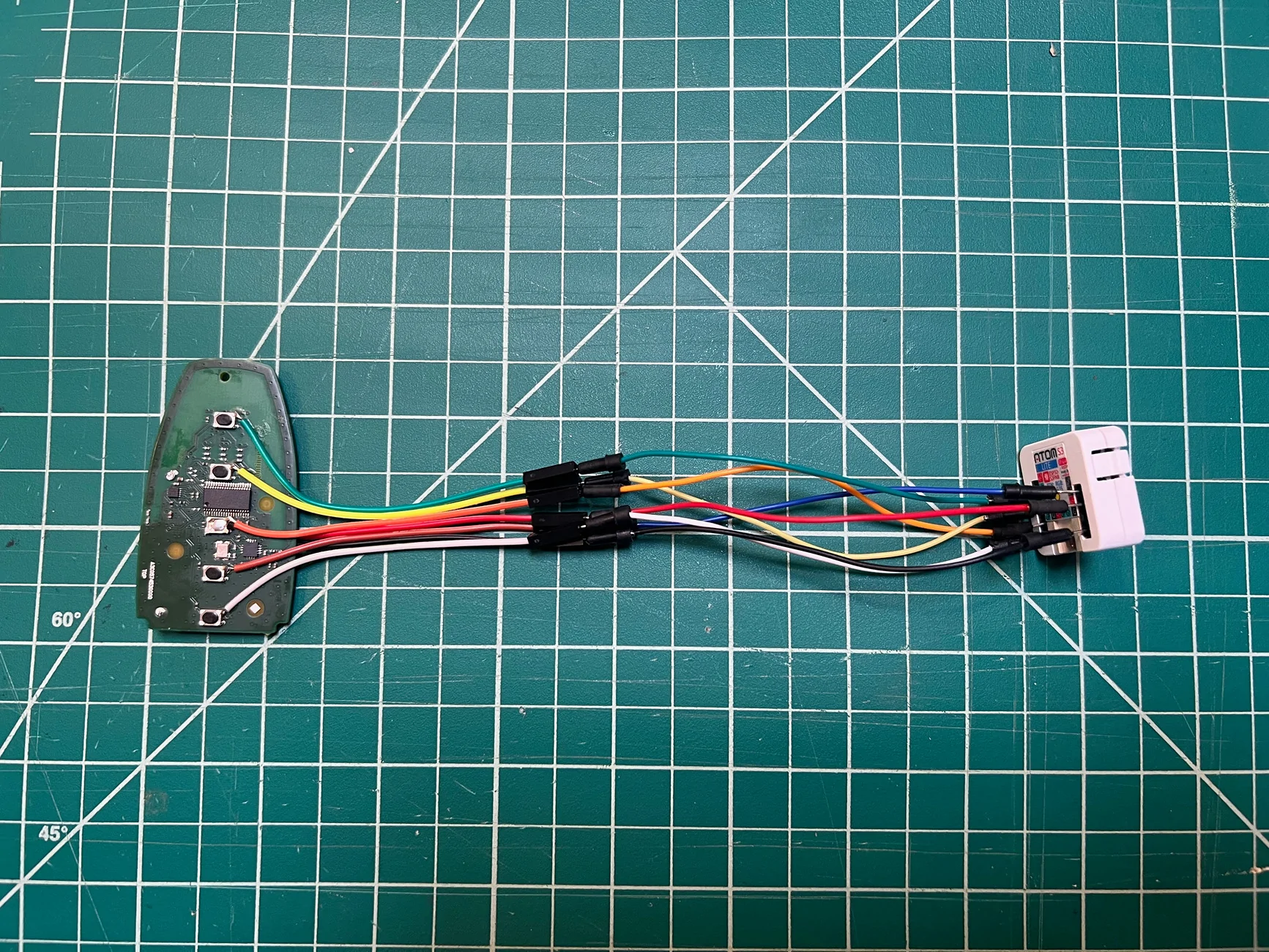

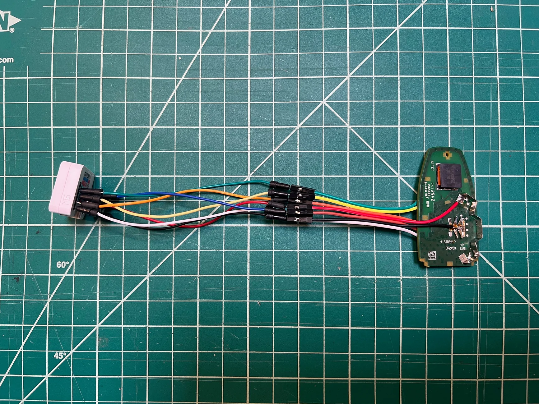

Then I tore the key apart. I had hoped that like other key fobs, it would simply clip together, but as best I can tell it was actually glued shut, so I ended up cutting and prying it open, taking care not to damage the PCB inside.
With my digital multimeter, I confirmed the behavior of the 5 small SMD buttons. Opposite pairs of legs are electrically coupled, with one pair tied to ground. So pressing the button simply pulls the other two legs to ground. All the buttons are oriented identically and work exactly the same way.
From there, it was simply a case of soldering wires onto one of the output pins on each button. I'm not the best at soldering, and these pins are tiny. 4 out of the 5 buttons were easy, but the remote start one by the chip was trickier to get to and I ended up prying off the button top to make things a little easier. I soldered a short female DuPont wire to each button, as well as to the positive and negative battery terminals on the other side of the board. I bought a small, angled soldering iron tip for my Pinecil just for this, and liberally applied solder flux. It's not the neatest job, but my DMM confirmed I had connections.
Ford F-150 Lightning Local Home Assistant integration via ESPHome and key fob IMG_8558
Ford F-150 Lightning Local Home Assistant integration via ESPHome and key fob IMG_8559
I used the female DuPont wires as they were what I had on hand and in future I may do something a little cleaner using a proper connector. For now, I simply connected them to a $7 M5Stack AtomS3 Lite I had lying around which has an ESP32-S3 and just enough exposed GPIO pins for my use case.

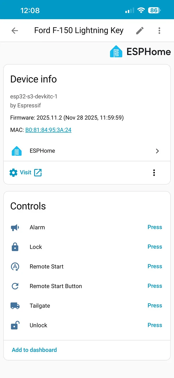

I programmed it with ESPHome, and my config is below in case anyone is interested. I'm sure this could be cleaned up and improved, but for now it works. The basic approach is that it exposes a virtual button to Home Assistant for each of the key fob functions. Pressing the button in Home Assistant pulls the GPIO to ground for 500ms, then lets it float again.
Ford F-150 Lightning Local Home Assistant integration via ESPHome and key fob IMG_8560
For the tailgate open / close button, I trigger it twice from one press in Home Assistant as that's what the remote requires. For the remote start, it "presses" the lock button twice, then the remote start button. I also exposed the remote start button directly so you can turn the vehicle off after it's been remote started.

I've tested it and it all works exactly as expected. Unfortunately, there's no feedback other than looking at the truck to see if it worked. While the key fob fascia makes it look like it has an LED (and I swear my old truck key did), there's no LED on the actual circuit board. I was thinking of tapping into this as a feedback loop of sorts.
For now though, being able to remote start the truck from Home Assistant is huge. I can expose this feature through any number of means now - the LocalDeck by our front door, voice control, a button in Home Assistant, etc. I can also schedule it or integrate it into other scripts.
