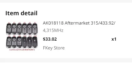

An aftermarket key fob with a remote start button in place of the frunk button (meant for other Ford models) will remote start from the key fob. At least the one I got from Aliexpress does. It would be nice if somebody made a Lightning specific fob with both remote start and frunk buttons.
I ordered one of those, I think, the Aliexpress page had a bunch of key fobs, I tried to select #4 but not sure if the system understood that from the check out item details, so I put in the notes I need #4:
Ford F-150 Lightning Remote start using key fob? aliexpress key fob order-cro
