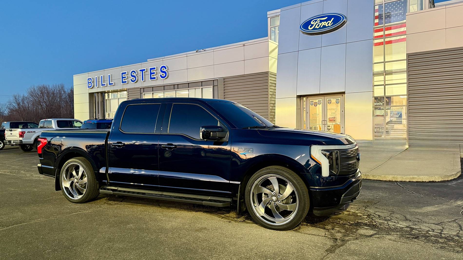

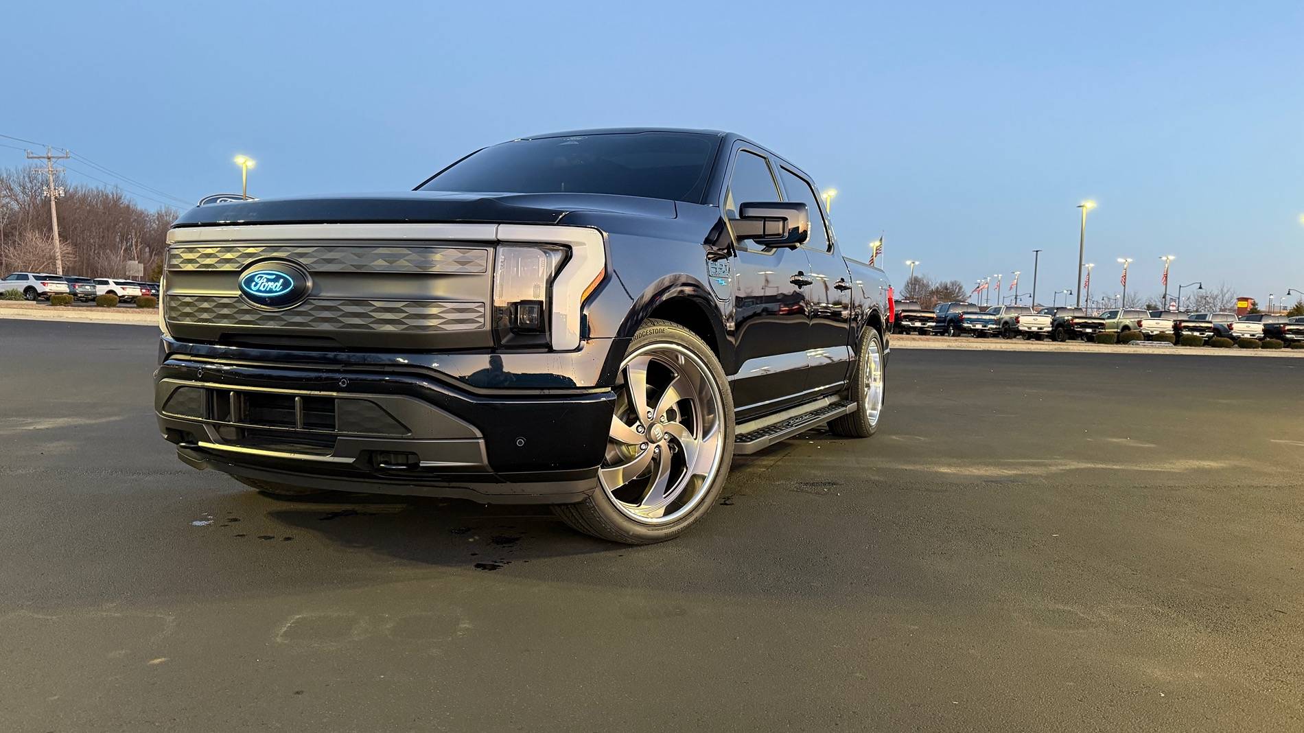

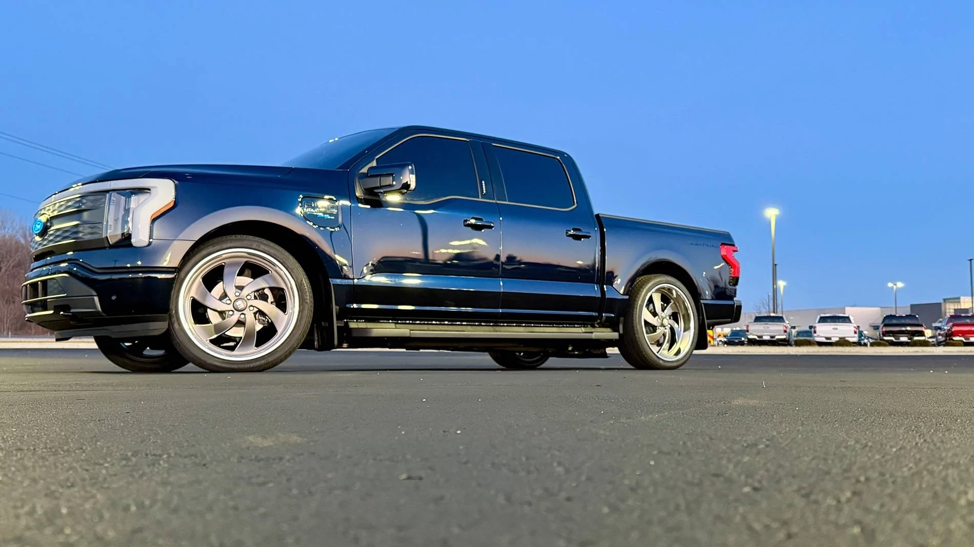

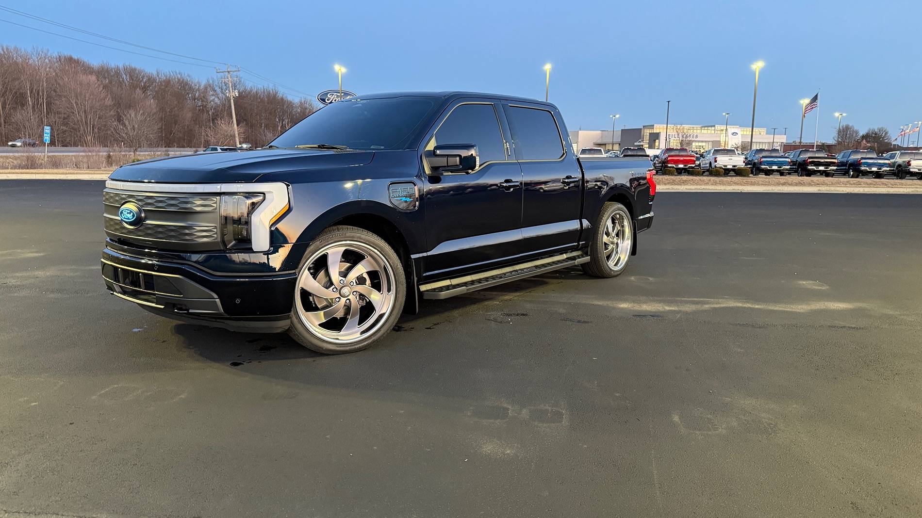

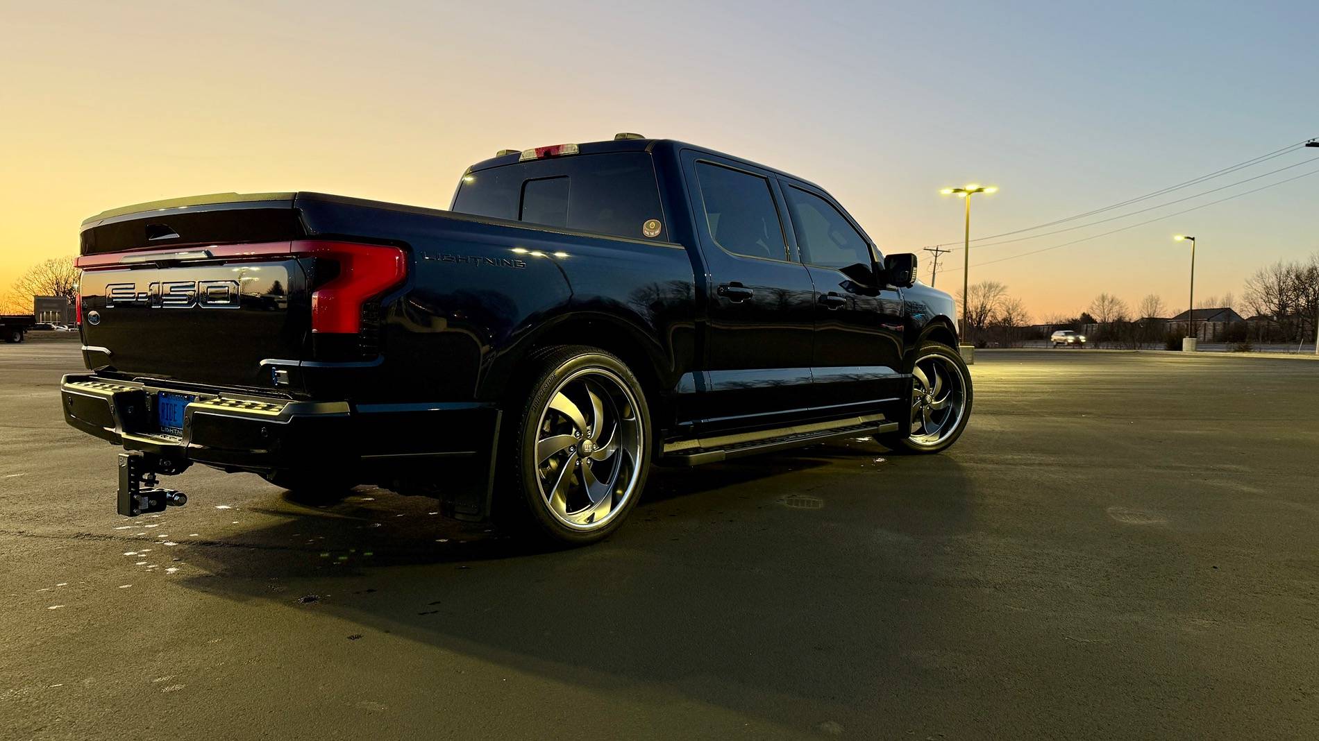

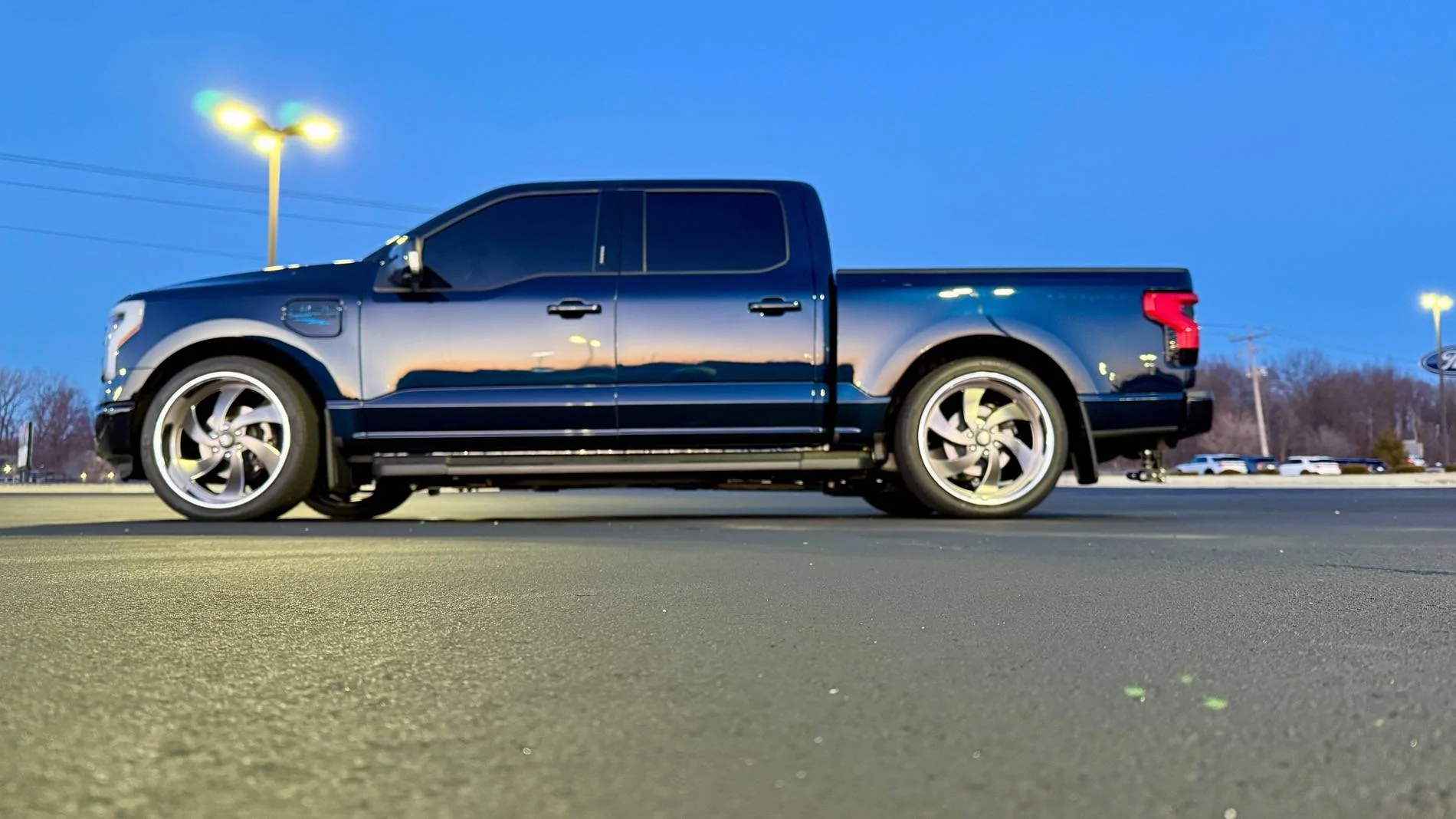

Still have a few small details to take care of but the bulk of it is done.
Belltech 25027 adjustable struts up front with one tall spacer (approx 2.5” drop)
Belltech 25001 adjustable struts put back. “Extension” between shock body and mount removed, no spacers, 1/2 coil cut out of factory coil spring, ICON Dynanics camber kit.
US Mags Desperado 6 wheels. 24x10 +25 offset
Bridgestone
Bridgestone
