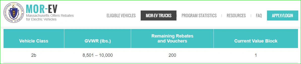

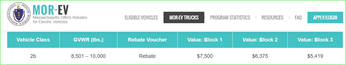

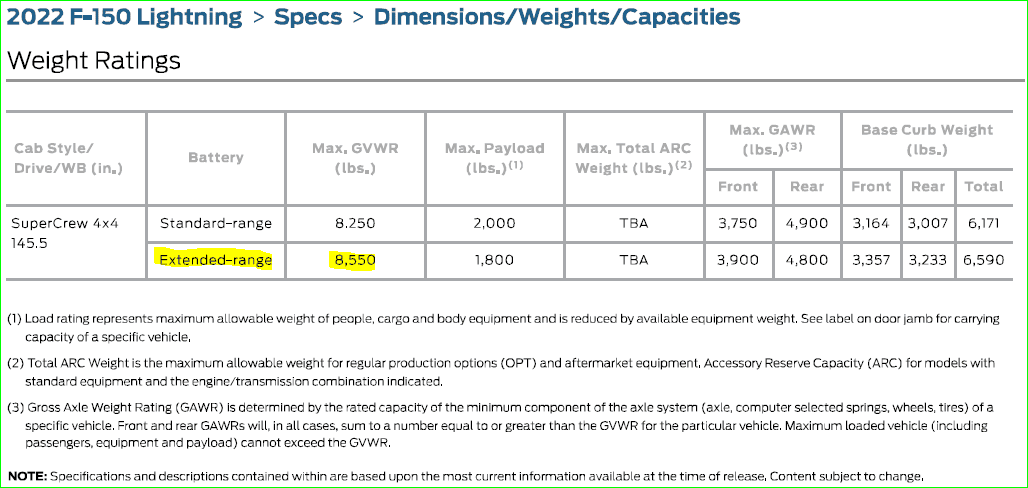

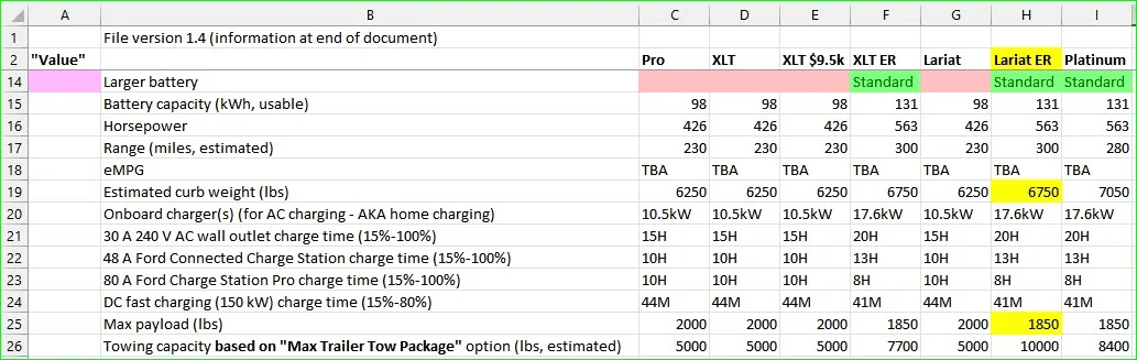

Pay close attention to the details for which our Lightning BEV's might qualify.
GVWR is just above the threshold for vehicle class 2b rating if your truck has an ER battery
https://mor-ev.org/mor-ev-trucks

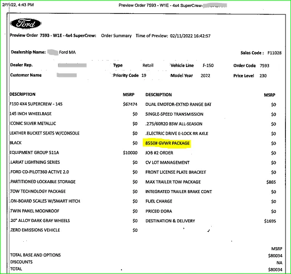

Massachusetts buyers, take a look at your build sheet, does it show the 8550# GVWR Package?

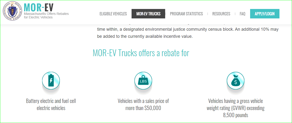

I hope it does as your truck needs to show 8501# or more to qualify for the MORE-EV-TRUCKS REBATE of $7500
What you see here is a Lariat-ER with Max Tow Package.

@TaxmanHog do I need maxtow to qualify for this? I ordered a Lariat ER but only tow tech.

I have not received a reply to my inquiry with the MOR-EV-Trucks folks, regarding if the F150 Lightning will qualify, but IMHO is should as the specifications are right on the border for our trucks with some qualified with MAX TOW and others not!!
I hope your build specifications on your order sheet or the Window Sticker say 8550#, as discussed above., if it does not then you definitely will not, if it does join me in fighting for it, it's a huge value to me and will help with my home electrical upgrades.
Funny thing is, I have seen variations on the window stickers here are two examples of Lariat-ER without the MAX TOW, one shows 8550 the other 8400!

Seems like the only consistent difference in trucks with the lower GVWR is the option for AT tires - which, of course, is what I chose. โ˜น

My mods popped today (I think that's what the cool kids call it); the VIN didn't change, so I assume that means I still have AT tires, 8,400 GVWR and therefore no Mass rebate. But at least there's one less open spot in the Rouge parking lot.
