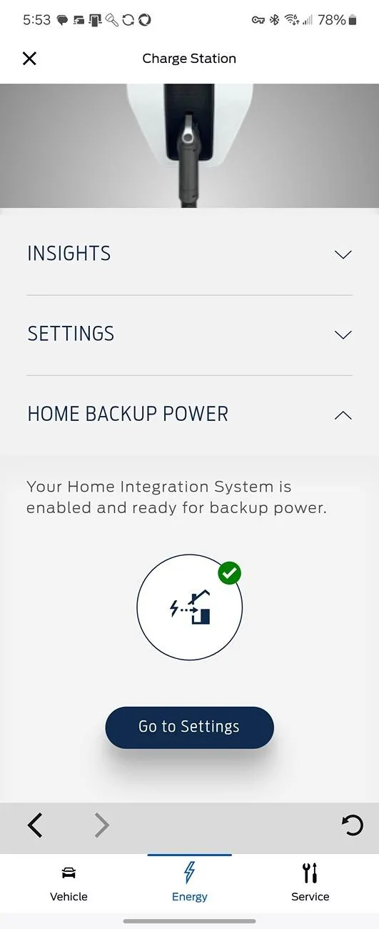

Regarding the Ford Pass app, under the charge station there is a Home Backup Power option. I have attached a screenshot. I did use M-professional. The Power light flashes while on standby, I will check the status of the light during "power-up" next time I test the system. I will save a screenshot of M-professional when i get home.

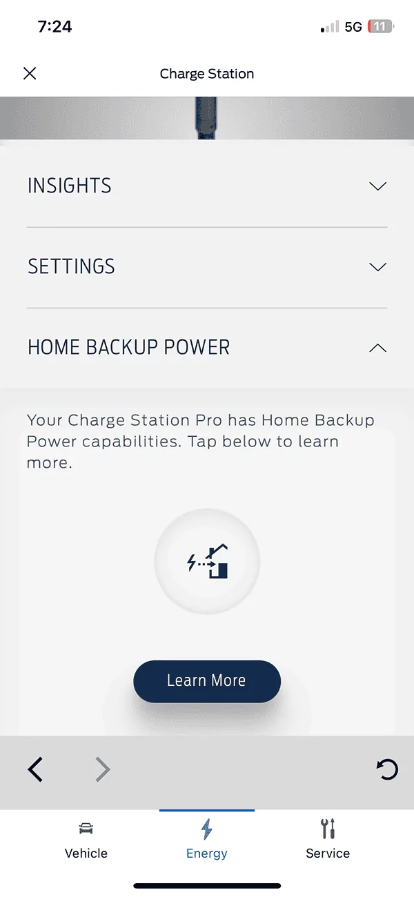

Thanks. I actually think this might be my issue. I’ve successfully paired the station to the truck but the station doesn’t show enabled like yours and others. Any idea how this gets completed? Is it something Ford has to do?
You can see mine is different.

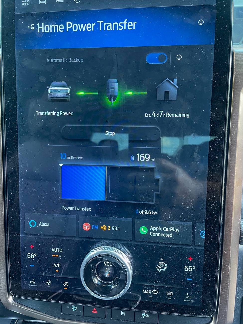

I now have the installation permanently wired in and running. I also now have my existing Solar Edge inverter tied into the backup panel and working well.
Had a successful backup power transfer as well. It was right at dark, so I will have to wait until tomorrow to test the solar re-charging the truck even off-grid.

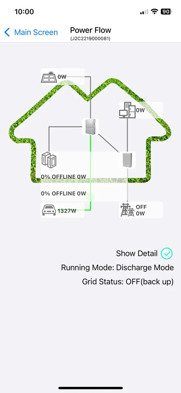

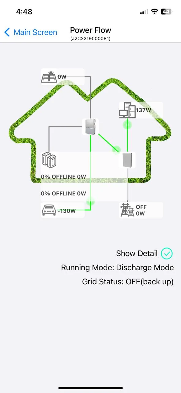

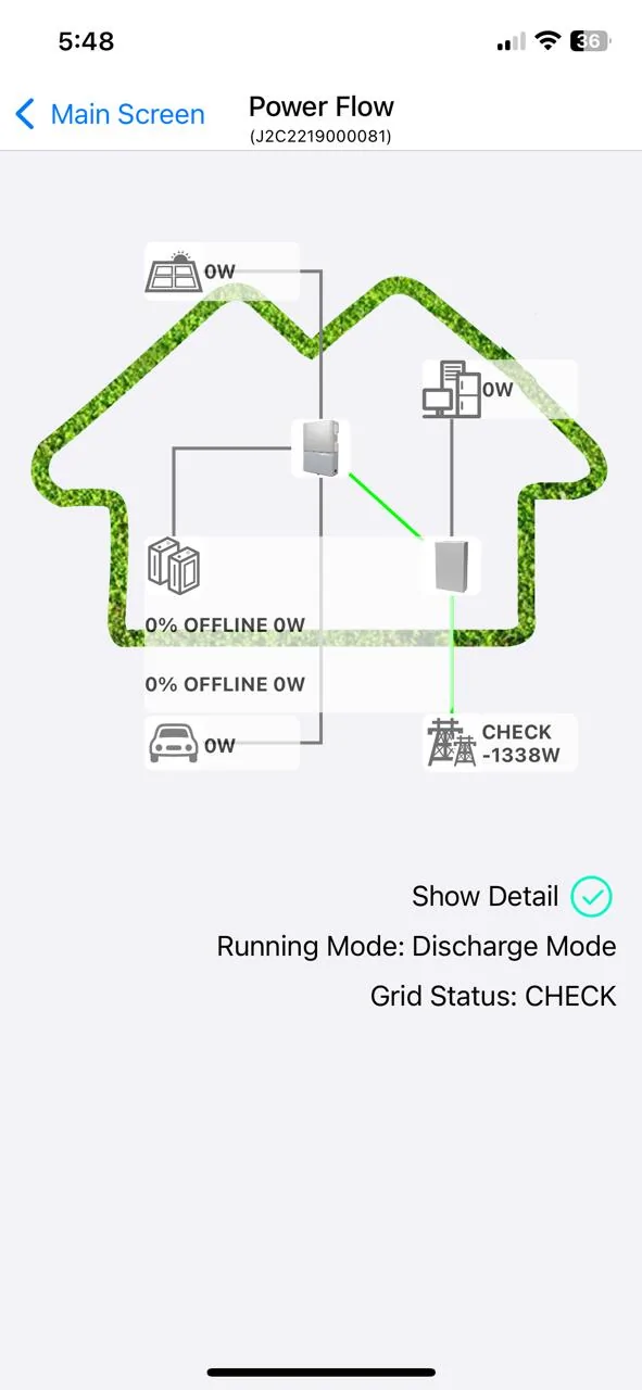

Next update. I can confirm that excess solar will charge the truck even in off-grid mode with the HIS system. In the M-professional app it even shows power flow animation going into the truck.
Its about as fast as a level 1 charger right now, but is working.
