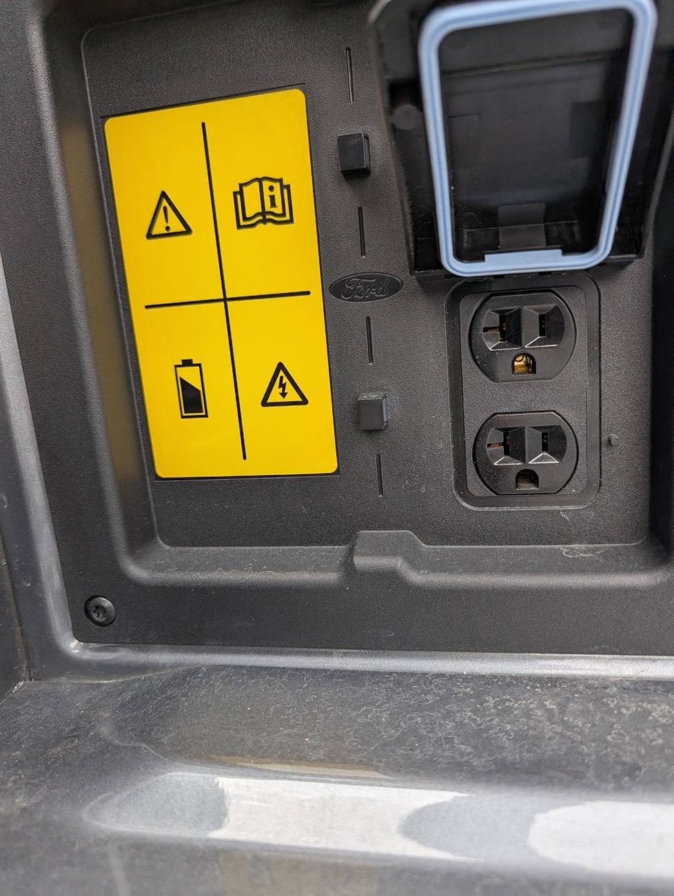

I went to go plug in to my 30 amp port in the bed of my truck, it's not there. Does anyone know if this is some sort of an option on the Ford F-150 2024 lightning flash.
Ford F-150 Lightning NEMA L14-30P  missing  Flash 1000003464
2,892
4,111

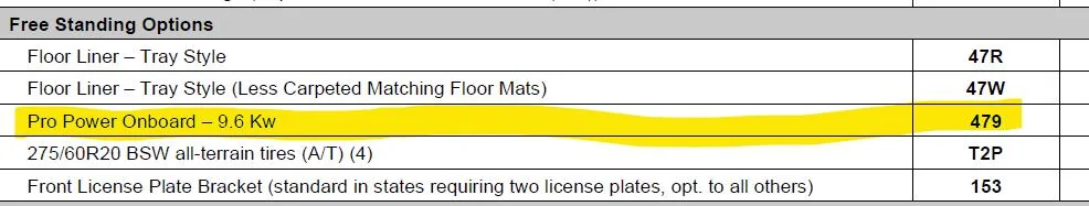

Yes it's an option called 9.6 kW Pro Power Onboard. No way to add it after the fact. For 2024 it was standard on Platinum, $1200 option all other trims.

So basically Ken Garff Ford of Cheyenne, sold me low in model lightning at a premium price. I can't even add this option afterwards.
2,892
4,111
You're not the first. Never trust a salesman and always look at sticker.

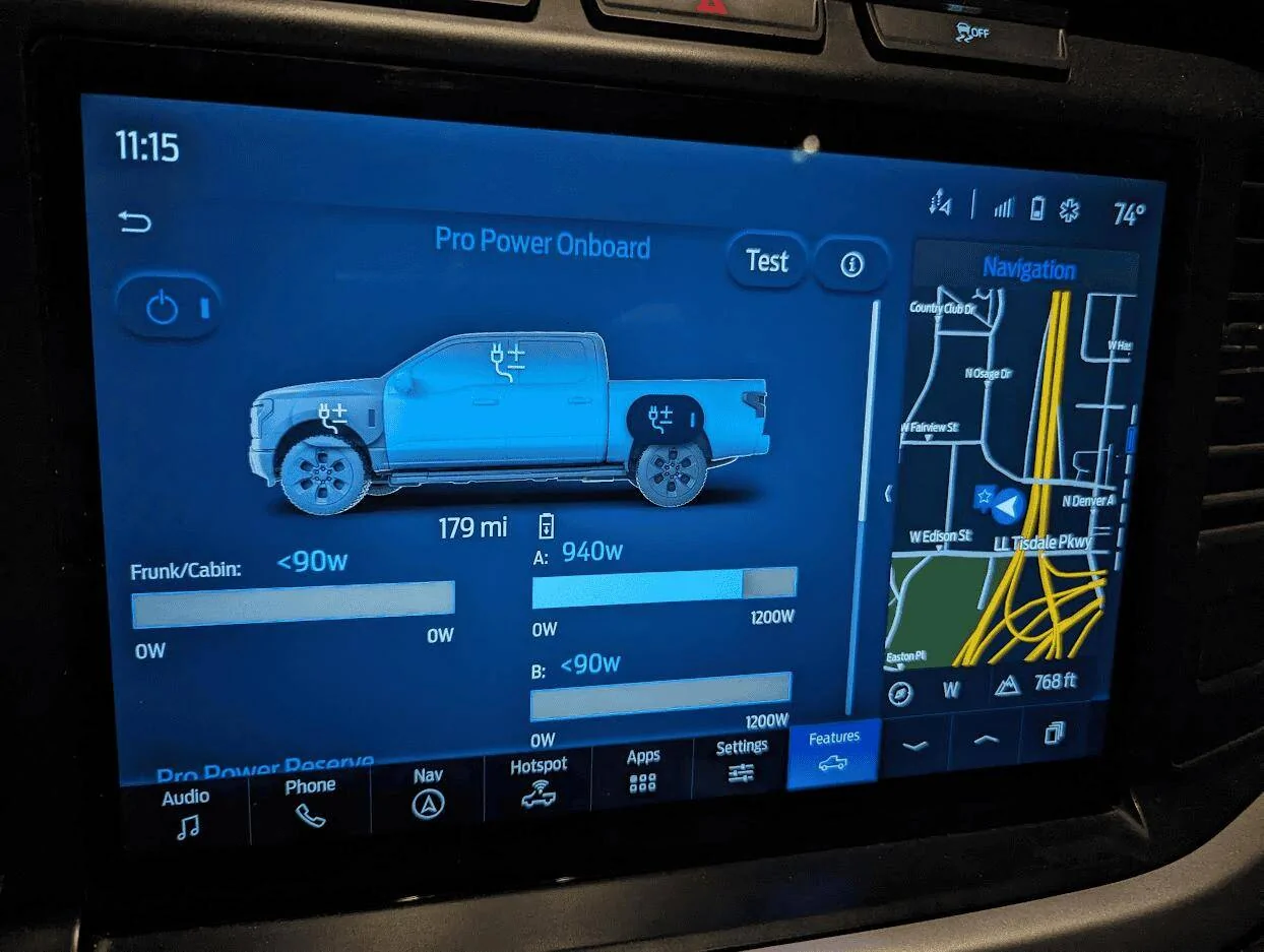

Does this also mean that the house backup feature with the Ford Pro charger will not work on my truck? The features in the console say that I have Pro power on board, and it warned me once that it shut it off because the battery was too low.
You may have the Pro Power Onboard 2.4 kW. Here is what I found doing a search:
2.4 kW: Ideal for medium-duty appliances and worksite tools.
7.2 kW: The ultimate power solution, capable of handling heavy-duty equipment or serving as a backup power source for your home.
Pro Power onboard 9.6 kW has a 2.4kW inverter for the Frunk/Cabin, and a 7.2 kW inverter for the rear supplying a total of 9.6 kW.
You can also tell by looking in your console screen:
2.4 kW:
Ford F-150 Lightning NEMA L14-30P  missing  Flash 1736878644041-zt
9.6 kW:
Ford F-150 Lightning NEMA L14-30P  missing  Flash 1736878660238-ac

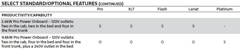

I should have added in my first reply that Ford offers two version of ProPower for the Lightning. So your dealer was correct if they said it had ProPower.
2.4kW Pro Power Onboard – 120V outlets: two in the cab, two in the bed and four in the frunk, Standard on all trims but Platinum for 2024.
9.6kW Pro Power Onboard – 120V outlets: two in the cab, four in the bed and four in the front trunk, plus a 240V 30A outlet in the bed. Standard on Platinum, optional on all other trims for 2024.
