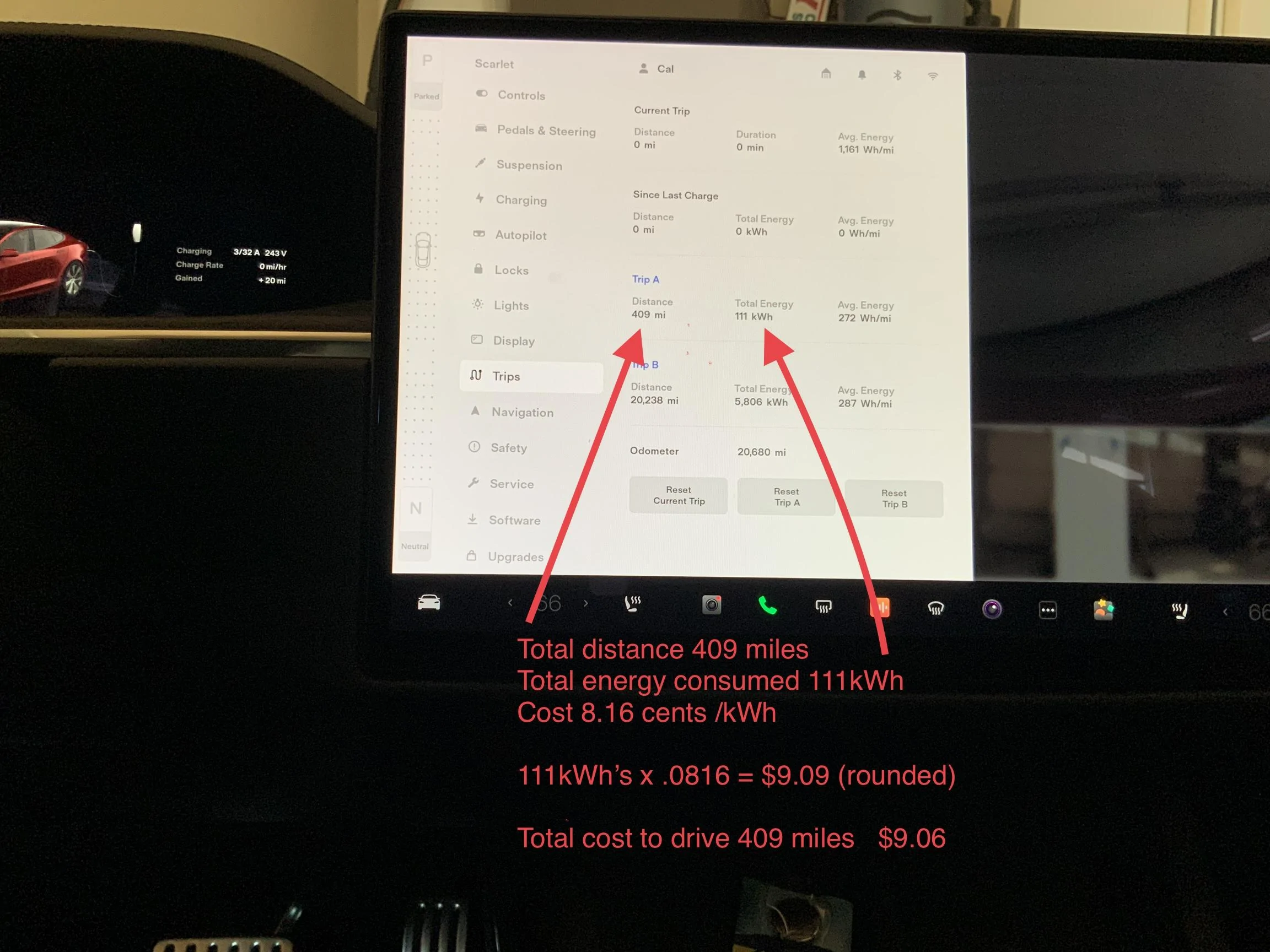

I’ve owned Tesla‘s for years and was amazed when I discovered how efficient and cheap an EV is to run. It was something Tesla promoted in their stores and I was real doubtful but the wife really liked the car and the acceleration was incredible so I bought in. Later when I actually got around to doing my own research… well I was pleasantly shocked. My monthly electrical bills were so close to the my pre Tesla bills that I had to look closer.
Back in 2014 my wife was visiting a skin cancer clinic in Portland OR. It was 62 miles round trip. It took 21kWh’s to make the trip. I pay 8.16 cents per kWh. All you do is multiply the number of kWh consumed by the cost per kWh. .0816 x 21 = $1.71. This realization changed my life. I would take the Tesla on every trip into town. Something that would cost me $5 in gas on my Tundra would literally be pennies on my EV. Truck annual milage dropped and we started racking up miles on the Tesla. When we took trips hotels would let us charge for free. It’s just another way to get us to stay there. A couple of bucks to let this guy charge was nothing.
Here is a snapshot of our current Tesla charge log. Pretty easy to calculate energy usage and cost.
Ford F-150 Lightning Does anyone know how to calculate the actual cost of a Lightning’s energy consumption? IMG_0147
I can’t find anything on my truck or the app that tells me how much energy I consumed on a trip or even what was added on the last charge. The FordPass app has a charge log section that is completely worthless. Telling me I added 4% or 25% tells me nothing about how much energy it took to get that %.
I know I must be missing it somewhere. This is actually a big deal in owning an EV. Impossible that Ford would have missed this.
