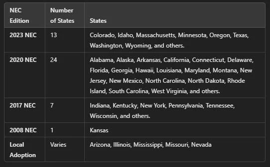

If your charger is already installed it is not required to meet the newer code, you are grandfathered in. Additionally, the 2020 NEC does not apply to every state. Virginia recently adopted it and other states have not. Some states are on 2023.

The 2020 NEC where this appears has been approved and shipped since 2020. What may be happening is your state deciding if they want to adopt the 2020 NEC?
What’s being discussed here is the change proposed for 2026 that would require all branch circuits for EVSEs to be GFCI protected. 2020 did not require GFCI protection for hard wired circuits installed indoors.
