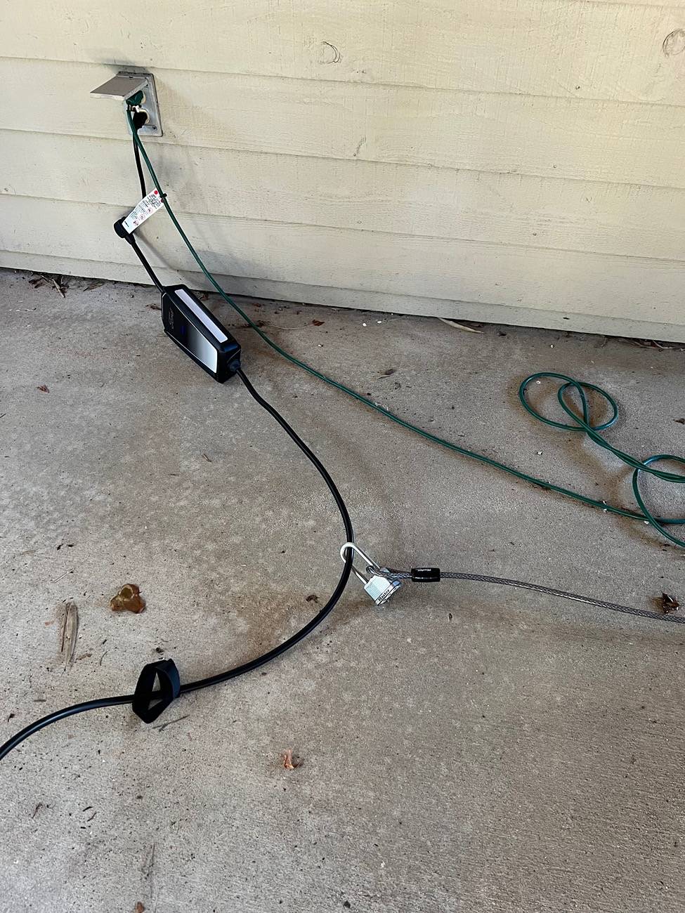

2. I’m not sure what you are asking. You should be getting the free home charger so it will be permanently mounted for charging at home. If you are talking about the mobile charger that might have come with the truck that is for use when you are away from home. When I’ve had to use mine I loop a security cable through the tow hook and then padlock the cable to the end. They could still take the dongle but not many people would even know that’s possible.

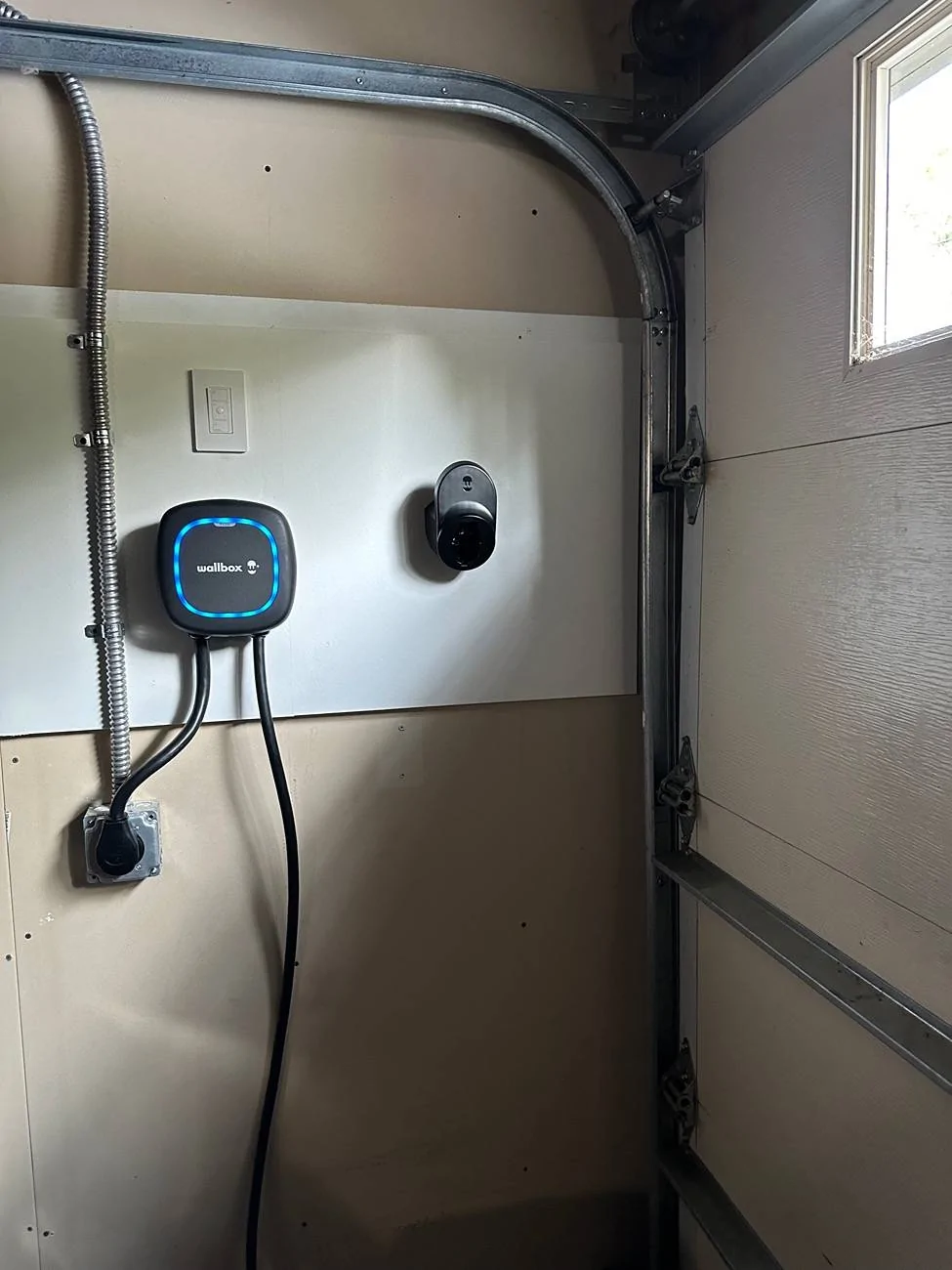

Assuming you have a garage, you can do what I did and keep the charger in the garage and run the cable under the door. There is a specific device that you need to get that is about $60. The link is below. In addition on Amazon, you can get the appropriate rubber pieces for the bottom of your garage door so that everything sits flat. It’s dark here at the moment, so I can’t take pictures of the door while it’s closed. However, I can tell you it works out incredibly well and I have no safety concerns.
Undoor
https://a.co/d/iDgCHst
BOWSEN Garage Door Bottom Seals... https://www.amazon.com/dp/B01IFKFVBO?ref=ppx_pop_mob_ap_share
