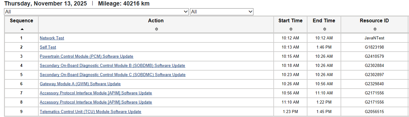

A forum member recently told me they had issues with trying to get any updates done last weekend because FDRS just wouldn't write the updates. I believe he said he was using the latest 46.5.5 version (I'm still one version behind at 46.5.4)....that said he contacted the helpdesk and I believe got a refund or some accommodation for FDRS not working.
Now this morning I see a message about the selftest mechanism not working in the 46.5.5 version and the fact that it will be fixed shortly.
Ford F-150 Lightning Lightning Software Updates using FDRS DTC_FDRS
So this could explain what happened. If you press the selftest button...but the selftest doesn't actually run the routine to clear the existing DTCs......when you then attempt to program an update it won't work, because of existing DTCs for that module. But you won't know that that's why the update failed.

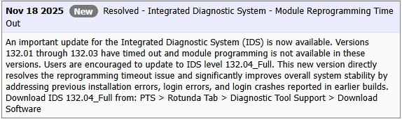

The other thing was a note about IDS....now I know our trucks are new enough that we use FDRS instead of IDS....but for those who occasionally have a need to work on something older, they've just released a new IDS version (full, not patched) that is supposed to fix what a mess 132.01-03 had become.
Ford F-150 Lightning Lightning Software Updates using FDRS IDS-132-4
