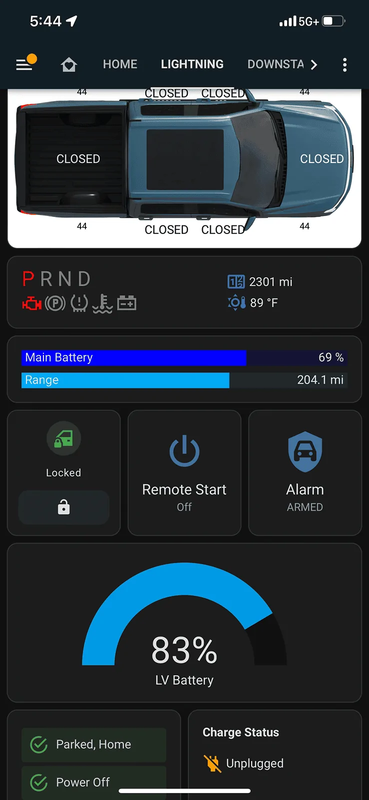

I haven’t driven my truck as often the last few days as school just let out, and my normal routine of school and soccer drop offs has thankfully let up for a couple months. I noticed my battery level had dropped to 35% as I periodically check it in Ford.com and through the home assistant integration. I thought that was weird, as I believe it is supposed to recharge the LVB from the HVB when the SoC dips below 50%. Anyway, @TaxmanHog advised in another thread to run the vehicle to let the inverter recharge the 12v battery. That worked just fine and I was able to get it to 91%. I shut the truck off less than a couple hours ago, and it had already dipped to 85%. Should I be concerned? I didn’t think that the LVB drain would drop that fast. There are currently no loads, as I disconnected a MagSafe charger that I had recently installed in the cubby and the OBD scanner I usually leave plugged into the port. Because I normally started the truck and drove it at least twice a day, my LVB typically stayed in between 80 and 99%. Should I be concerned that it got as low as it did or that it is dropping SoC so fast? Appreciate the advice of this forum!

When I purchased the truck in March the CSP was there. However it disappeared within a couple weeks. I figured the dealer did it (as I asked them to make sure all open recalls were done before I picked it up as I drove 3.5 hours to get it. Anyway, it does not show the CSP on my account. My SoC has always been high, but then again I always drove at least two trips a day. Just wondering what the average “burn rate” I should expect on it. Looks like I dropped about 8% in 3 hours as of now. Is that normal?

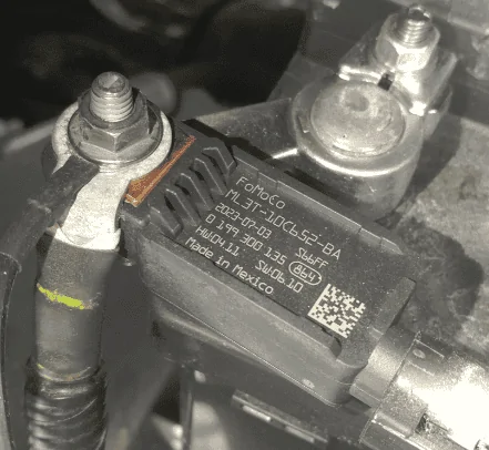

I will have to check those threads to see the new part number. I agree with the dealer aspect, but I’d be surprised if they actually marked it closed unless they did it. As for home assistant that is a good point. It is set to poll every 15 minutes to not make the ford api mad 😆. Also, it has been mostly down due to api changes. I just got it functional again today. I’ll have to keep an eye on it. I had it running for a month or two without issue (I actually keep a closer eye on the SoC when it’s working, because it’s on my dashboard).

I think BMS with -AC or -AD after MK3T-10C652- are bad and any others like -BA are OK.

Yes. I’ve got everything unplugged now. I am going to do some A/B testing with and without loads plugged into the 12V circuit and see what the draw is. Funny enough when I checked my truck just now it was at 89% SoC. Ford was reporting 83 until I powered on the truck then it must have got an update and matched the actual state of charge (at least the one reported through CarScanner). So the FordPass reporting may not always be so accurate. I’ll keep an eye on it. Thanks all for the assist.
