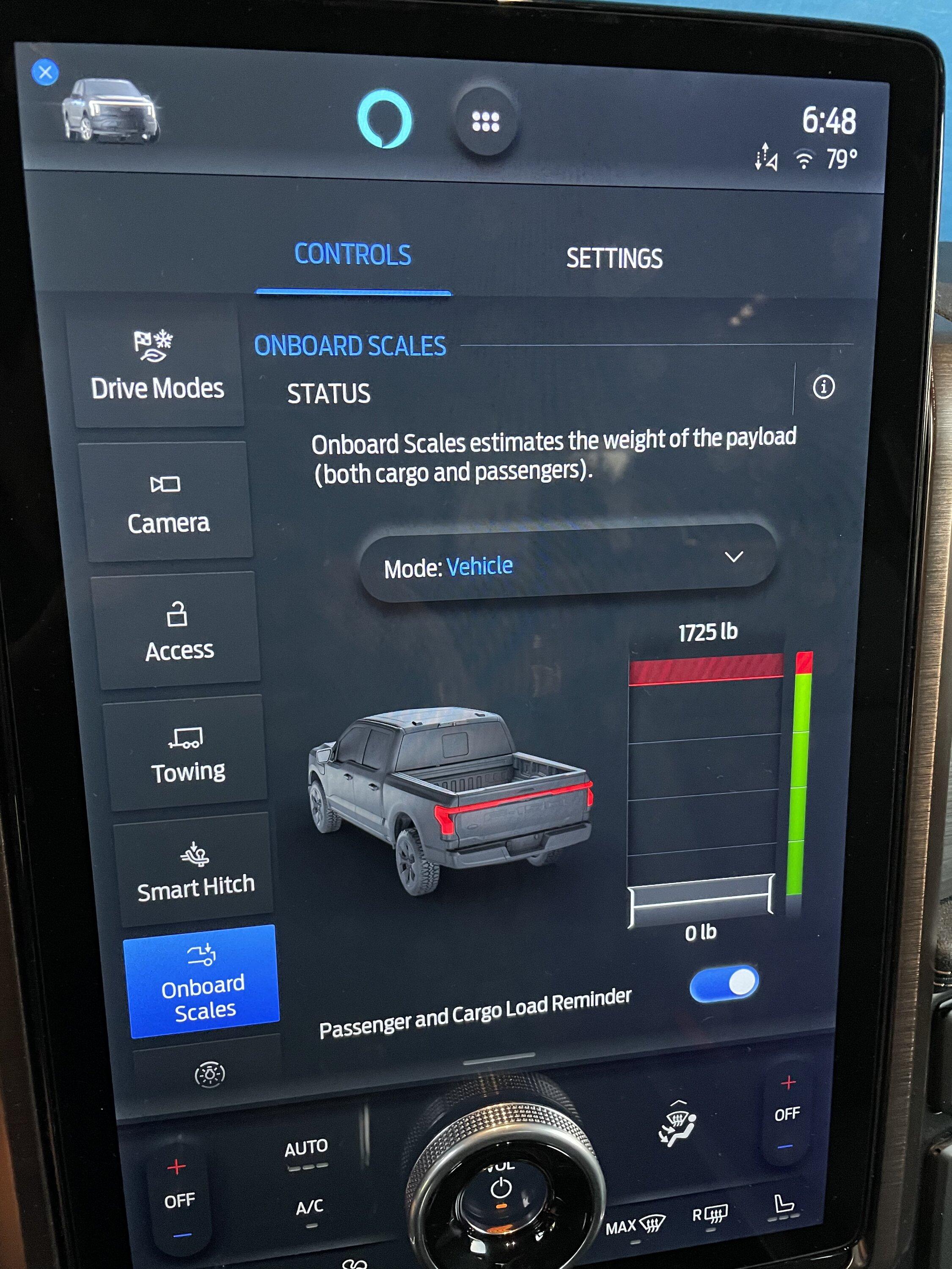

Took a weekend trip with the family this weekend. 2 adults, 3 kids, frunk about 75% full and bed full up to the bed rails. On board scales read 0lbs - anyone else have this issue? Green vertical bar appeared to be working. I also don’t appear to have the scale info in my Fordpass app as others have mentioned (even thought the ford site says it should be there).

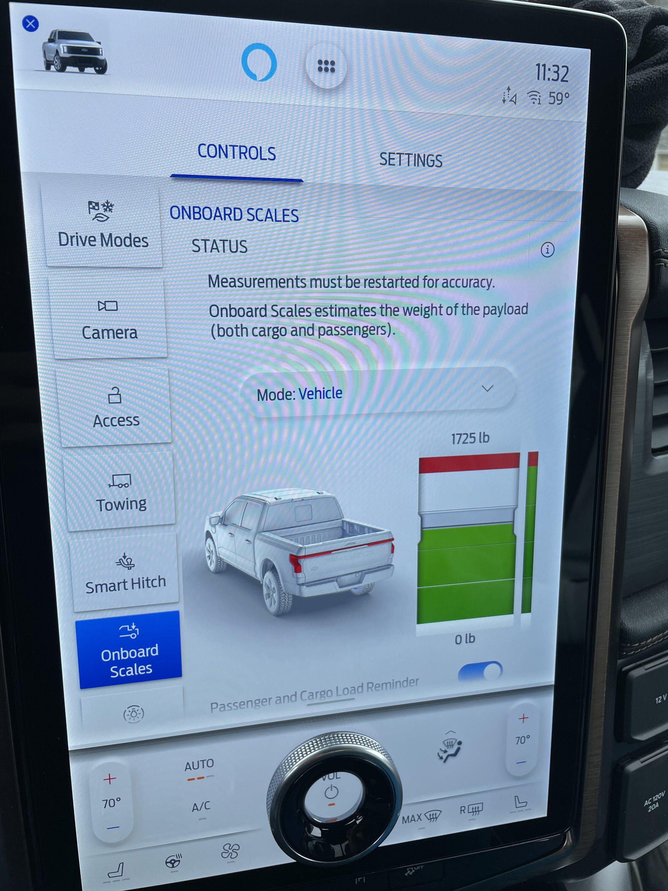

Tried that too; the horizontal scale seemed to be fluctuating a bit but still hovering around 0lbs. Didn’t get a pic of the ‘scale’ screen though when the truck was loaded. Here is what the two screens look like now, unloaded.

Where are you reading zero pounds? On this shot I only see minimum (0 lb) and Max (1725 Ib). Are you saying on Scale mode, you saw zero when it was loaded?
can you reach the screen to reset of you are standing outside?
Yes, In scale mode it was reading pretty close to zero when it was loaded. It was moving left and right a very small amount but should have been quite a bit higher.

When using the horizontal scale, you need to reset it when empty, then fill it up and it should show you what has been added since the "reset".
I may be mistaken, but I don't turn off the vehicle nor leave the horizontal scale screen when I do this, since it has reset as some points in the past.
It's definitely not user friendly, but it does work.

Thanks; it appears my understanding of how the on board scales works was incorrect. The 'scales' screen only tells you how much weight has been added to the 'current' payload. That means if you load the truck with the truck off, it will register 0lbs when you turn the truck on and indicted weight only when weight is added.
