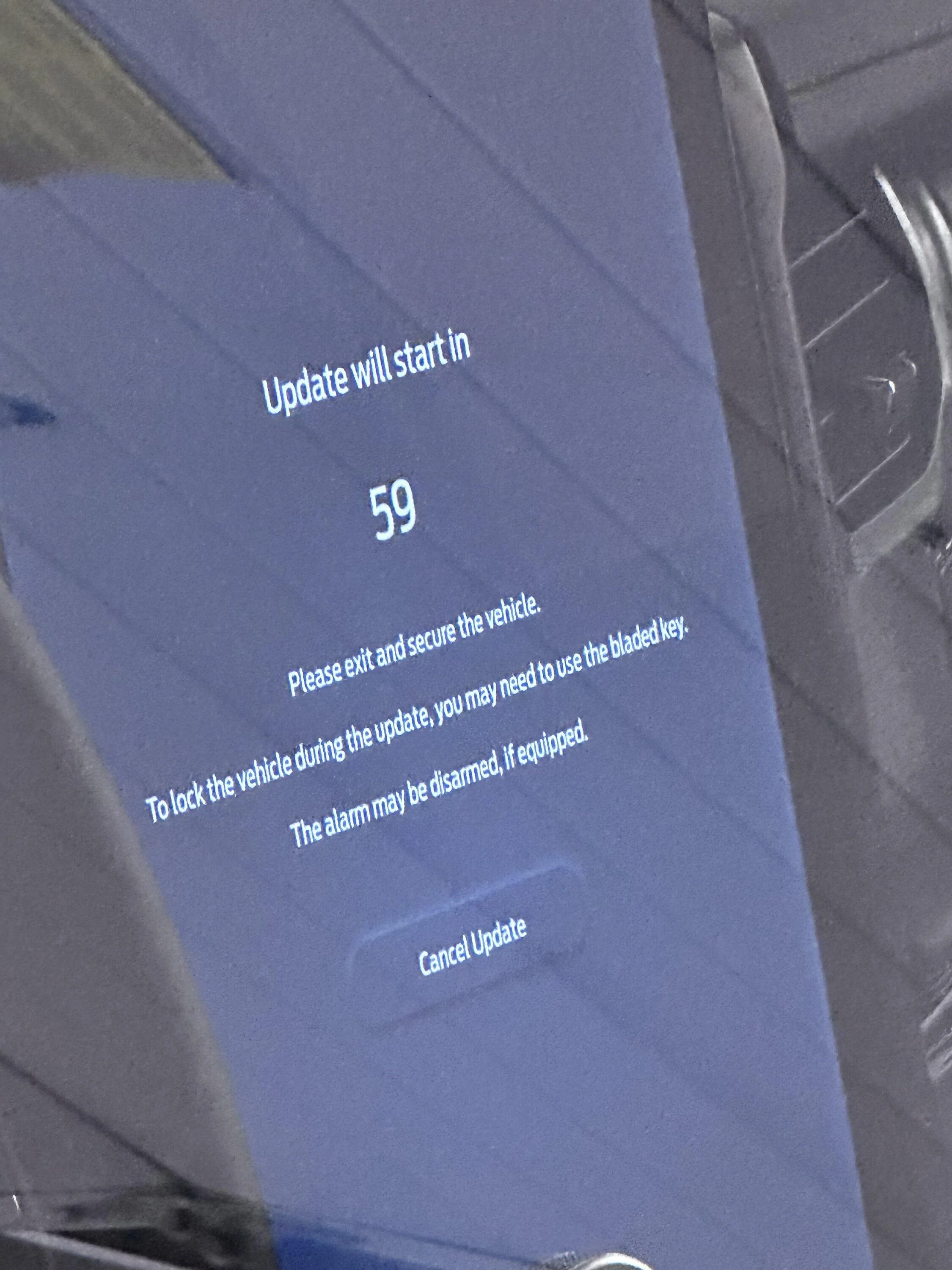

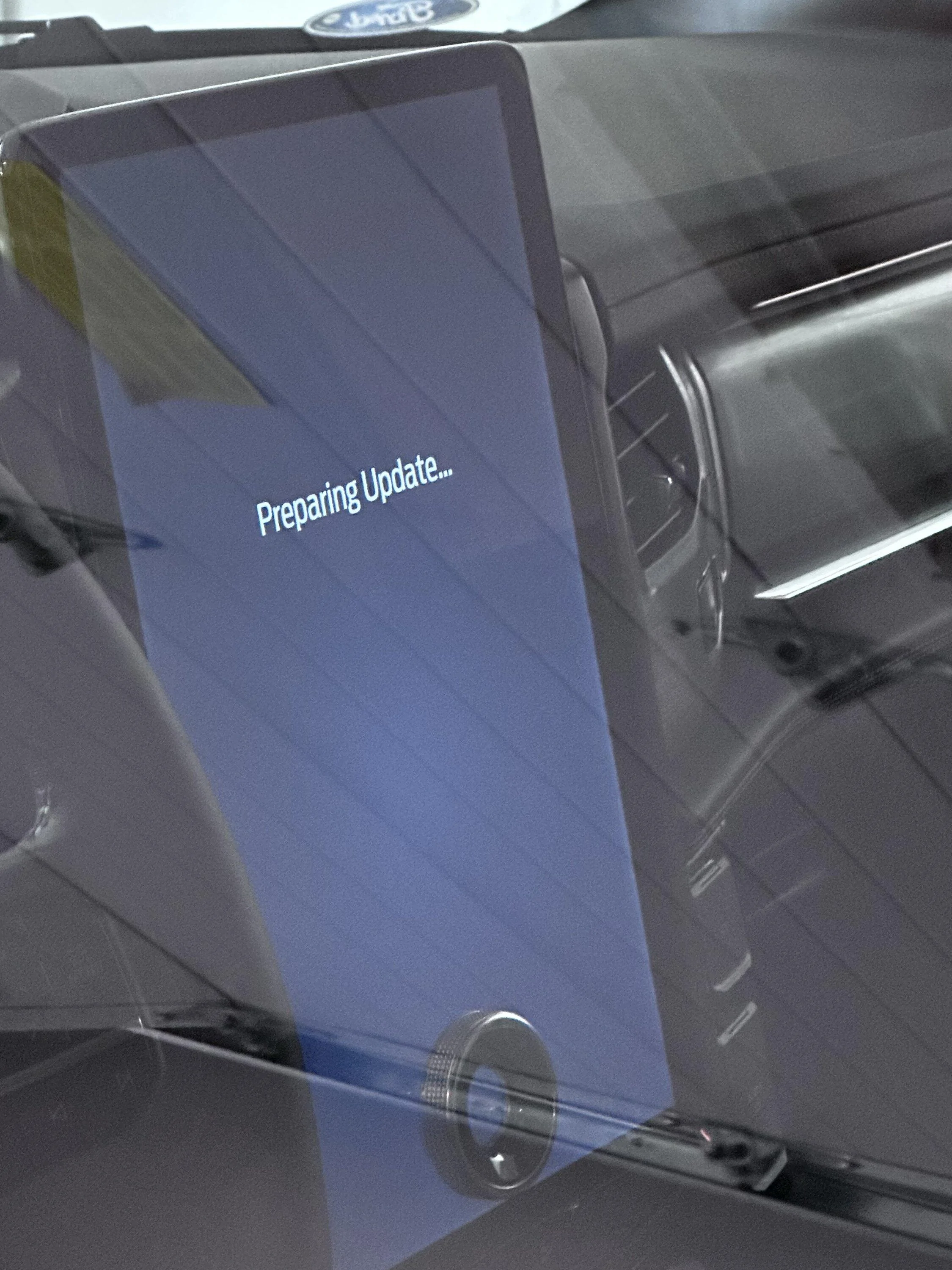

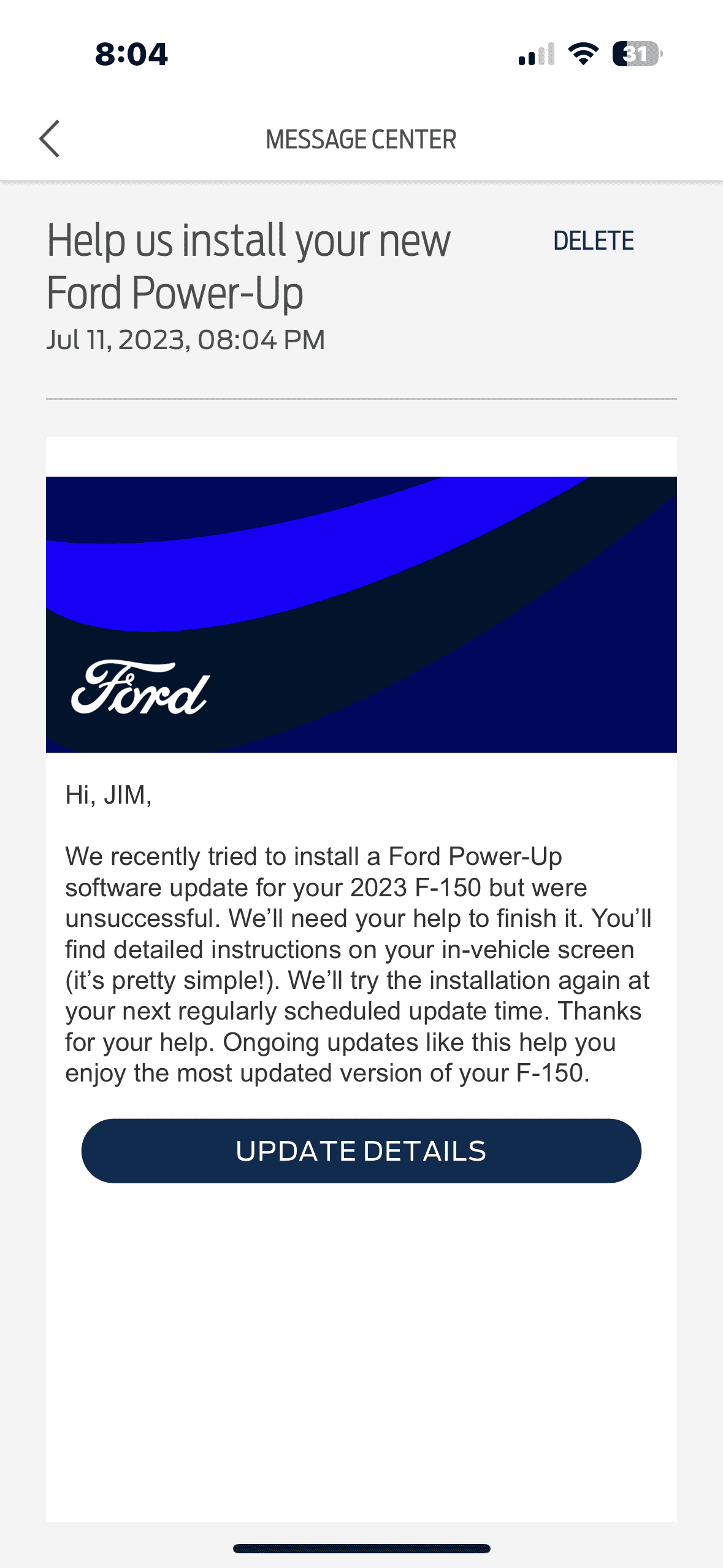

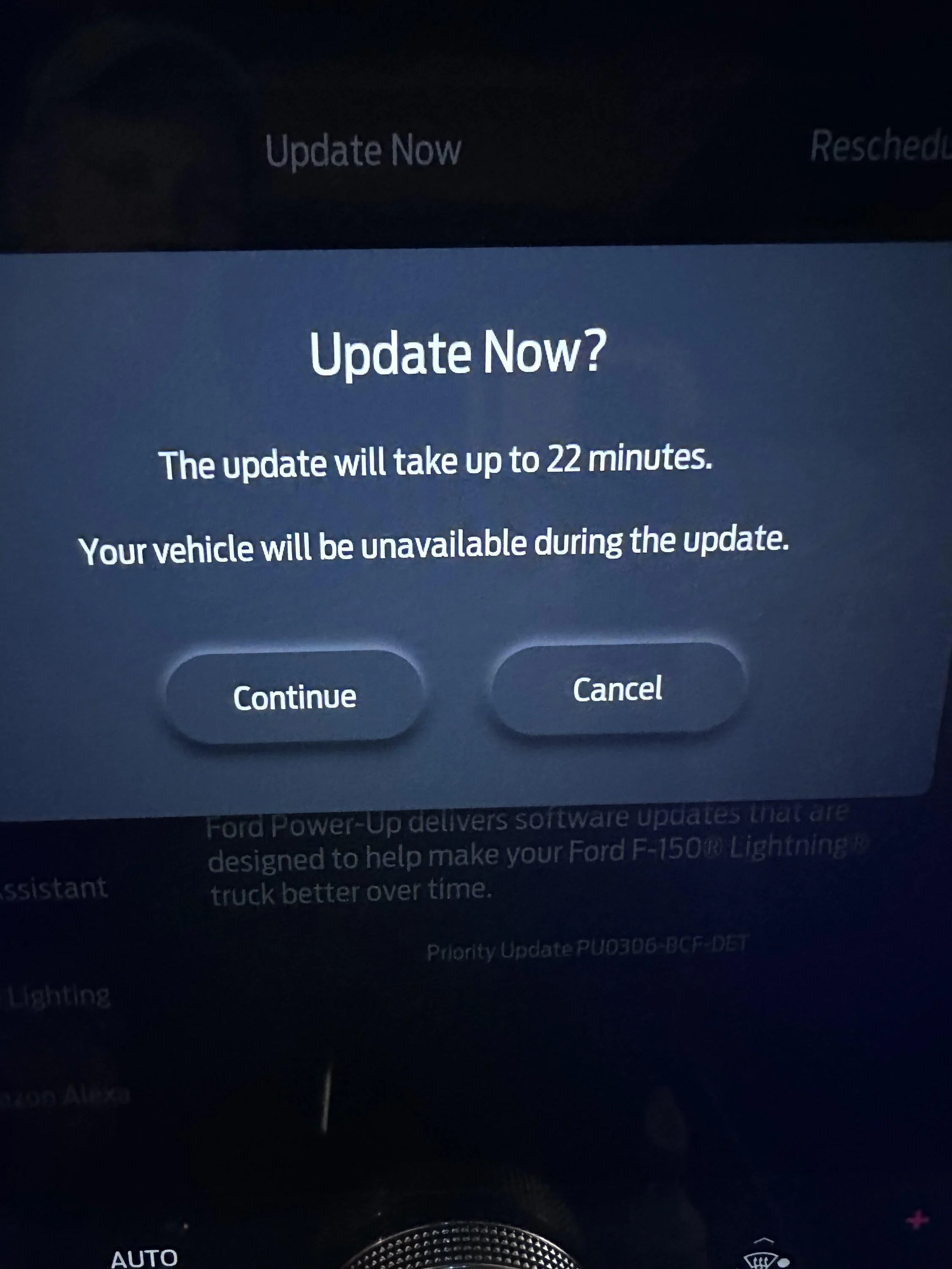

Just wondering if anyone has any suggestions I just got a notification that there was an update pending, but it needed my help in completing I tried to restart the update numerous times it gets to the point where on the screen you can see through the window it says, preparing the update And then it stops and gives me the notice again That the update has been rescheduled and no matter how many times I tell it to do it now it won’t vehicle is at home on Wi-Fi and it’s at 62%. The update is priority update PU0306-BCF-DET. Thanks in advance

After a mostly flawless run of quick and easy power up software updates, the two most recent priority updates both struggled to install (whether scheduled or manually requested) and I had multiple failures over several days. Both updates did eventually install, and in each case it was via a manual update request right after a 30 min drive.
I'm convinced that this is all tied to 12v SOC. There's no reason for mine to be low, but every time I do put it on a charger it seems to take a decent charge. So something is up, and the drive I did before my installs probably helped the 12v charge.
You could try a BMS reset too. Turn on accessory mode (start but don't press the brake), flash your main beams 5 times, then press the brake 3 times. The battery icon on the lower right of the dash should blink and after a couple of seconds should then return to solid.
Thanks for the info! I did exactly what you suggested I did a reset on the BMS and then took it for a 30 minute drive and it updated the second I returned home.

I had trouble with failed updates too and this is the last set of instructions that worked for me:
1. Make sure 12V battery is charged (drive for 30 minutes first)
2. Charge to at least 96%
3. Turn Lights off (not Auto)
4. Apply Parking brake
5. Lock doors
5. Lock doors
Thanks, I've tried everything but 2. I assume you mean to charge the HVB to 96% or above? I have mine set to 85%.

I have mine set at 85% too which is apparently why the update wasn’t working. When I charged to 96% the update processed fine. Let me know if that works for you AdventureBoy.
The only other thing that I did when the update finally went through , and I have no idea if it helped but you could try turning your phone off if you’re using phone as key. Turn your phone off or keep your key fob away from the vehicle as the vehicle tries to wake up anytime, you approach it or near it
Will give that a try too. I had to turn off approach lighting since it is tied to the deployable running boards. Every time I walked by the truck, it lit up and flapped its wings trying to fly like a penguin.
