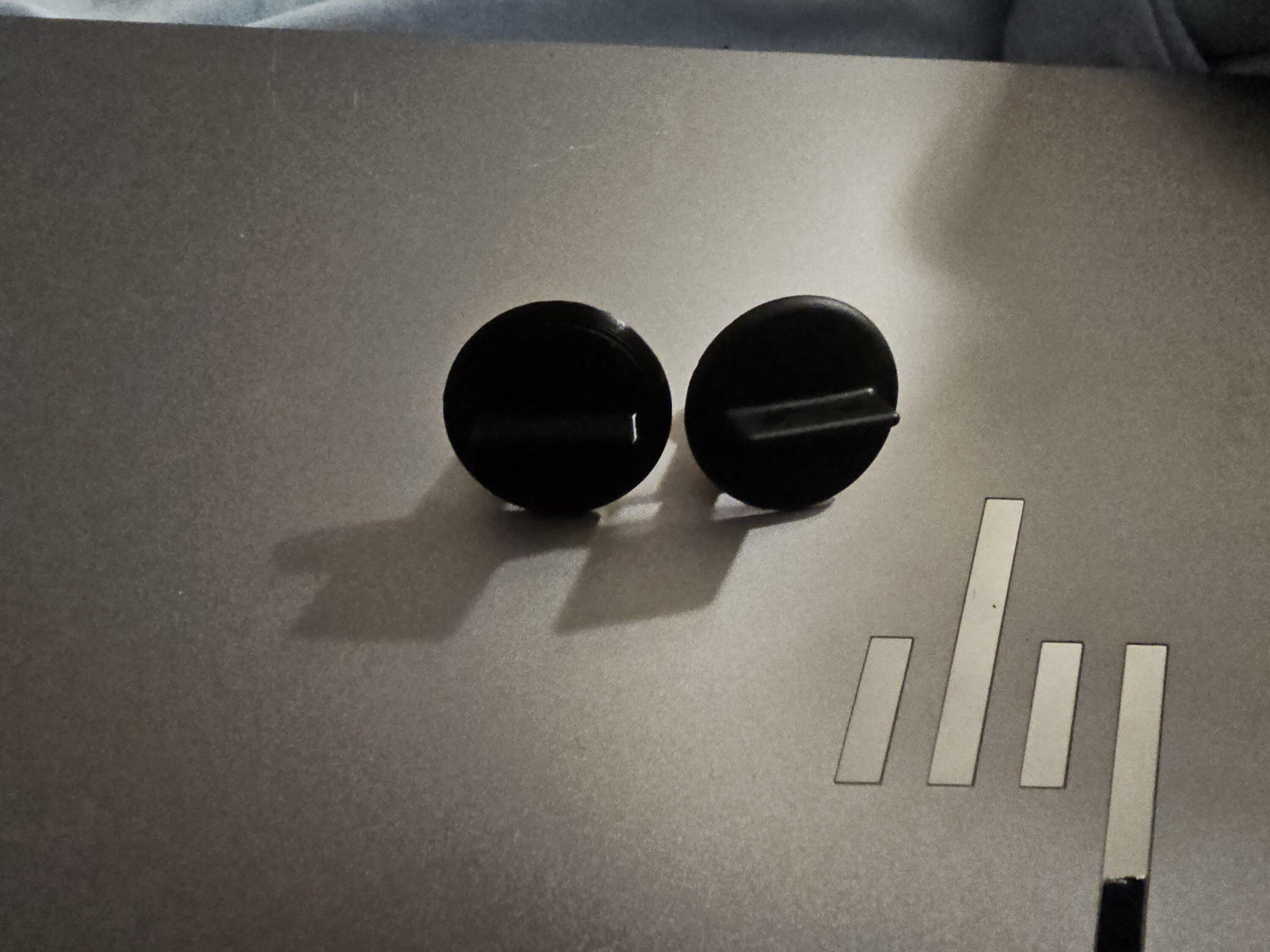

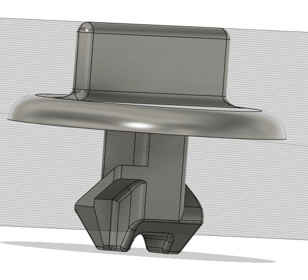

It works. Looks like I can't post the video here, but I can twist it in and it holds. I had to make it a bit longer, so if you've already downloaded the files, you'll need to grab them again.
Awesome! How did you orient it when you printed it? I assume it will need to be printed with supports. Also, 100% infill?
I actually printed it just like it would be installed with the handle part up so that the support interface wouldnt be visible when installed. Tree/organic supports on the build plate only. I didnt need one (now I do of course) so this was just PLA 5 walls 25% infill. I'll be doing another at 10 walls, 75% infill in ABS to replace the one I just broke.

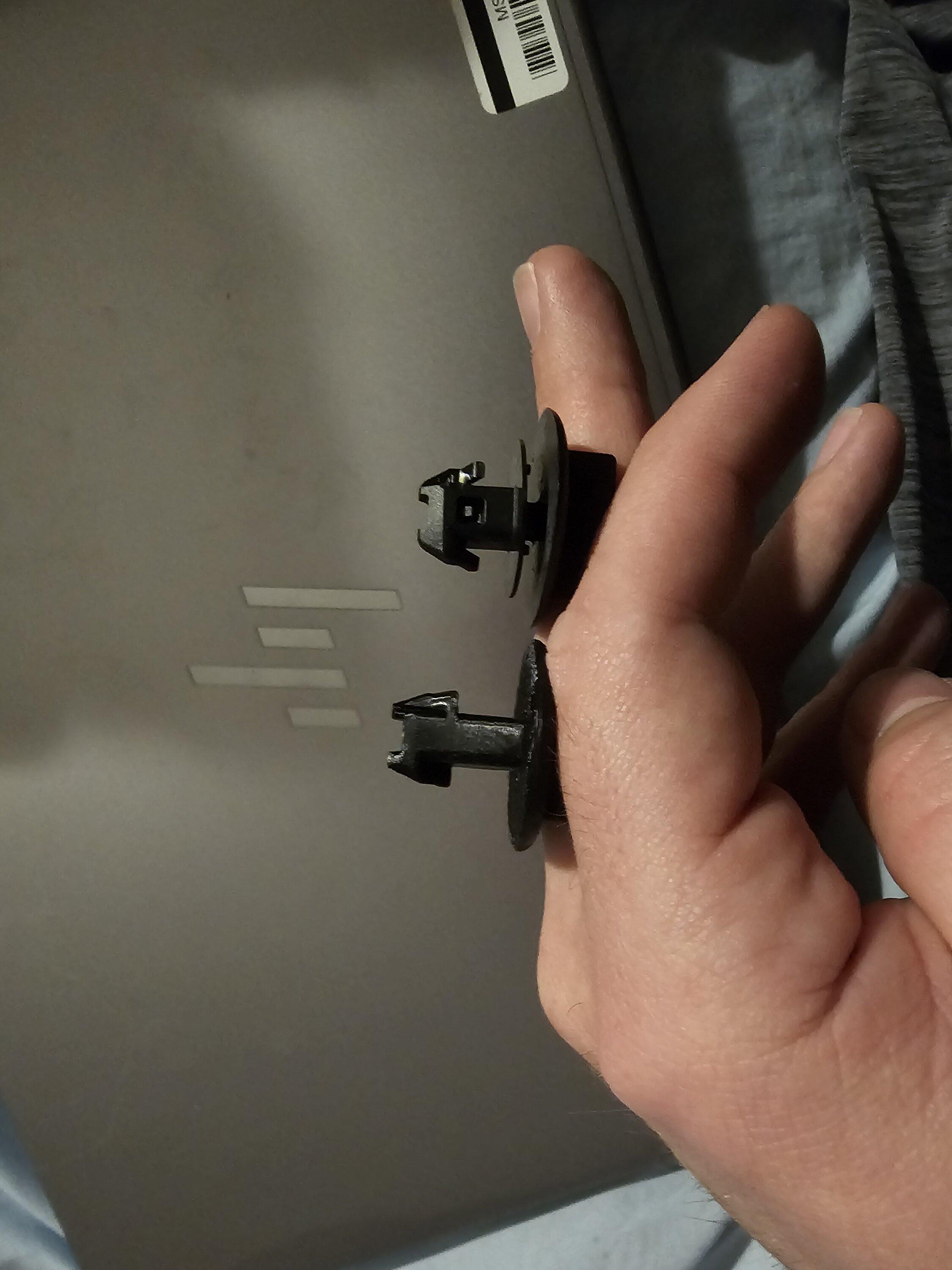

Smaller ones are available in a pack of 4 I believe... the bigger clips are part of the entire panel.
Did this change?
No it didn't change, have to purchase the entire cover. Here is what I did at least for now.

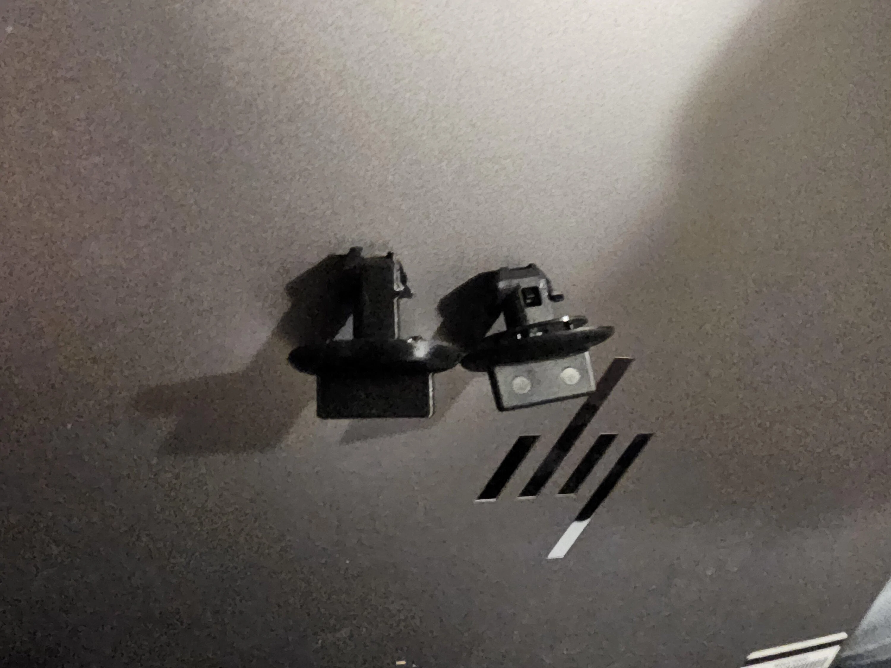

Did this change?
It has not changed yet. That request has gone forward to make those available for purchase separately from what I'm told. No timeline is available. Will monitor and report back.

Oh and BTW...due to the design of these fasteners (either the large ones or the smaller ones) you should try to remember to only turn them clockwise...to latch or unlatch. If you look at the cam on the bottom it's designed to only be turned in one direction. Turning it counter-clockwise will put strain on the small shaft of the inboard larger headed two-piece fasteners and wear them out sooner.
The fasteners go into a rectangular slot on either the top fender edge, or one that's been cut into the frunk tub edge. So just turn the fastener clockwise to lock it...and then turn it 90 degrees clockwise to unlock it again.

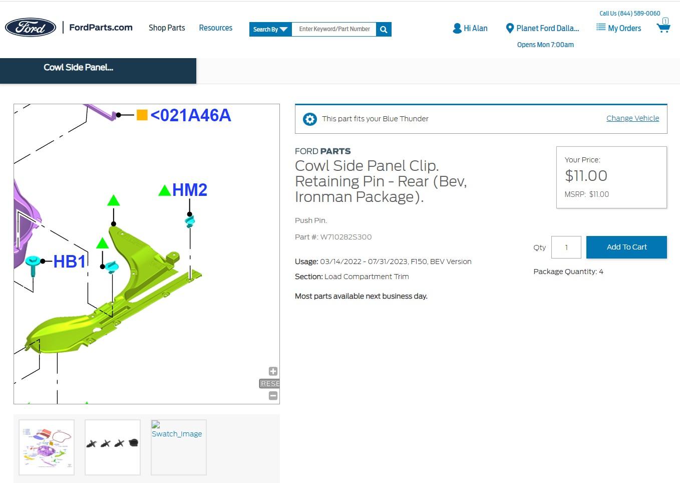

1. The small clips can still be ordered as a four pack.
2. The panel comes with all the small clips, all the big clips, and the bases/receiver portion of the big clips.
To my knowledge these are the only two ways clips can be ordered, and only the second option provides big clips.

Any chance you know the part number for the small clip 4-pack?
