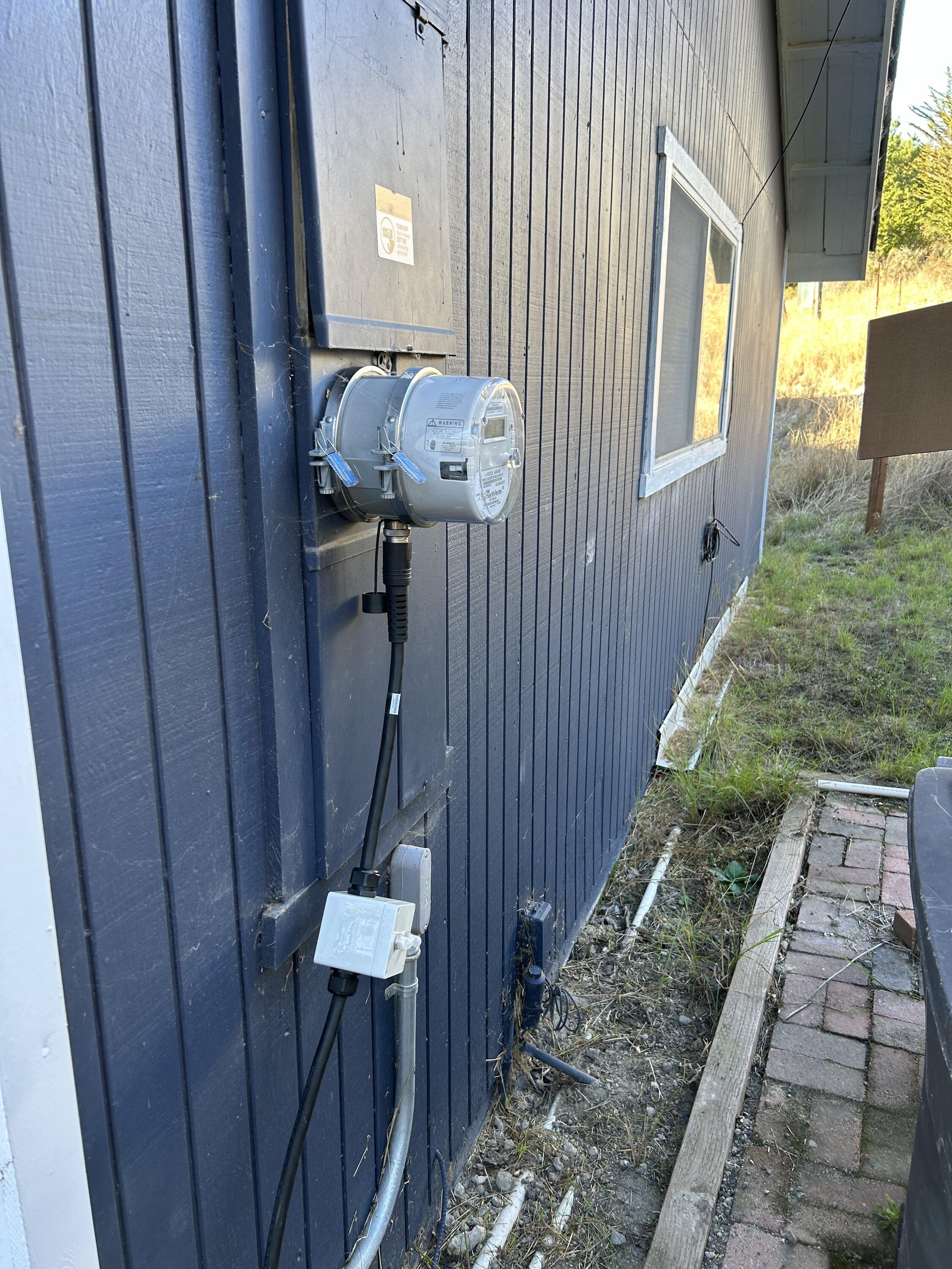

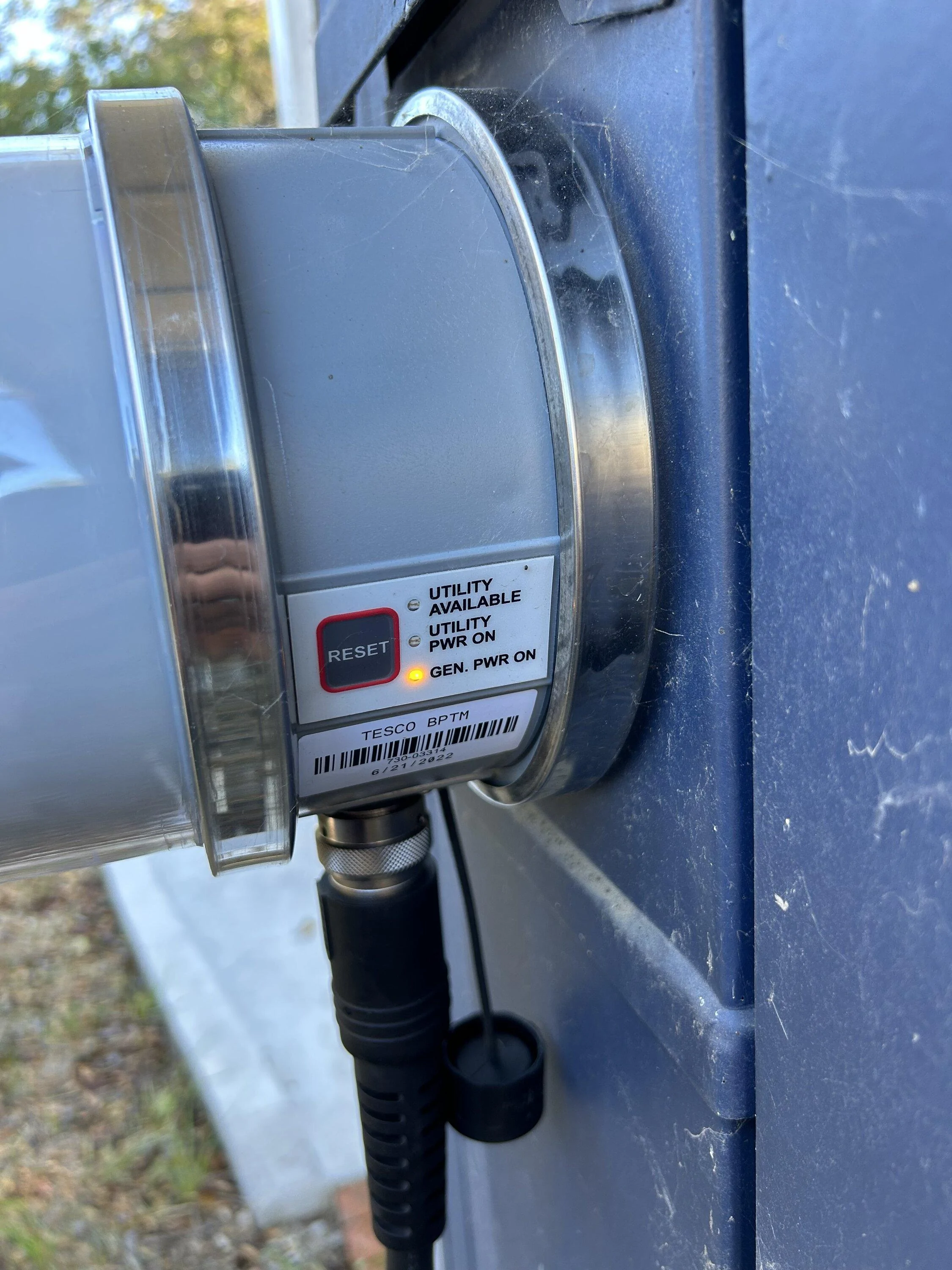

The installation is simple - they pull the meter, install the device, then put the meter back on. Maybe 10 minutes if they go slow.
It can be purchased for $999 from the company (but you can't install it in DTE's territory), so DTE is covering the cost in 3.6 years, with no option to buy it.
PG&E sees the benefit in consumers shouldering the load in times of outages, so they provide it for free. DTE always wants a lot of profit.
