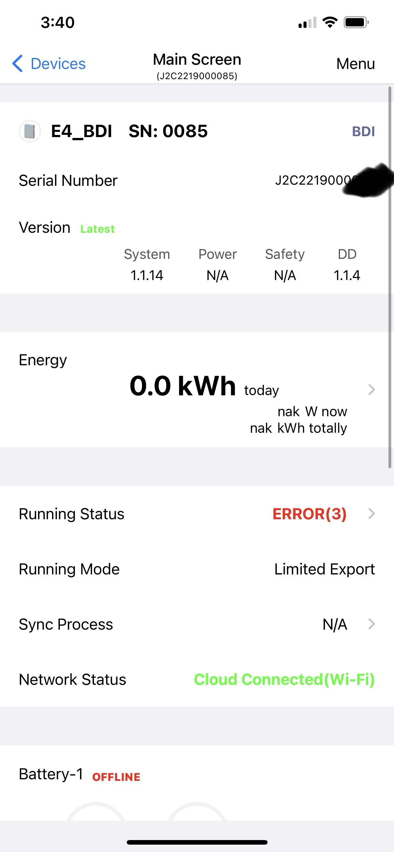

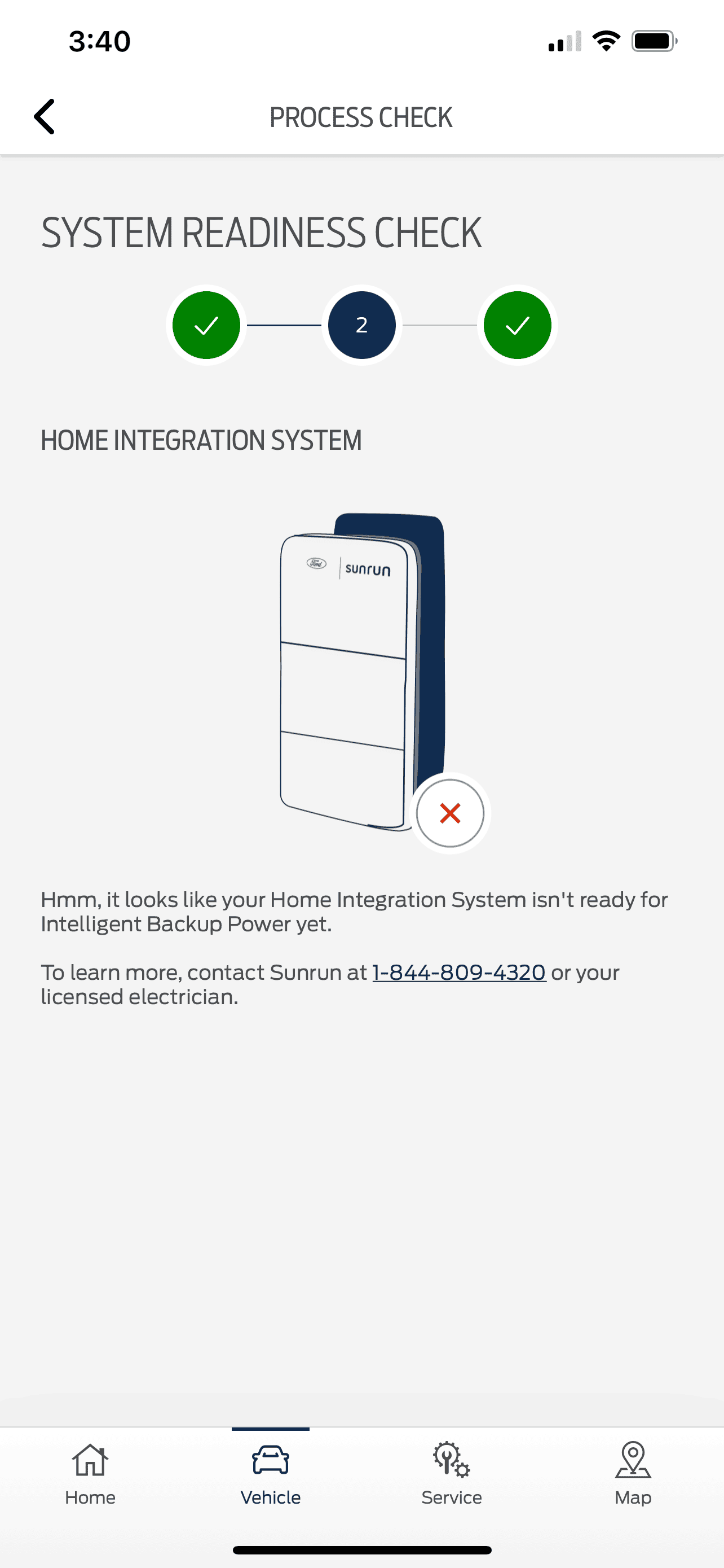

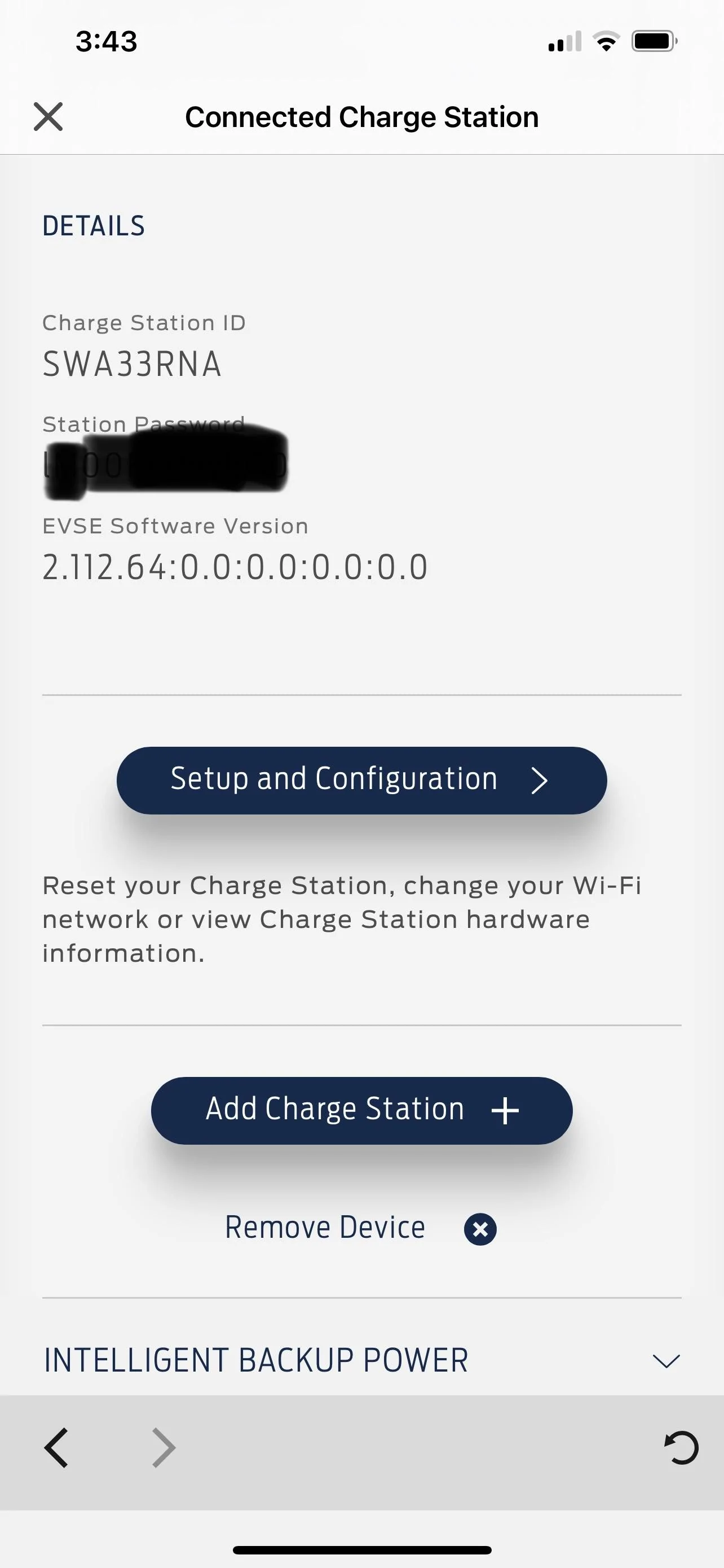

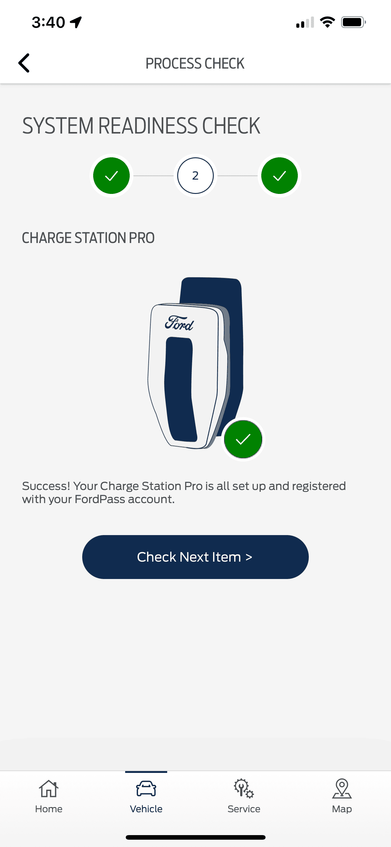

Aside from a delay in my solar install which was done last week which was holding up my charger installation (pay the electricians once, right?!), we (the electrician and I ) are deep into this now. We have both gone through the SunRun SOP Installation documentation and have the M Professional app, etc... The hardware is properly connected. The charger is working (its not yet received the update, but fingers crossed that happens soon so I can stop receiving those messages). Its set at 80Amp BTW. I have the charge station pro connected to my account and ready to go. I have the HIS installed and added to my truck and it shows it. The only thing that is missing I believe is the connection the FordPass app because when I do a system check, it says the HIS is not ready. I honestly think thats the only thing... SO frustrating... After spending roughly $7500K for emergency backup with the truck, it's held up due to software... Can you help @Ford Motor Company? I will follow with the pictures...

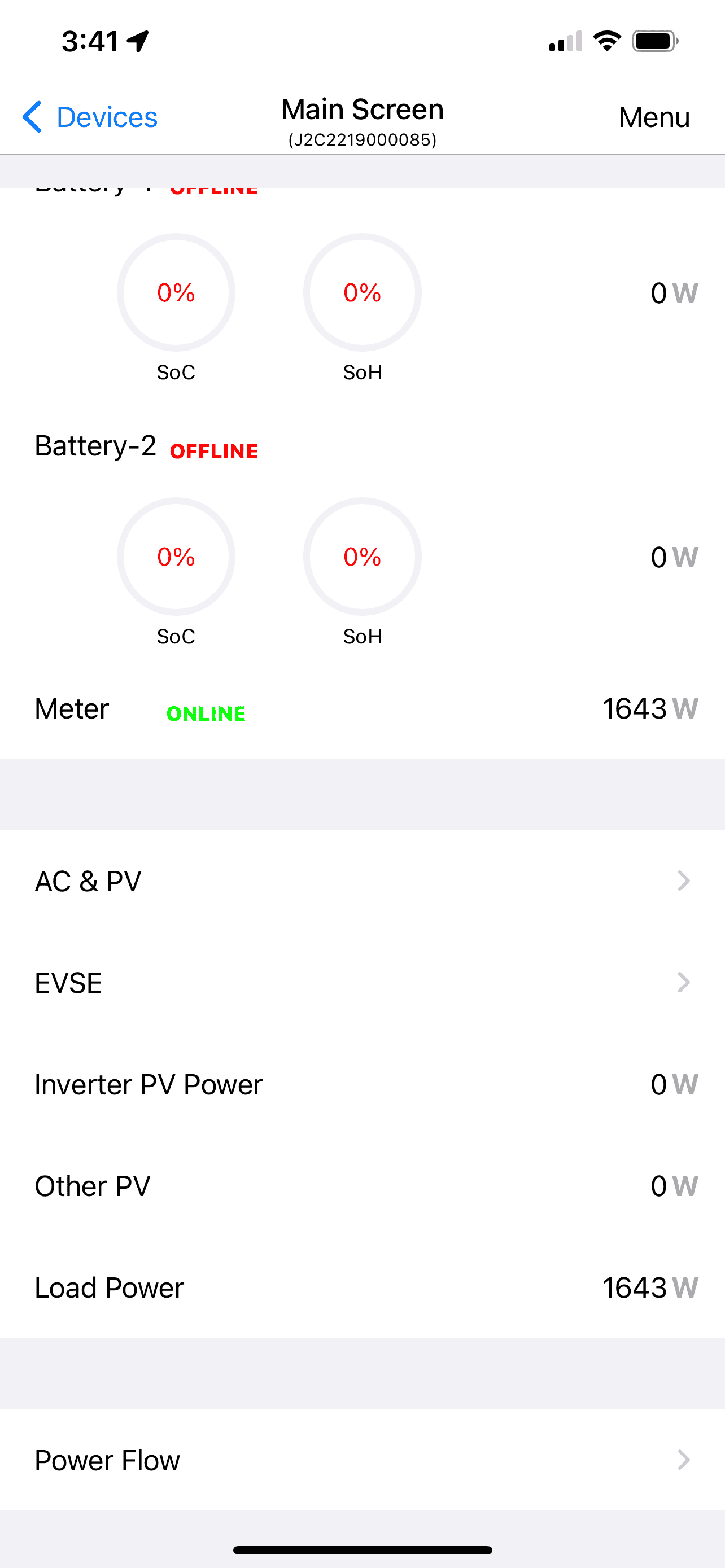

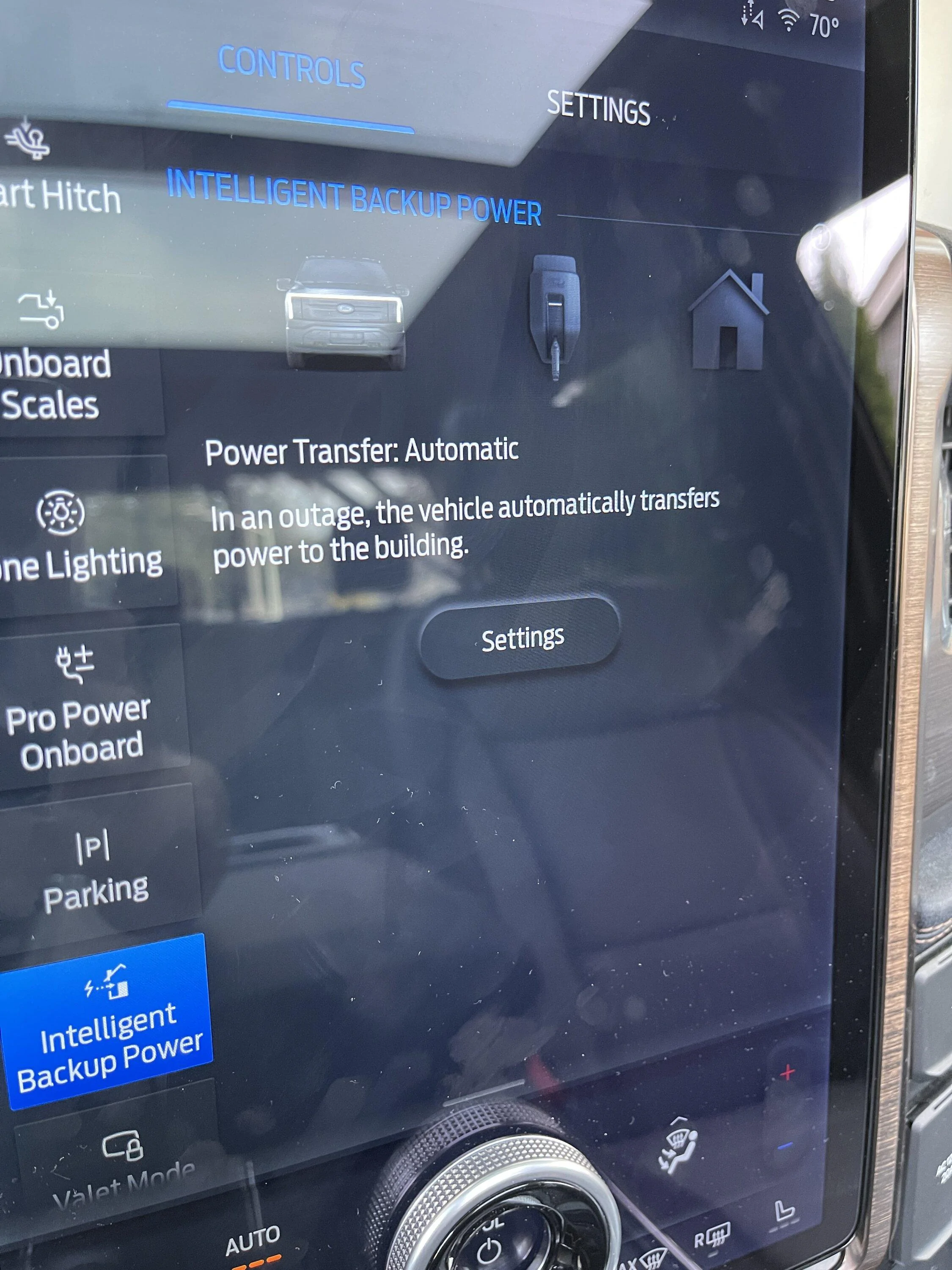

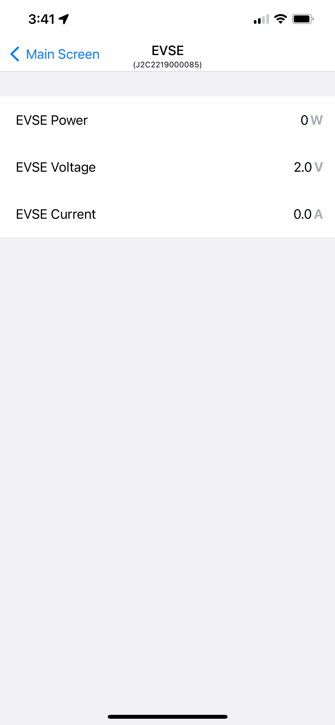

Software screens…

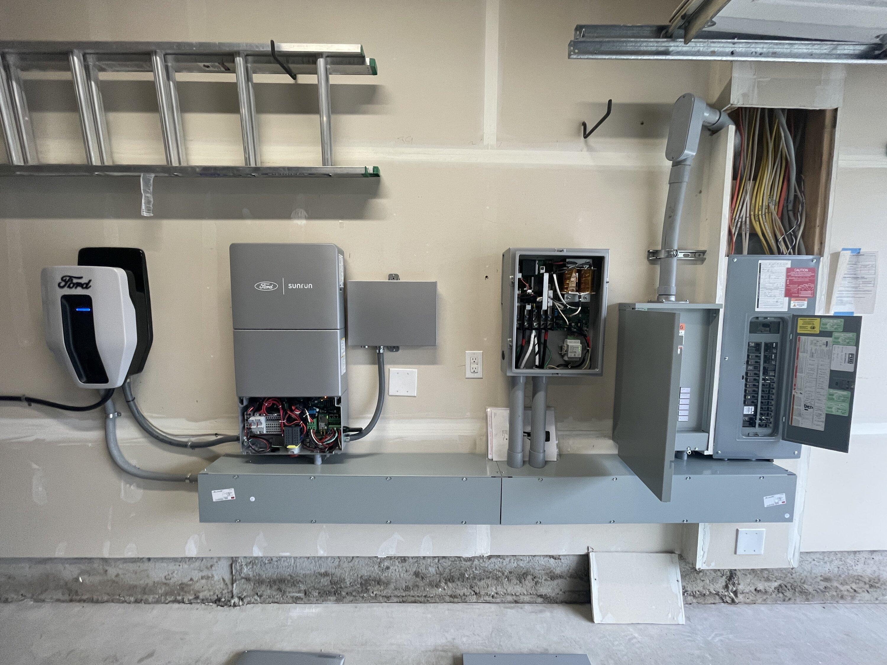

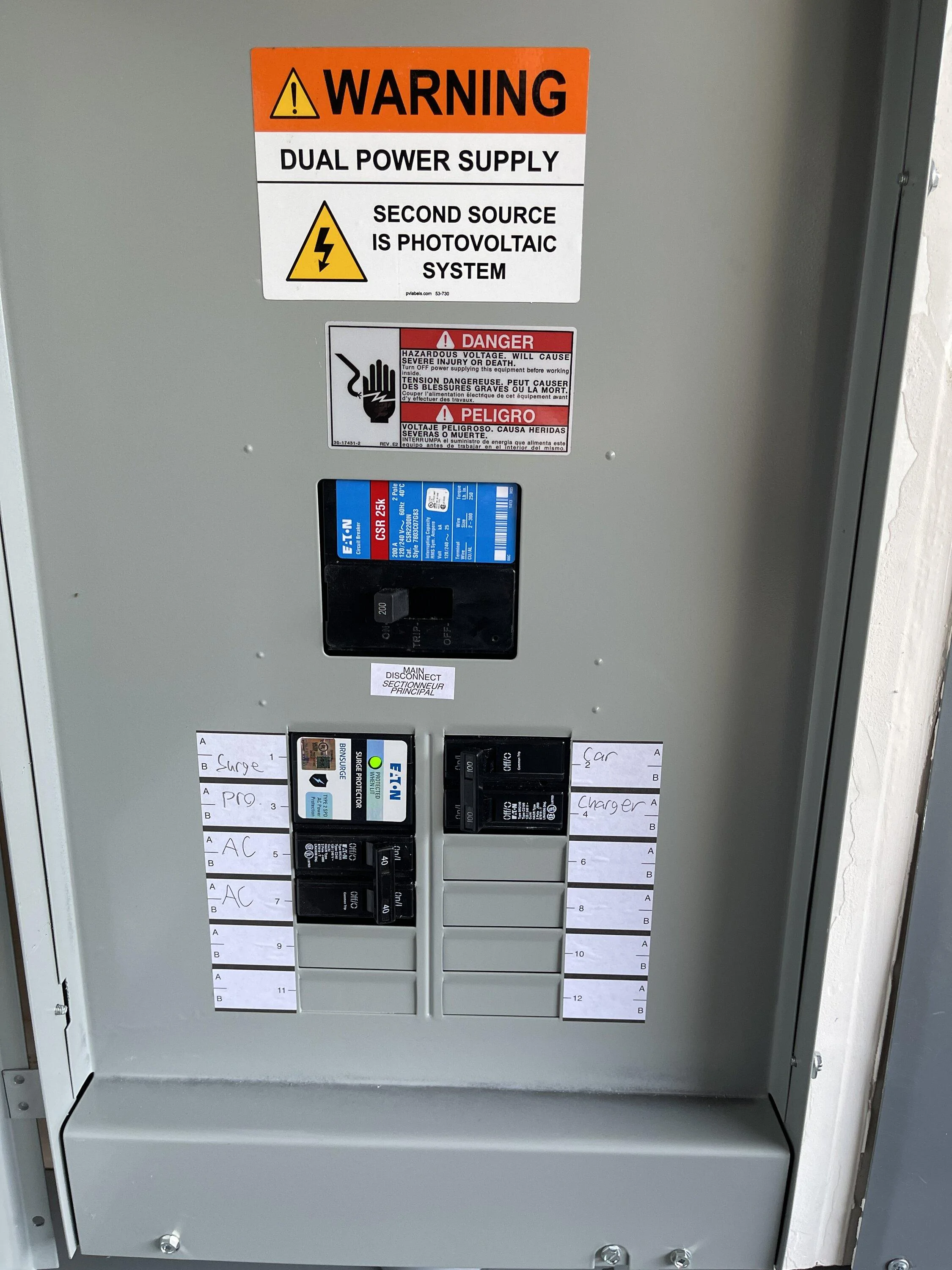

Looks great, sad about the SW hold up, but at least the physical work is complete.
Where are the critical load breakers/panel?

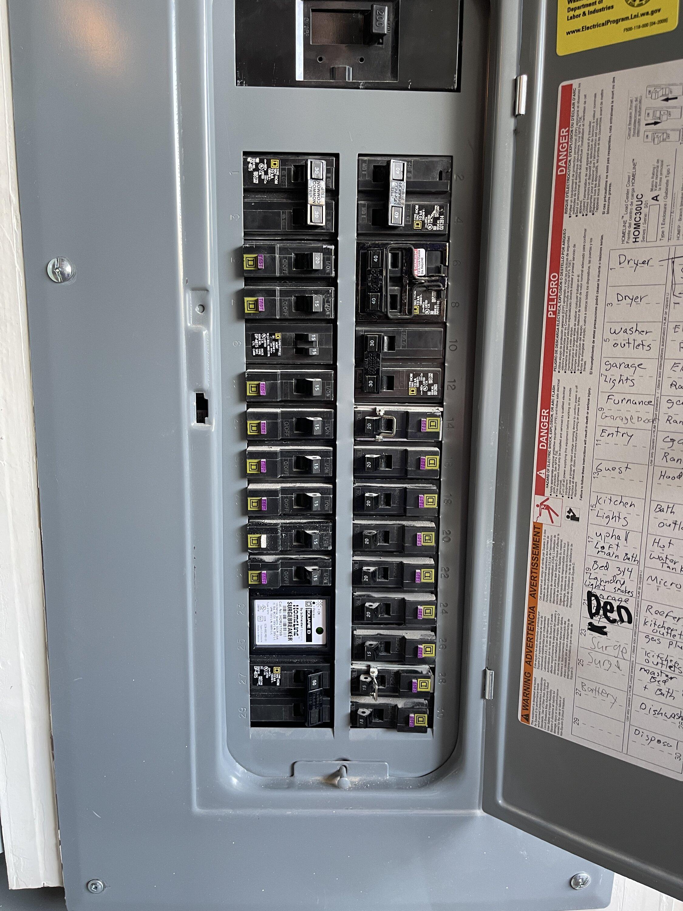

'22 F-150 Lightning Lariat, 2012 RR Sport HSE
So the added panel to the left of what looks like the main panel is technically the main. It has only the ac and the car charger on it. The critical load panel is basically the old main.

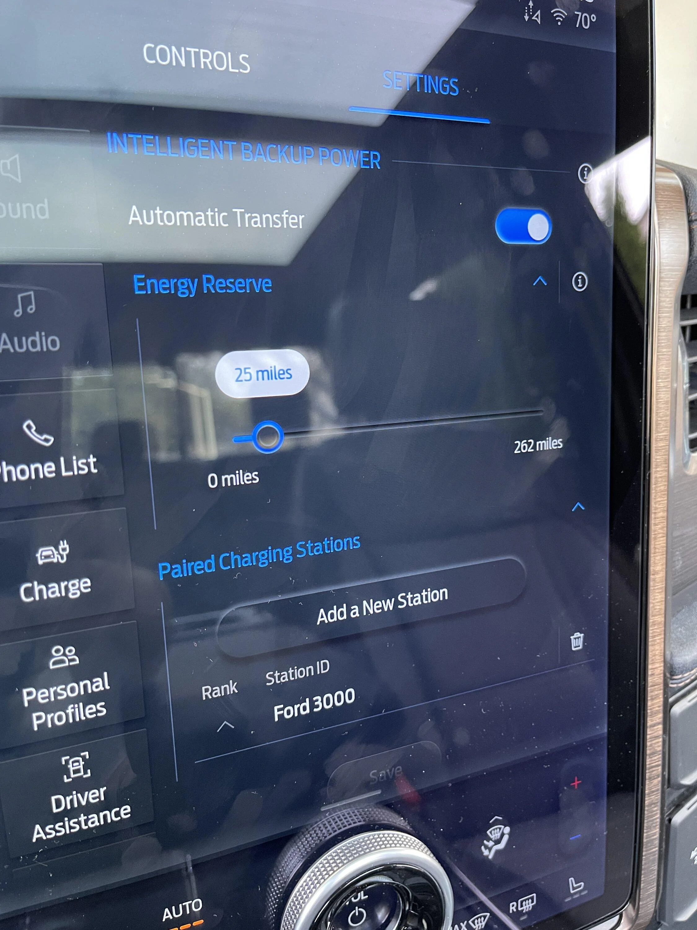

Let me know what you learn. I am in a similar situation - Check marks 1 & 3 are complete, but check mark 2 is not. However, as a test, I connected the charging cable and killed power to the house. The automatic transfer did occur (it took about 10 seconds) and the truck powered my home flawlessly. I ran my entire home for a few hours and then restored power to the house and the system returned to normal operation. My only concern: I never received a notice on my app that I was running on back-up power.

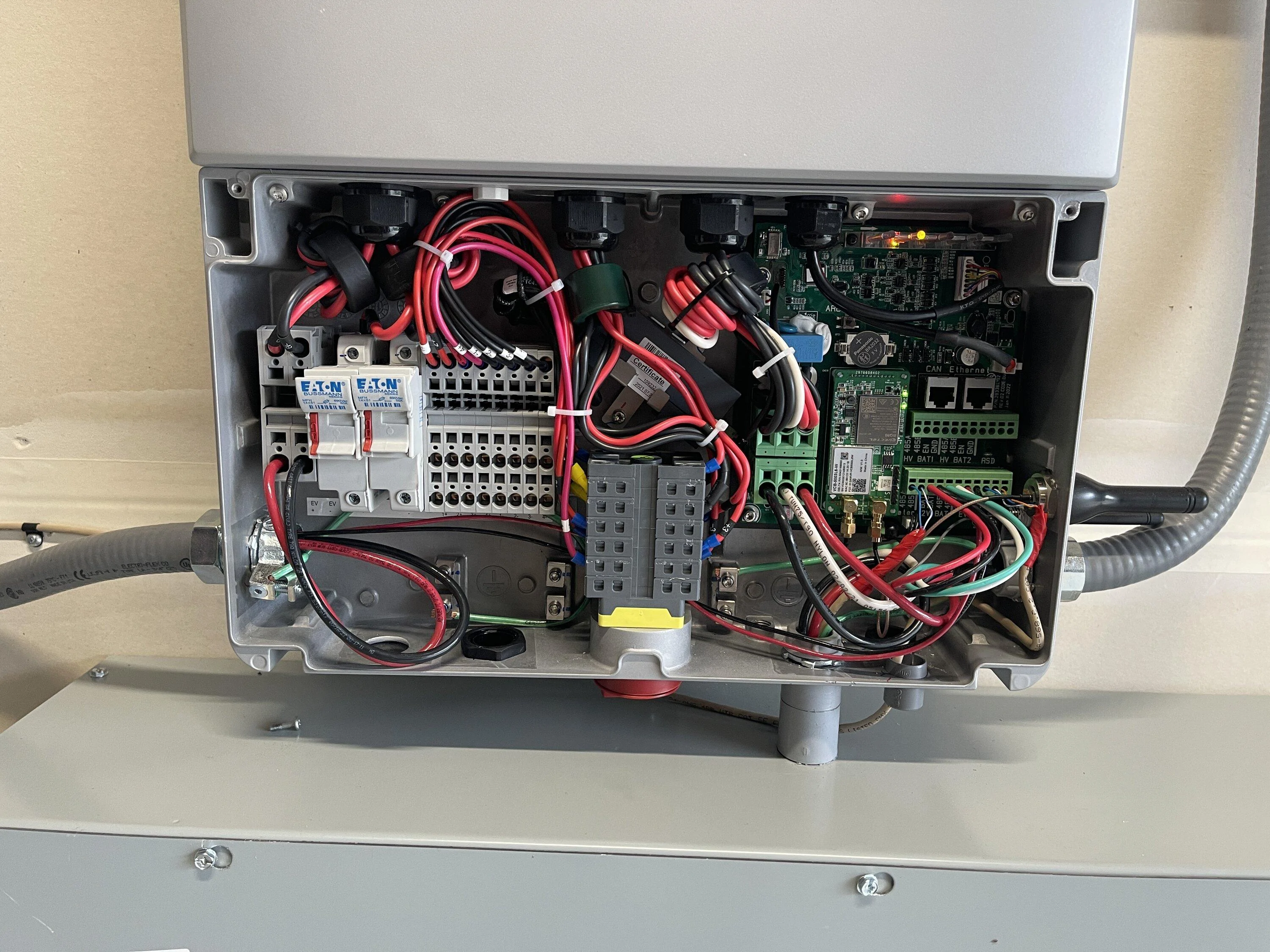

Update… it’s alive! I still do not have the Fordpass app updated due to a process issue for us non SRM states (their term). It kicks over to truck power automatically after about 30 seconds… and then when power comes back on, it flips back like it should. My issue was that the CT clamps were originally placed on the sub panel and not the main as intended which was causing the BDI and MIDI to not behave exactly right. It makes sense that it might get itself into a loop if the ct clamps started to show power again… anyways… a video for those interested. I included not all of the waiting but there is a lot of clicking that you can hear that happens in the truck as it prepares to backup.

@idahospud You ever get the app to pass the check. I have been talking with Ford tech support for a week plus and trying to find out if anyone outside of SunRun has this work yet? If so, it would be helpful to know how… let me know. It’s probably the same reason it’s not giving messages.
The last time I checked, no middle "checkmark" yet. I notice the HIS is attempting to download an upgrade through M professional but the upgrade never finishes. I think that is the culprit in my case.
