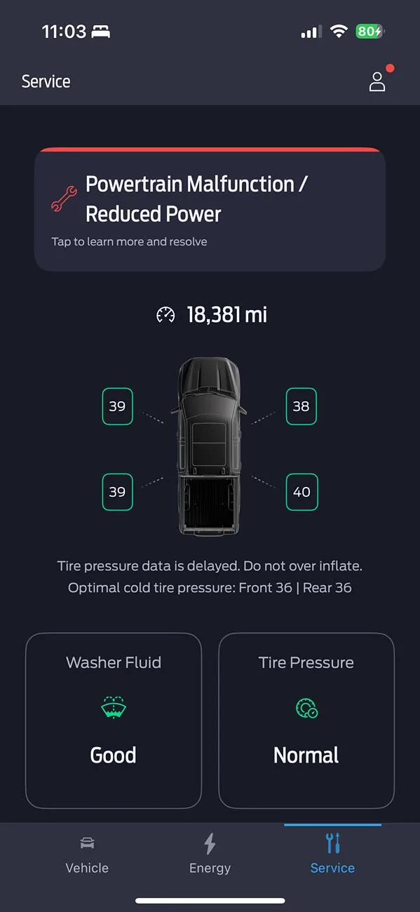

Well, my truck is a 2023 Lightning SR, with 18,440 miles. Yesterday took a trip to Disneyland, and hooked up to one of the type 2 chargers offered for the EV drivers. It charged to 80% without issue. I then decided to charge it up to 90%. Again no issue. Once charged, I got a charging error on my app. I figured, no biggie.
Then in the evening we jumped back into our truck, turned it on, and BOOM! POWERTRAIN MALFUNCTION/REDUCED POWER message appeared.
luckily was able to get my truck back home, driving at a reduced power of 53%.
Plugged in at home, and the rings around the lock button glowed with a solid red. Would not charge.
This morning I brought it into the service department, and they said they would not be able to take a look until Wednesday (48 hours from now).
I was hopeful for a quick fix. But have recently taken a deep dive into Google research, and the findings have been truly disturbing.
I have a bad feeling that I will be without my truck for a good duration of the next few months.

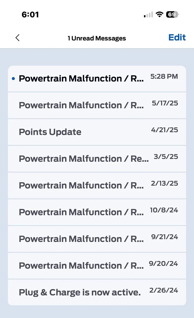

Wow, happened to me seven times.
In the end the truck is one big circuit.
Although some components faults or breakdowns are more serious than others.
Can’t determine until they hook it to computer and check for errors on thousand’s of lines by line.
2021-2022 good truck,
2023 cut few corners.
2024-2025 guess cut more than they should….big recall!

Well, just heard back from Ford this morning. The issue ended up being my EV battery has failed. The good news, they are replacing it with a new battery, and it’s all completely covered under warranty (thankfully). So on a positive note, I will once again own an EV with a 100 SOH, as far as the battery is concerned. And it should be completed within a week.
on the negative side. This is concerning. I have followed all of the recommended practices (avoid superchargers when possible, maintain a charge of between 20% to 80% - which in reality I was keeping the vehicle between 70% & 80% daily, and leaving it on the charger when not in use).
But, knowing I have another one, that hasn’t seen issues yet, I will chalk it up as a fluke incident.
But as far as the service side of things, I am very satisfied Ford took the initiative to not make this situation a complete headache. They identified, acknowledged, and were happy to repair on their own dime. It’s hard to be negative over that type of service.

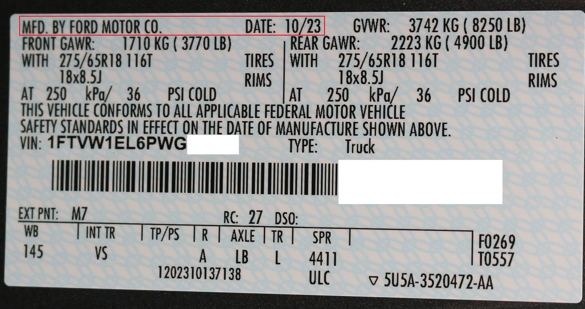

It could be a one-off battery manufacturing defect and the other XLT hopefully will not have the problem.
You might check and compare the dates on the driver's side door plates of the two trucks to see if the were manufactured around the same time.
There is a build date on them like this on mine:
Ford F-150 Lightning Powertrain Malfunction/Reduced Power, and will not charge IMG_5731-mfg-2023-10-edit out vin
I blanked out part of my VIN in the pic.
Sometimes the defects could affect more than one vehicle, like the misalignment of electrodes in a particular production run on the battery manufacturer that prompted a safety recall on 'potentially' 950 Lightnings (pdf attached).
Ford seems to know which vehicles by VIN number - we hope - and notified those owners.
Good luck!
