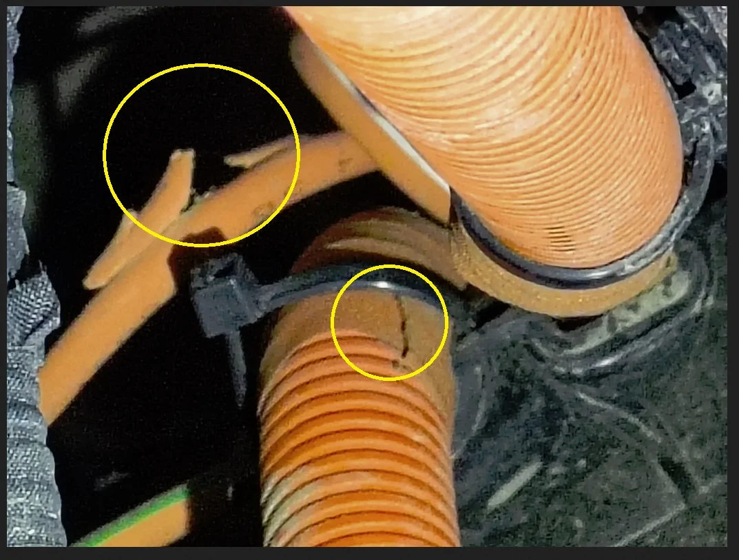

There have been some instances of the wires getting damaged by parts of the frame - behind the clove box, and this place under the bed in the other post mentioned, the cover on the wiring was clearly cut by something under the bed in a couple places:
Ford F-150 Lightning PPOB "Unavailable"! pic 05
Glad they have the parts.
Wiring, including connectors, needs to be better protected than some of the things we've seen in posts on the forum.
Not much we can do about hidden wiring under the bed though.
I did add some electrical tape to the wire bundle behind the glove box as was mentioned in a post:
https://www.f150lightningforum.com/...hile-driving-pending-fix-48.33583/post-631084
