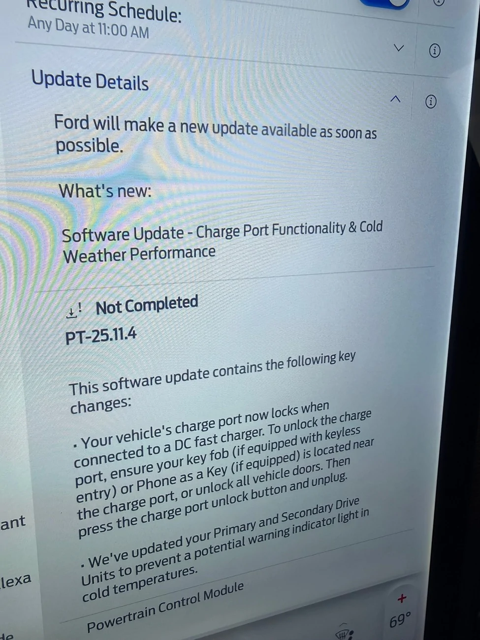

PT-25.11.4 Charge Port Functionality & Cold Weather Performance
jamelski
Aug 11, 2024
311
480
Sacramento
2024 Lariat
12v battery could still be weak and unable to maintain enough charge, all too common in the Lightnings due to their 12v BMS methodology.
Might (probably is) time for a new battery (warranty claim).
Maybe , possibly , doubt it , my battery’s not even one years old and I ABC🤷🏻‍♂️
Kakaratto
Nate
Dec 4, 2024
67
76
2024 Ford F-150 Lightning Flash
My truck is also offering this update and it is repeatedly failing due to low battery. I’ve tried trickle charging the 12V battery and regular charging the HV battery to no avail.
One possible solution I did read on the Mach-e forums is that people were setting their level 2 chargers to 8A and then slow charging over night. That apparently will keep the 12V battery at full. Their updates completed successfully. I haven’t had the chance to try this yet.

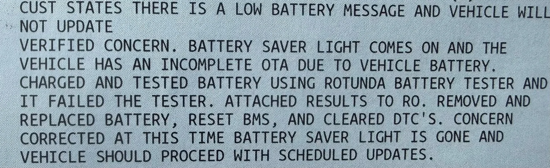

It’s absurd that a truck purchased in August 2024 needs replacing a LVB. Hopefully the update goes through later. I’ll drive for a little bit and charge the truck.
As I suspected.
Yes, it is pathetic this happens.
My solution was to get a maintainer with an AGM mode and use it daily as insurance against trouble - so far so good into my 2nd year of ownership with fingers crossed!

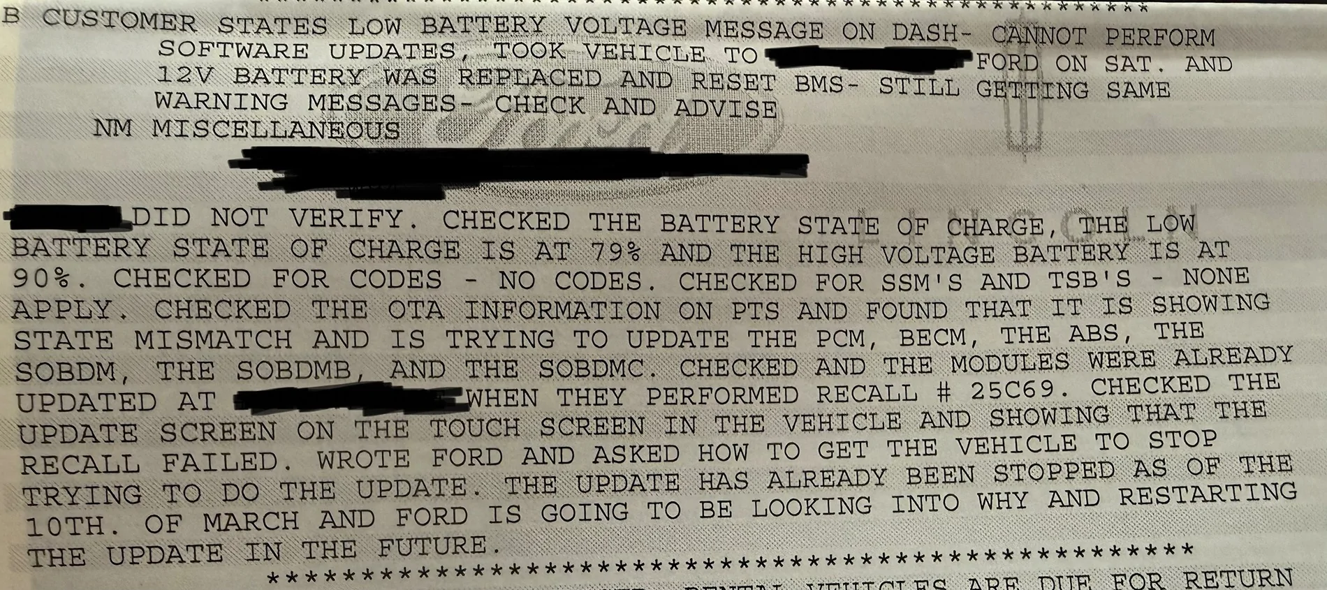

Well, back to the dealer today was on a maintainer all weekend and still won’t update. Something else is wrong beside the battery. So dumb.

So it was at dealer for a few days and dealer talked with ford engineers and this OTA is trying to update what the park prawl recall already updated 🫪. Makes no sense but whatever it will supposedly be looked at and OTA re sent 🤷🏻‍♂️😂
