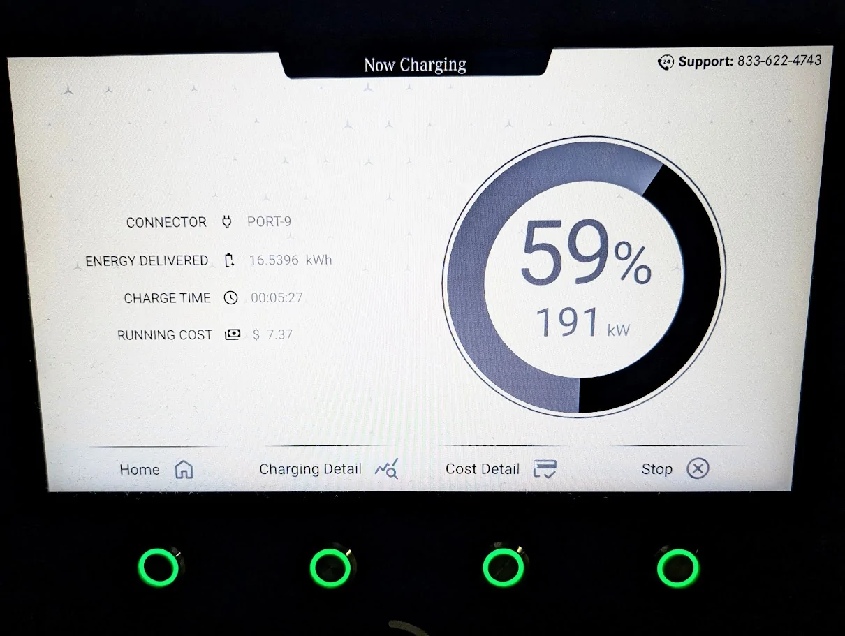

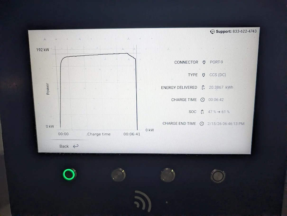

My recommendation to anyone who have issues with low SOC LVB: charge your tuck from L1 charger time to time. If you have opportunity to leave your truck on L1 charger for 1-2-3 days - make it. Quite often L2 charging time just not enough to charge LVB to high SOC.
I have original 12v battery, more than 3 years old, never reset, never charged by any 3rd party charger and never had issues except once but I know why it was totally my fault and solved by leaving truck ON for 8 hours.
Regarding the update: installation was about 15 mins, truck did bunch of noises and clicks, pump running near rear motor/inverter, but it unlocked the 500-amp charging curve finally! That day, I observed a peak charging power of 192 kW.
