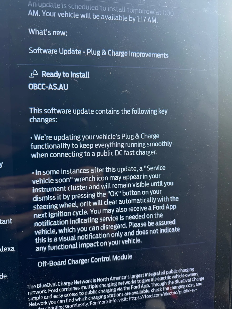

So it was at dealer for a few days and dealer talked with ford engineers and this OTA is trying to update what the park prawl recall already updated 🫪. Makes no sense but whatever it will supposedly be looked at and OTA re sent 🤷🏻‍♂️😂
It’s now makes sense with ford saying the OTA updates modules that were updated with the prawl recall since this OTA just failed and failed and never installed since it was already installed when they did the recall and ford software /OTA just suck and must not talk to each other 🤦‍♂️
so ford pushed a new OTA OBCC
https://www.f150lightningforum.com/forum/threads/obcc-as-au-ota.35648/
